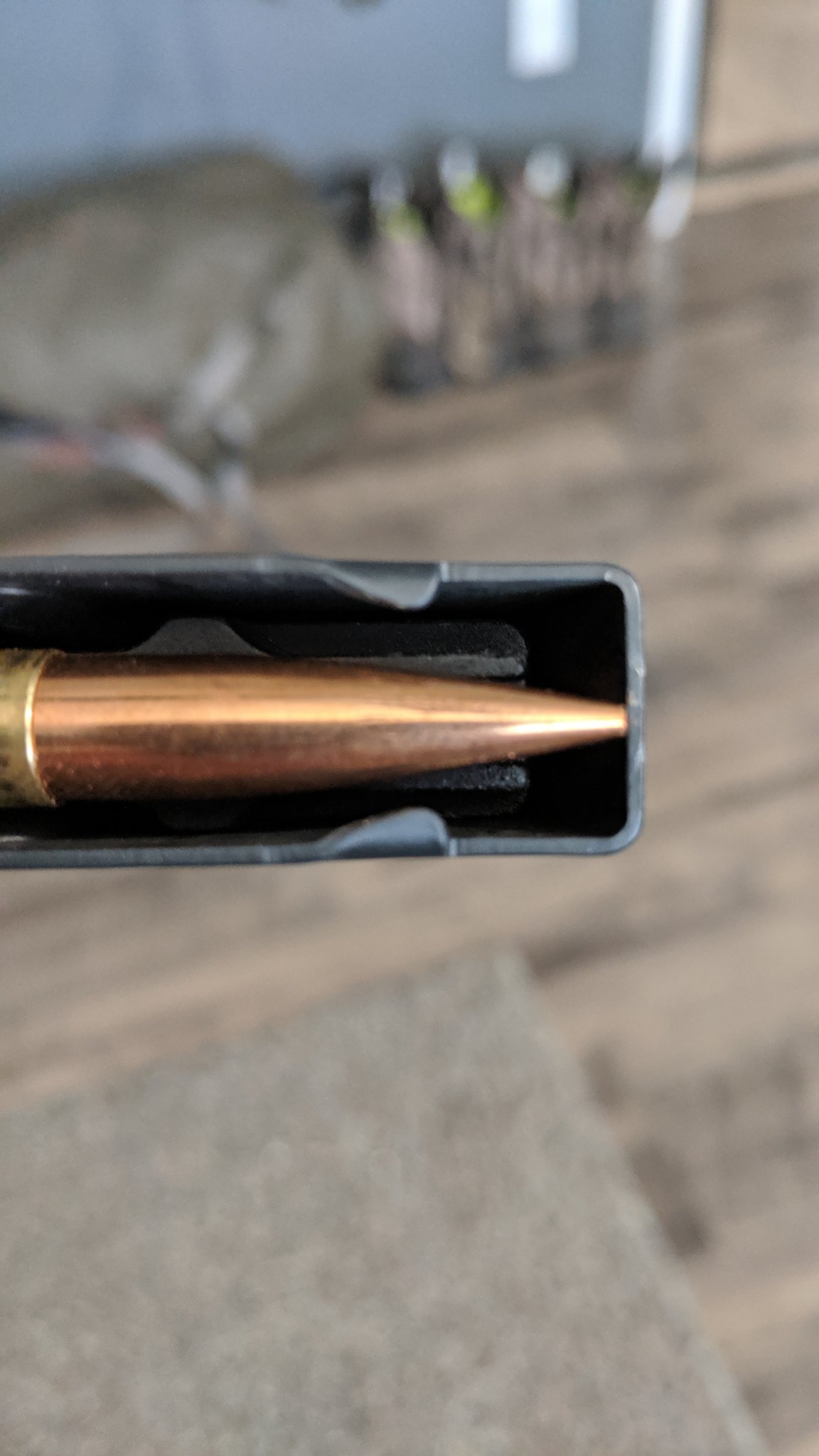

    They say they measure 3.770 but I've found thatvalot of mags actually measure longer does anyone have one or know if thats the true length looking for 3.787
    Just quickly measured some. 3.770 is about right. I was 3.769 on one. 3.767 another. 3.770 another. Didn't have much time so that is rough. But close.
    Accurate-mag was 3.775 roughly. didn't take the follower out or anything so could be off a few thou. Same with the MDT 3.775 ish
    I think 3.770 is about it. Even then the slightest tilt in the round binds it. Here is a 3.770 COAL in a MDT mag. Just fits. And it doesn't fit in the AI mag. So my original measurements were a little long.
