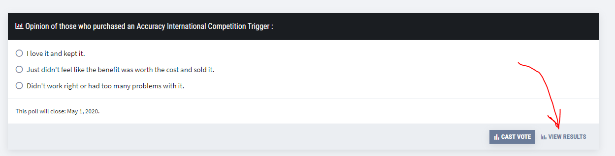

I wish we could see the results without voting for those of us on the fence about buying one.

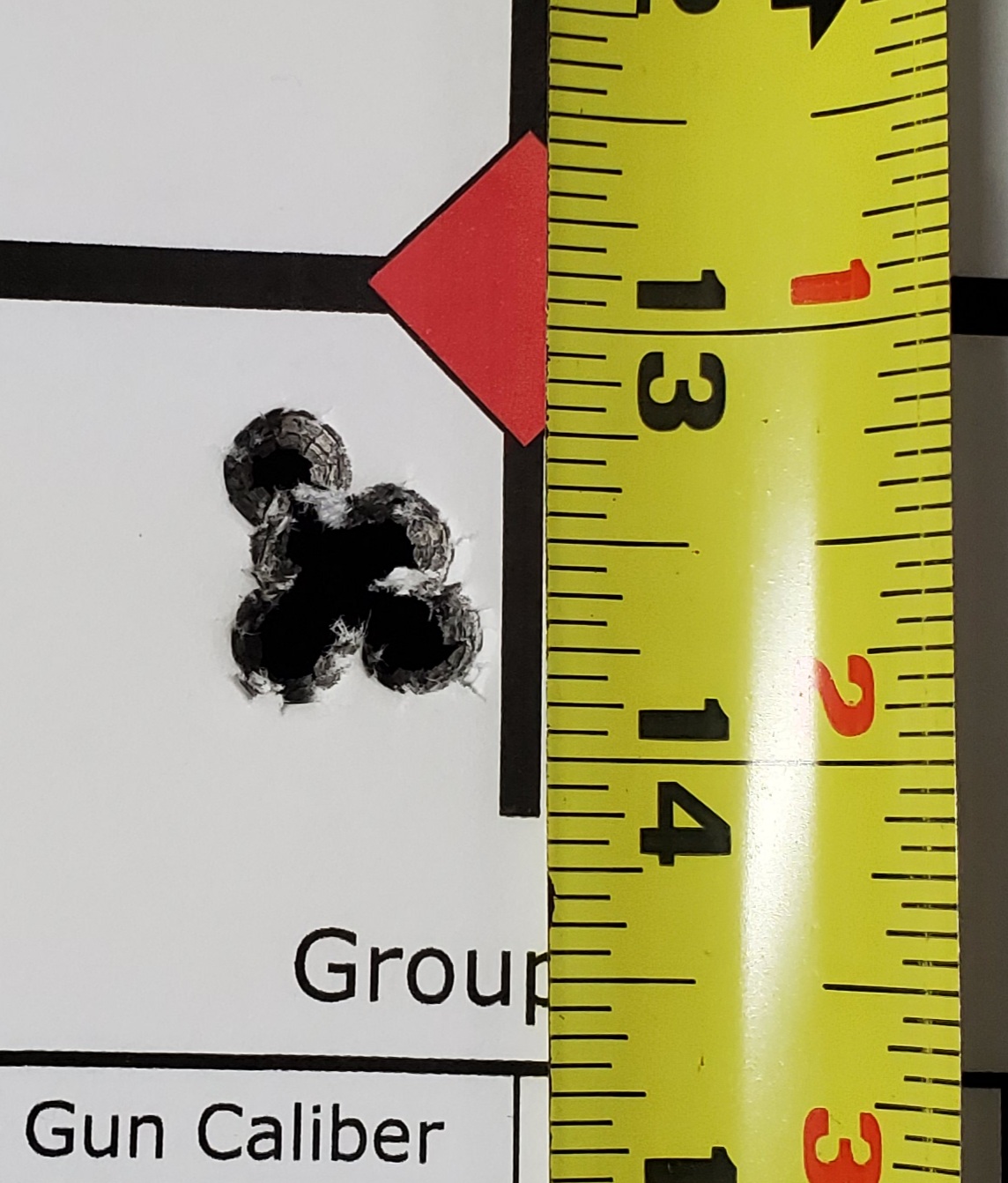

I have one installed on an AX I bought in the fall. The factory trigger appeared to have been messed with and didn't feel like a 2 stage. I was able to buy the comp trigger locally and installed it as is without adjusting. Shot it a bit, added the thumbshelf no issues. This week, I picked up an AT in 308, shot it yesterday and got the group below with factory ammo. The trigger is heavy 2 stage but was amazed. I followed up with the AX right after and thought the pull was too light .... now I'm all sorts of confused?!?
