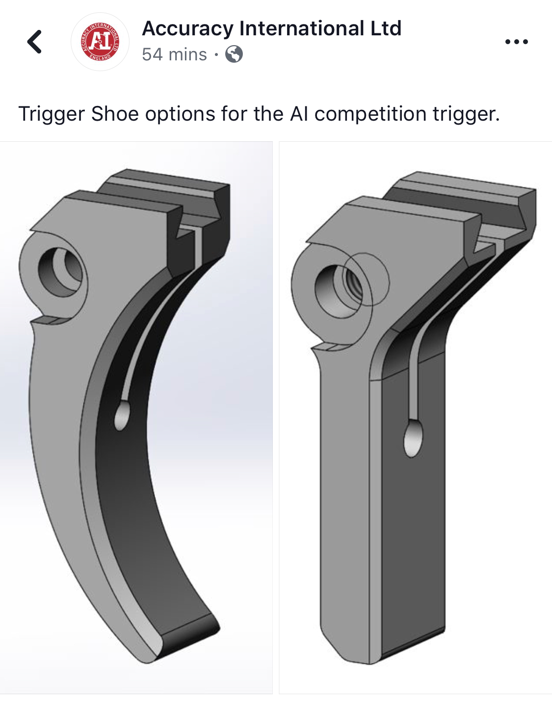

    @Mile High Shooting do we need to specify flat shoe on the pre-order?
    They commented on facebook that the current AT/AX trigger shoe will work on the new trigger, so for cost purposes I would rather order the new one with a flat shoe just to try it out. If I don't like it I can swap my current shoe onto the comp trigger. That's a better option than having to spend another $50 to try the flat shoe.
    Reactions: Timo Turl
    @samb300 to be honest I'm fine with my current AI triggers if I could just purchase the flat shoe I would be happy.
    Worst case ill just buy one for the comp rifle just want to make sure I get the flat shoe.
    @Mile High Shooting
    Looking to buy an AT fro y’all this December. Can a flat trigger shoe be put on the current AI trigger or does the flat shoe only work with the new competition trigger?
    Thanks!
    Pretty huge for the AI crowd. The triggers were one of the things lacking in those rifles IMO. Excited to hear how these work for you guys.
    @Mile High Shooting
    Thanks!
    If the current shoe can fit on the new trigger, I see no reason why the flat shoe wouldn’t fit on the legacy trigger. You still may end up having to pay $50 for the flat shoe, but it’s a small percentage of the $4k+ for a new AT so I wouldn’t sweat it haha
    Plus, the factory curved/grooved trigger shoe is really nice, you might end up liking it!

    Lads,
    Does anyone have the part number for the FLAT trigger shoe alone?
    I'm going to replace the current curved one on my AT.
    Have looked on MHSA, Team AI & AI Intl Facebook pages... Haven't found anything specific.
    Thanks
    Its only pre-order right now, may not have one, but if you get one, let us know if its a direct replacement. I’d be interested in a flat shoe for a soon to be AIAT.
    Lads,
    Thanks
    Mile High and EuroOptic have the AW/AWM comp trigger shoe listed as part #22-085, with a price of $47.00. Nothing on the flat shoe replacement, though. The comp trigger itself if part #C-XTSP0001

    For those that have the AW - looks like you may need to buy the optional trigger shoe ($47) as well. I'm ok with that. I asked if that means you will be limited to a straight trigger with the AW but they are not sure. Need to get some in to evaluate. This is really a nice move by AI, I know they are purpose made rifles and all but having an option for another trigger is sure nice
