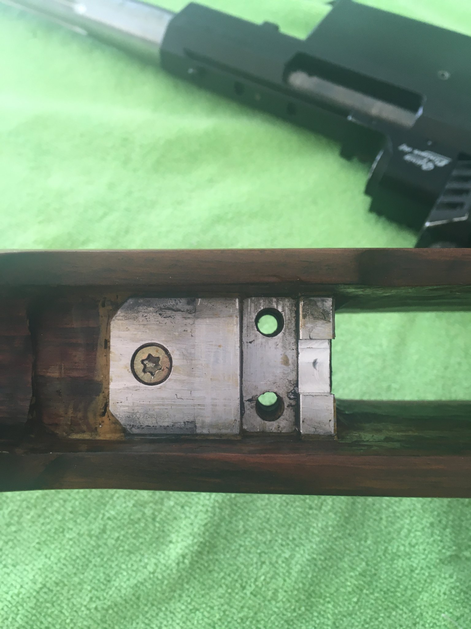

stocks are easy here. Four pillars and any damn stock you want that is wide enough. It’s just a chuck of solid flat steel with a tiny integral recoil lug. Any stock makers can fit this action. Trigger guard may take some work but the shoe is changeable. The factory stock just has a square piece of aluminum the action sits on.

I would shoot this prone and it's a very good information that the plate under the receiver is as simple, I'll have to take it apart at the gunstore to confirm it's like that...it simplifies the potential new stock choice :)

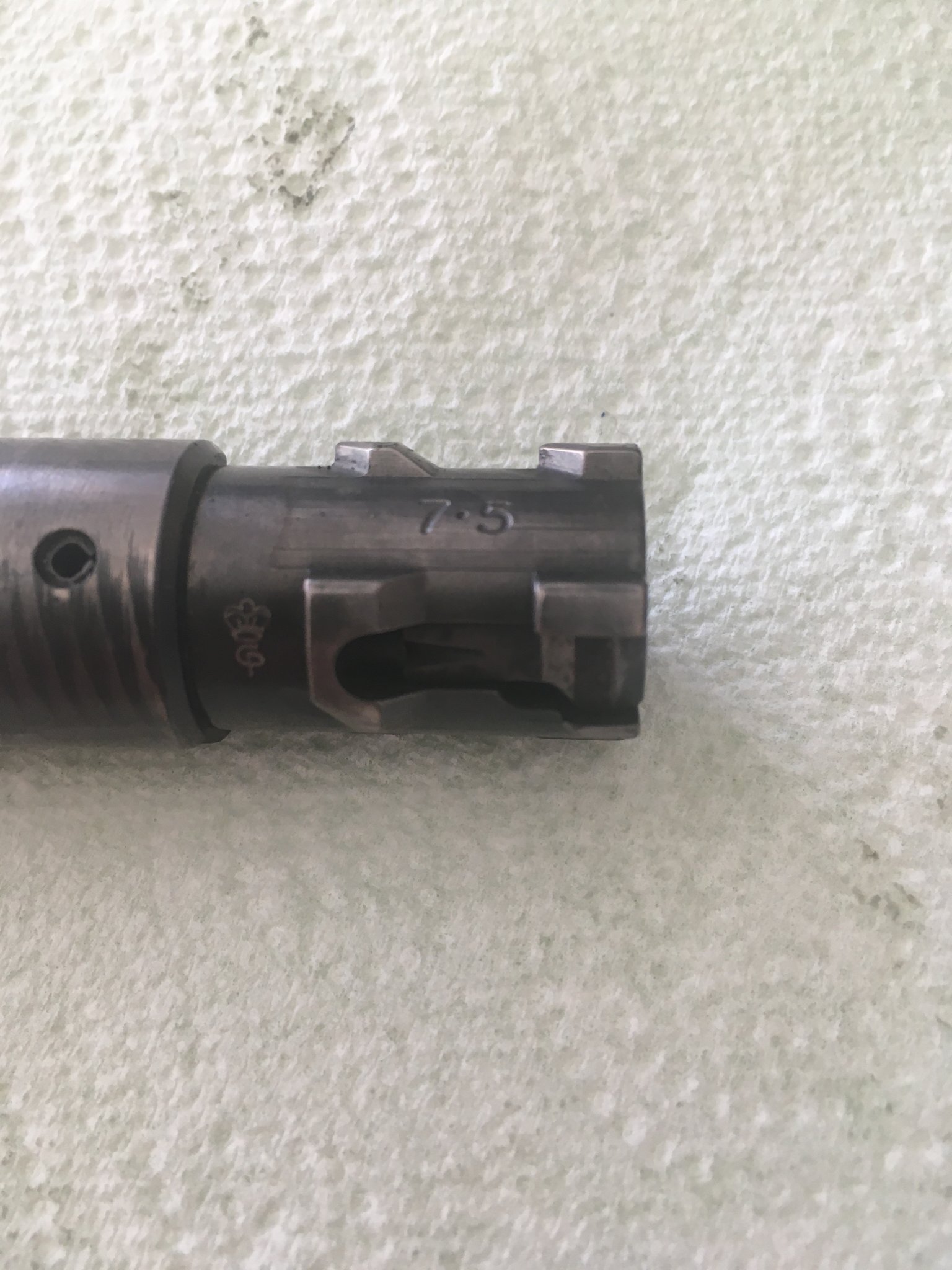

As expected it's:
  • A flat-bottom action held in place by 4 screws
  • 6 lug bolt, marked 7.5 because it's a 7.5 Swiss rifle. It's just a tiny bit larger than a 308 case

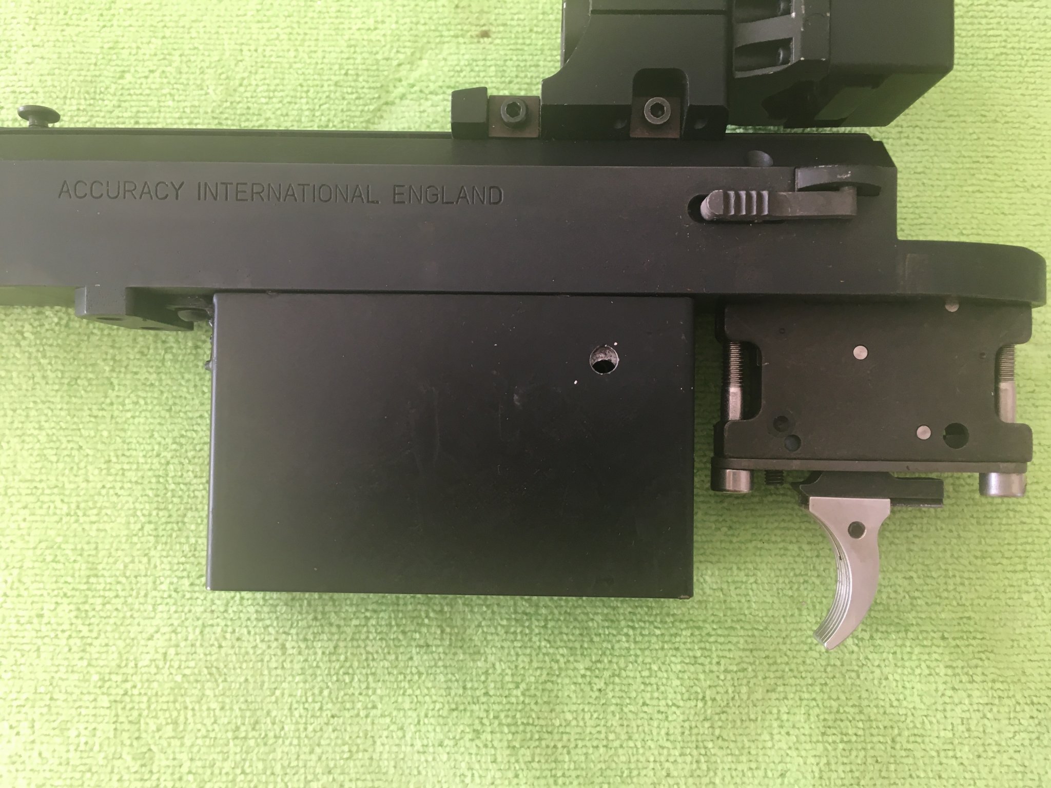

  • Adjustable trigger down to around 2kg as far as I can tell

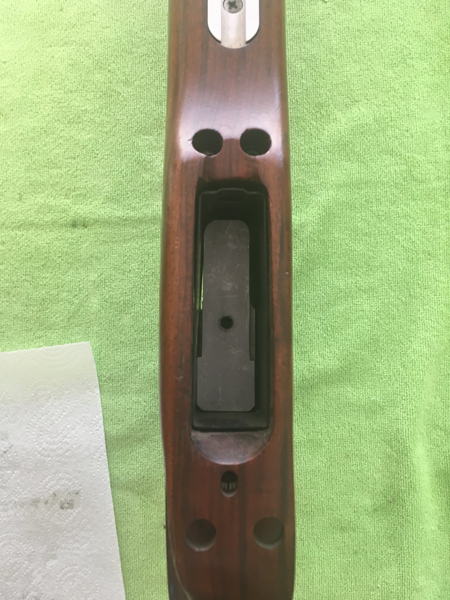

  • Stock stock with an aluminium bedding surface

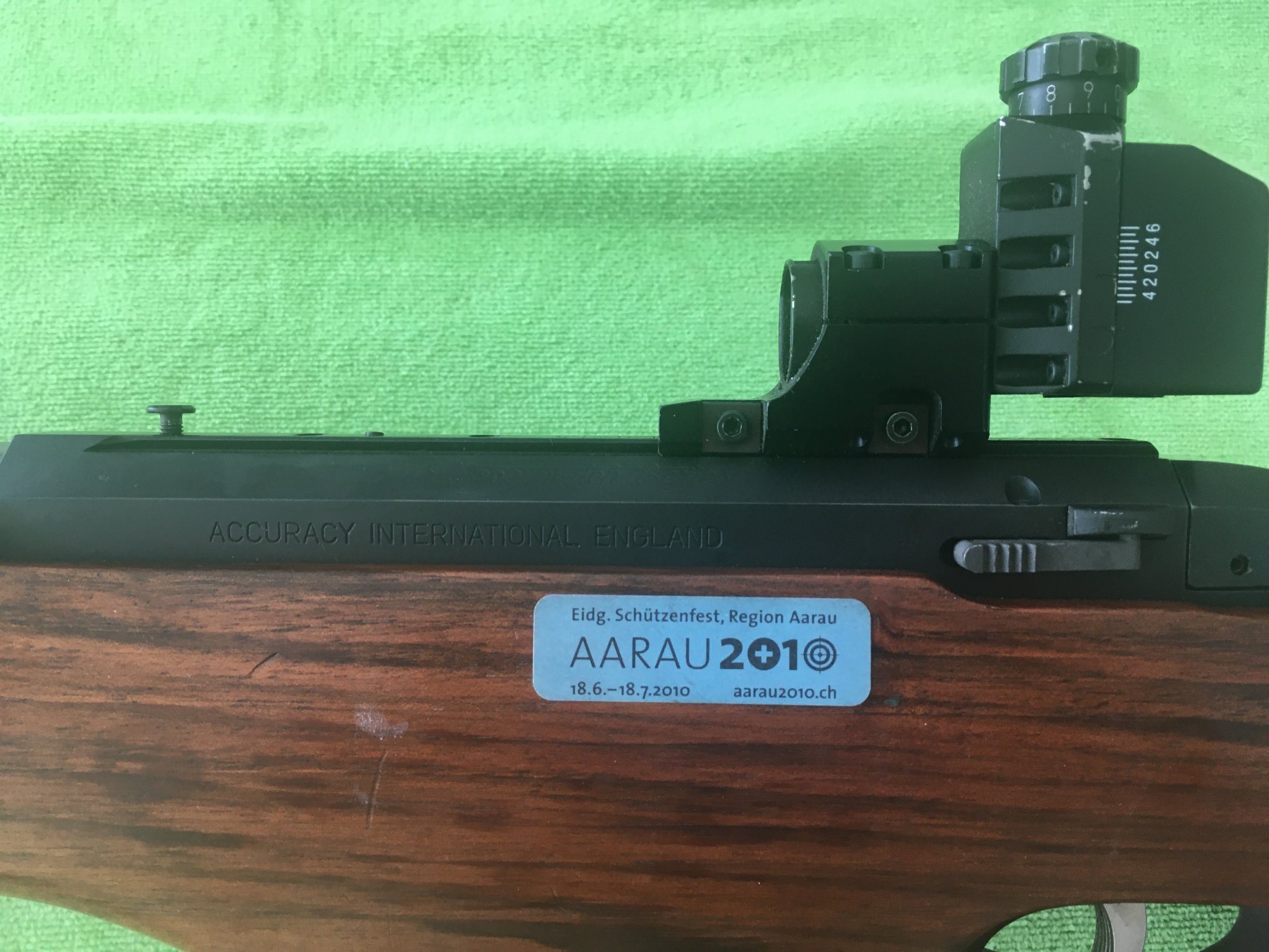

  • Some old diopter sights mounted, but no iris
  • The rifle has some "Aarau 2010" stickers which means it went to the Swiss national shooting challenge that year, which was in Aarau
  • The rifle actually has a 5-round magazine (not shown) but it currently has a 1-shot plate

  • The receiver is marked Accuracy International England - Coopermatch Series -96 AT - *Serial number*

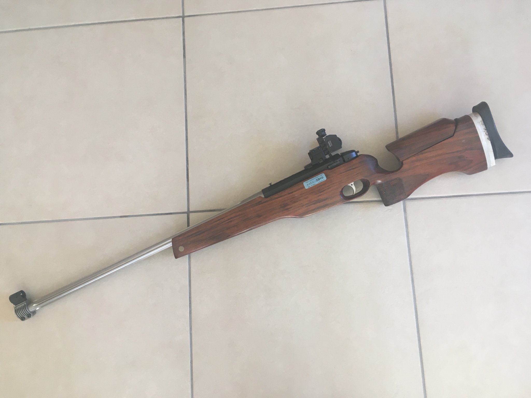

Yeah, at this point I still have no idea what to do with it but it looks at me and tells me to adopt it.
I have only seen one repeater, ever, and it was also in that walnut stock. The single shots are laminate pine. I would chose whatever large rifle primer caliber you like and re-barrel it, find a magazine and shoot the shit out of it as is. That is a beautiful rifle and I haven’t looked at the exchange rate between S.Franks and USD but for $500 I’d be tickled shitless. You could slap the smile off my face.

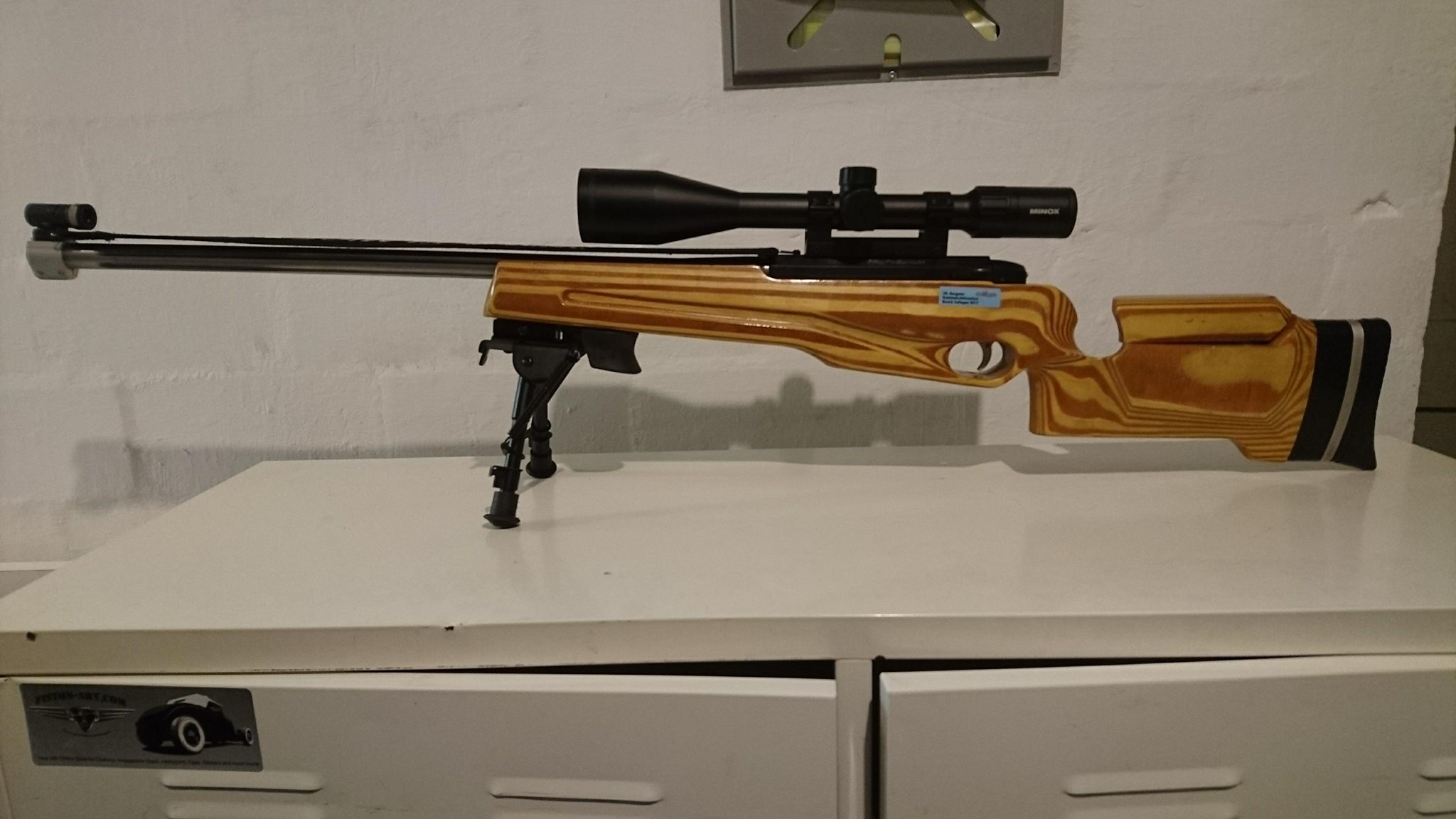

I have one of those as well, since I took this picture, I have removed the sight tunnel.
Just like yours, this riflle is chambered in 7.5 Swiss, so you can buy government subsidized GP11 ammo in every 300m shooting range, making this a very budget friendly shooter.
The scope mount is a HOP40C from sports match uk. I think they offer a very good value at ~130€. The scope is a Minox ZX5i 5-25x56 SF. That was the best 5-25x scope that fit my budget at that time. As there is a UIT-rail on the underside, you can mount a bipod by using a harris no. 6 or UIT to picytinny adapter.

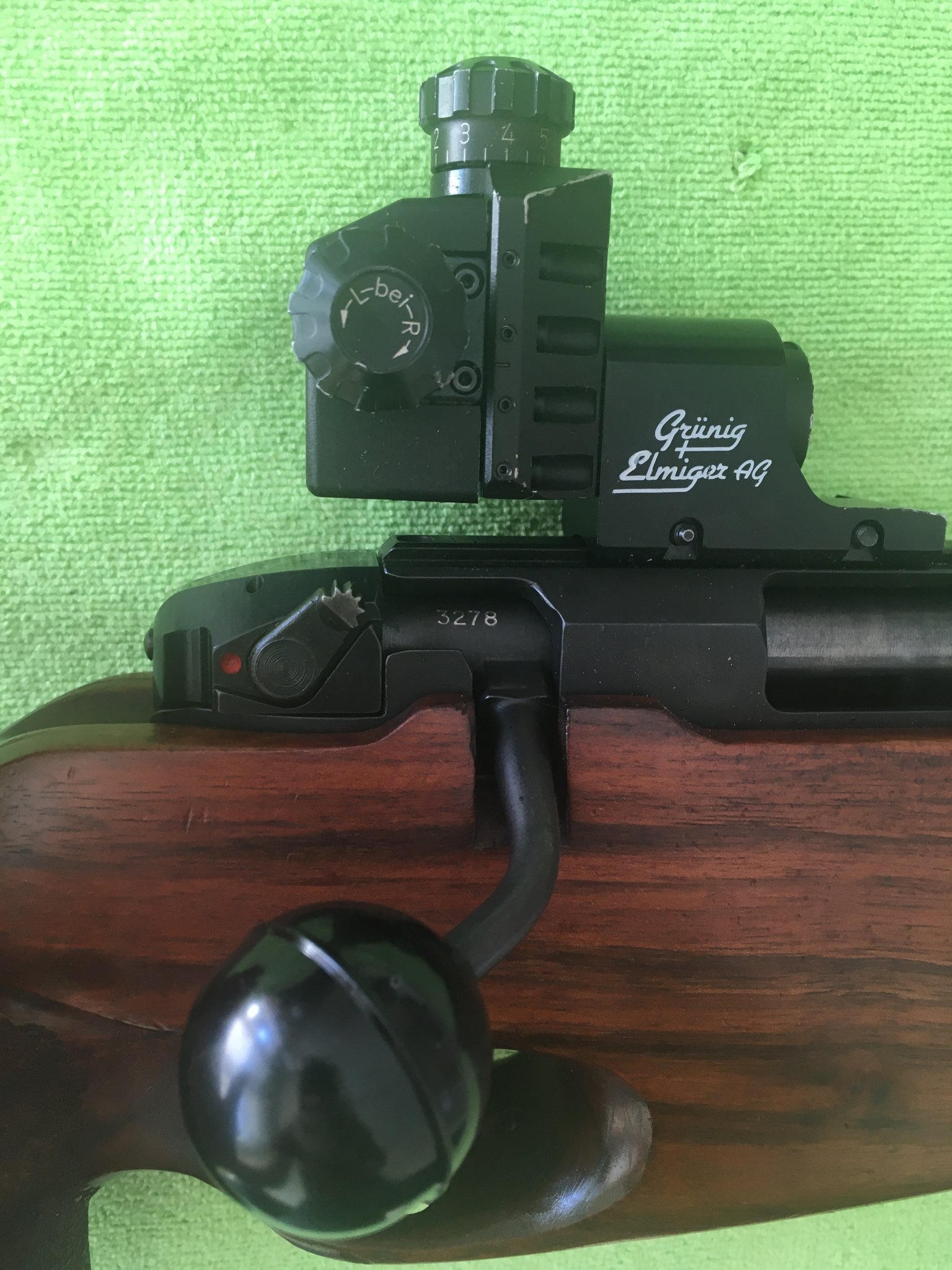

@FatBoy - you have a Grunig & Elmiger? Thoughts on it?
Those and Bleikers are so sweet. Any chance you got pics?
Obviously gotta be a super baller to afford stuff like that. $$$
I don’t . I Have had plenty of opportunities to play with them, and for the kind of shooting I do (LR and MR highpower) there’s not a lot of advantage that I can see. For 300M shooting where every 1/8” matters, the extra cost may be worth it. That 300m target is tough…
