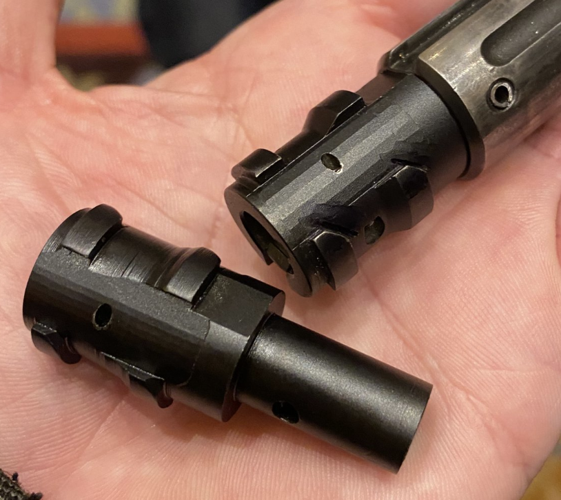

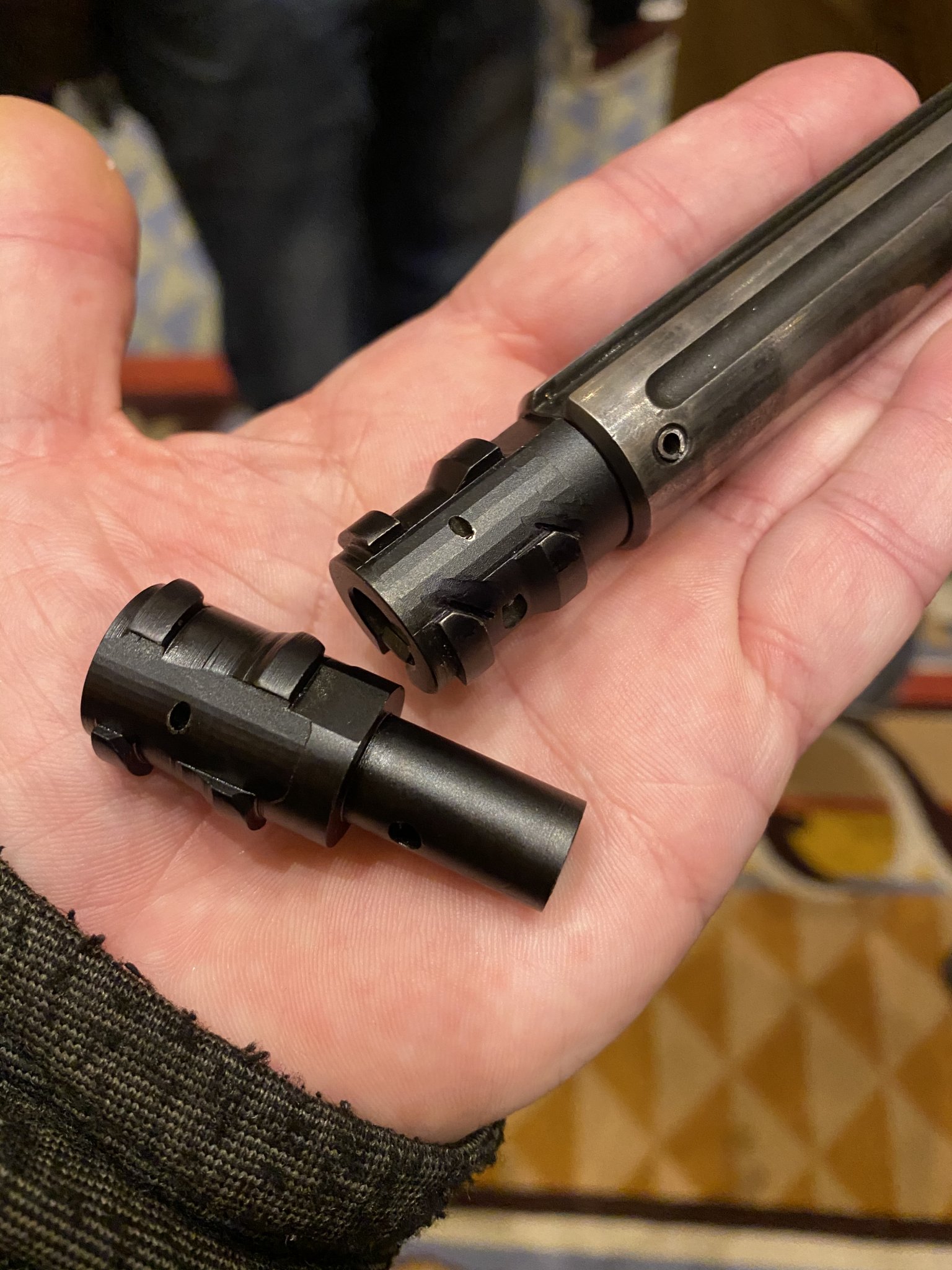

So wait a second, the AI bolt head is replaceable based on this image? The question then becomes does AI sell the bolt head separately and are the MC and SA bolt heads the same size? I'm assuming the MC bolt head is larger to handle 338 Lapua size (.590 face) cartridges, but does anyone know for certain?
No the AI are not replacable from AI
AI will not sell the bolt head seperatley
and the MC & SA are not the same size, larger tenon, lugs further apart, differnt extractors
yes i know for certain, I've measured all of them extensivly
those 2 bolts head were done by us, that is Lowlights hand at SHOT Show
