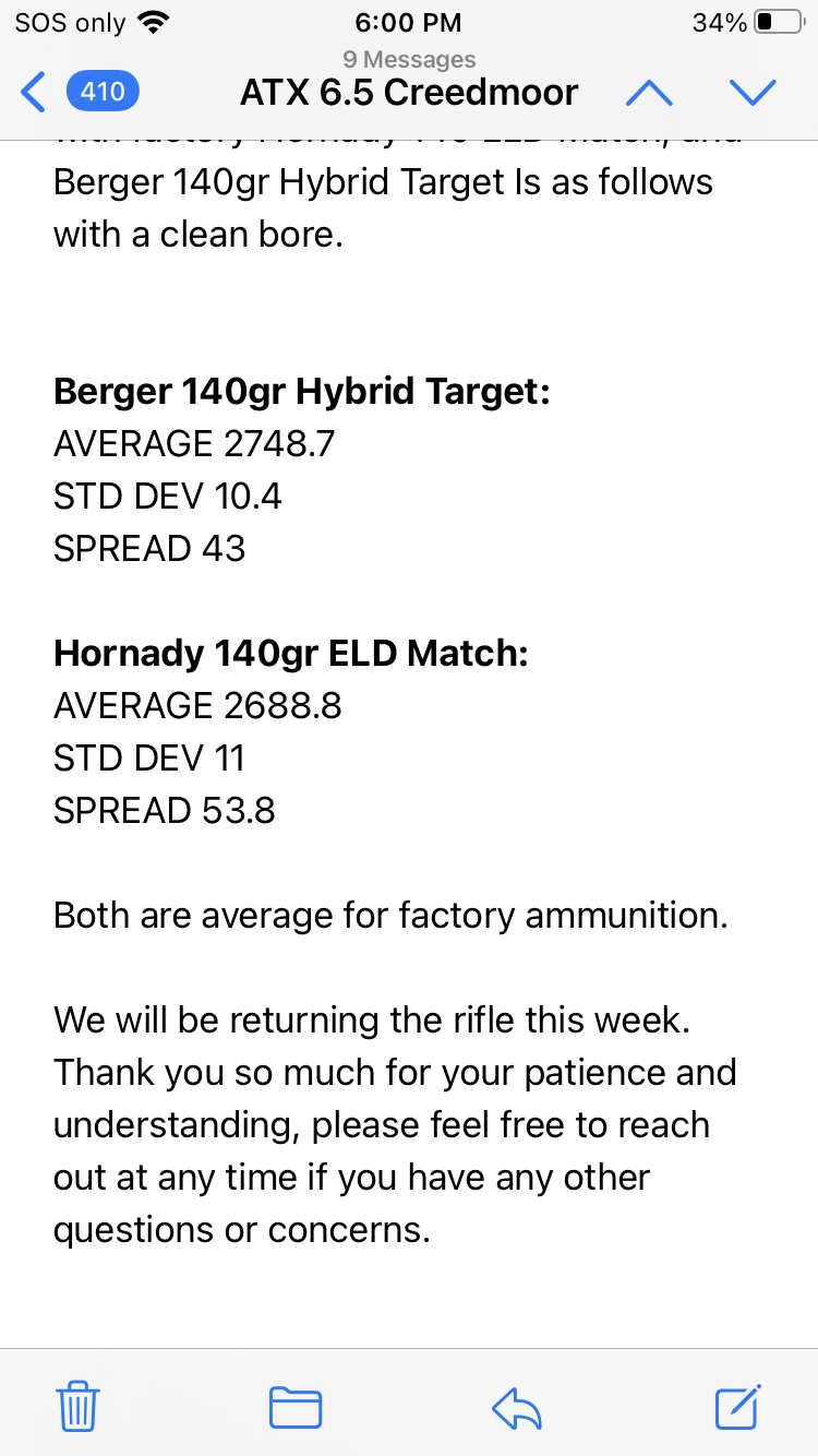

i was having problem with my rifle and sent it back to the factory . they received it November 21st 2023. I sent emails they finally wrote back
and said they were testing my rifle the week of December 11th . I never hear anything and never received any return emails. Finally called them
and they said they fixed something on the stock but had no idea if it was tested yet. Again sent emails with no response has anyone else had
trouble with them? I 'm ready to ask for a refund and go buy a different brand of rifle . I'm sure the guys in England wouldn't be happy how there customers in the USA are being treated.

Same ammo has the SD of 8 out of my Christian arms MPR. Just got a relay from the company looks like the chronographs were garbage I’m getting a Garmin on Saturday

An SD of 8 or even 10 is not bad for factory ammo at all. Anything single digit is doing really well for factory ammo.

SD 10-11 is "normal range" for Berger Factory 140s, in just about any rifle
That'll hold ±1MOA of vertical at 1k yards.
The gun matters too though. My semi shoots that Berger at >25fps SD whereas a gunsmith custom has SD closer to what you state.

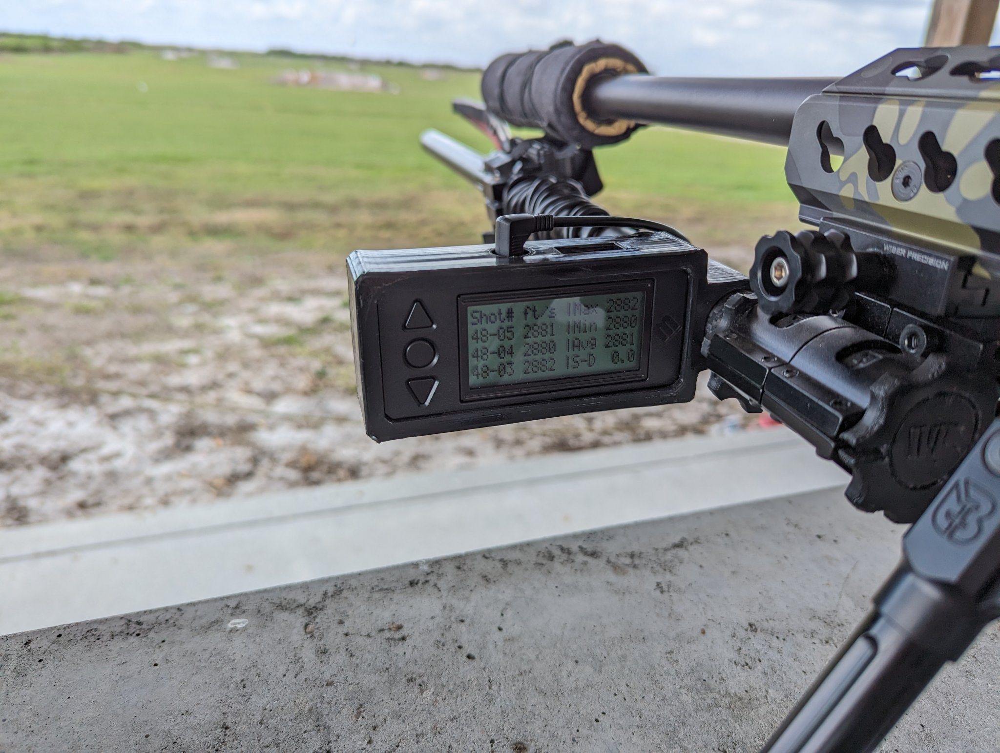

Novices... These guys can't even load 0.0 SD rounds.... This pic is clearly representative of everything I load up.
Now back to reality, anything single digit is good and will result in very low deviation at the distances we are likely shooting. And I'd be very happy with low double digit SD from factory ammo.
And OP, invest in a better chrono.

Yeah but is that STDEV.P or STDEV.S? Big difference!

Yes. This and the fact that we were between chronographs. I had given away a Lab Radar and had to wait on a new Garmin XERO to arrive. This took longer than we would like but we are always going to be thorough in checking a customer rifle. The velocities Tim provided are consistent for our test ammunition across a large sample of barrels. BTW, the cheek adjuster problem was something unrelated that Tim found while doing the acceptance inspection.
It's helpful to understand the realities of factory ammunition and the fact that they can't weigh charges as we do reloading. Below is a histogram of the charge weight variation in a lot of 6.5 Creedmoor ammunition loaded by a respected ammunition manufacturer for a Government end user. This ammo is supposed to be top shelf in performance and accuracy. The sample is 58 charges, so pretty high confidence level. Applying the +/-3SD rule you would expect to find 1.1 grains (yes, more than a full grain!) variation in the entire population. Interestingly, the histogram is asymmetric suggesting that at longer ranges you would expect to have a decent group center with two low shots for every high one (the flyers:)). I re-metered the charges to +/-0.02 grains (1/50th the original variation) and seated the original bullets in the cases. Fixing the charge variation made almost no difference in the velocity behavior of this ammo. In my next test I pulled sixty bullets and discarded the original propellant then recharged the cases with H4350, the classic 6.5CM load. The next round of tests with two barrels was dramatic with the ES falling to 20-22 fps and SDs of 6 and 7 respectively. The accuracy was also significantly improved.

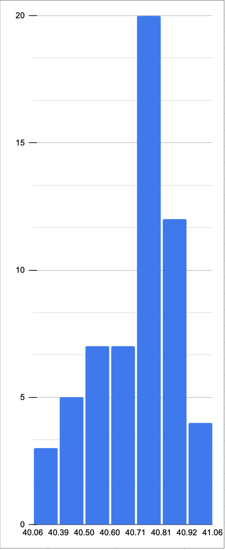

Charge variation histogram

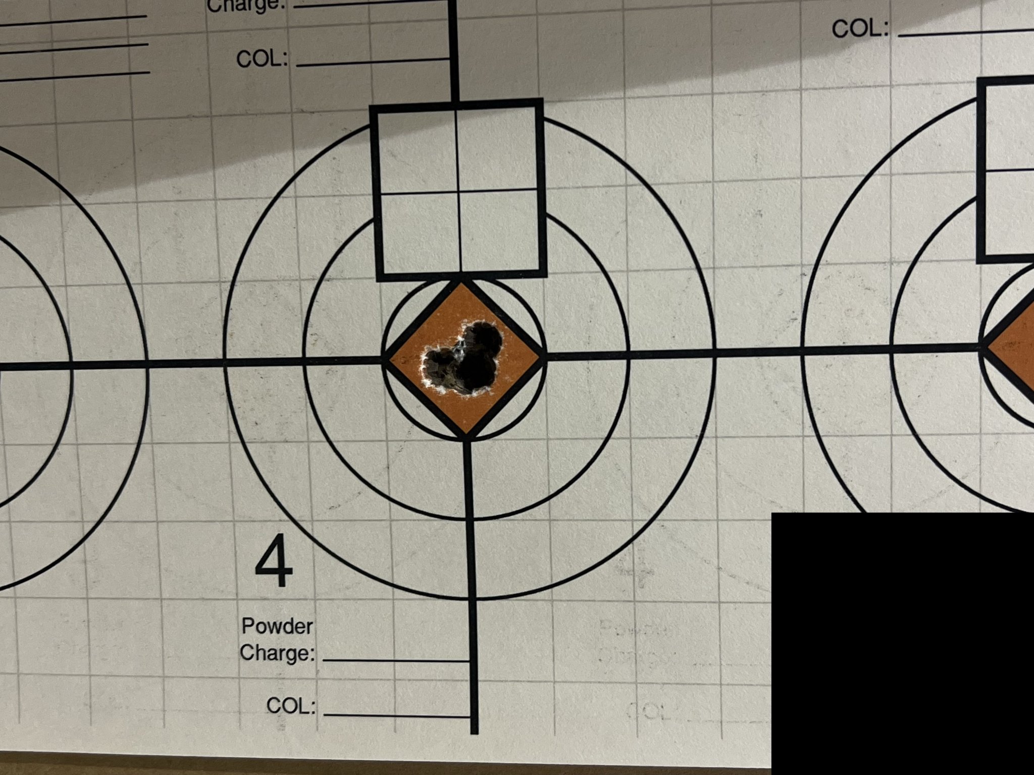

I will leave you a test group from the rechared 6.5CM. Original case, primer, and 140 HYB bullets. If you want the very best results you really do need to load your ammo and have some good tools.

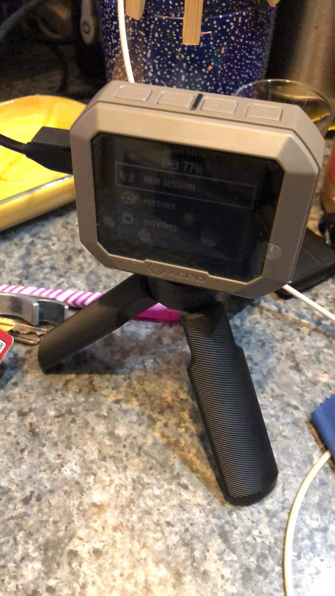

i have a Cobalt Kinetics SPR Elite in 6 arc i used the new Garmin XERO and put the speeds in my Kestrel and was hitting the 6" plate at 800
just about every time . so that tells me i'm getting good data

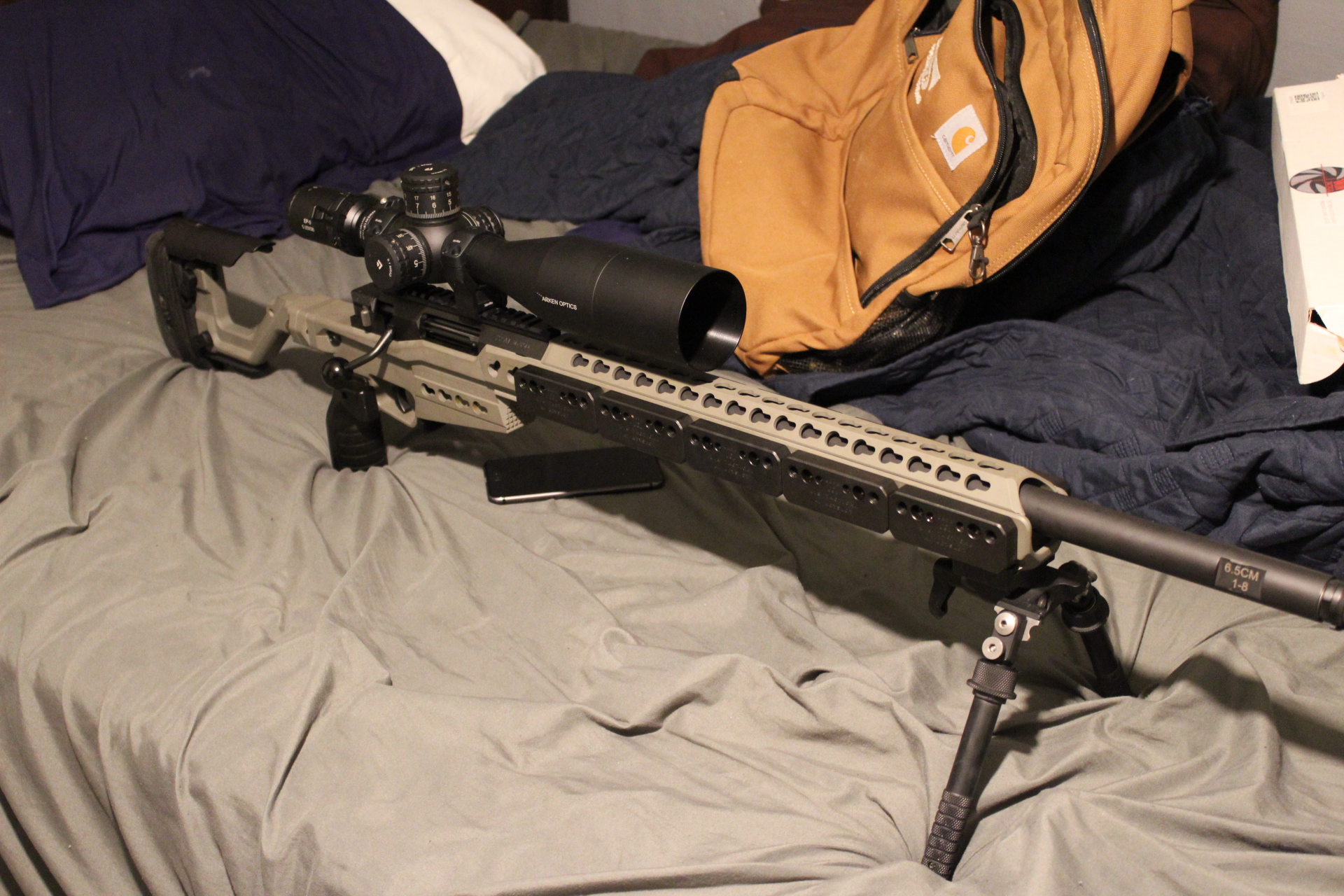

It came back I’m going to test it tomorrow I threw an Arken on there for testing I’m still trying to decide what to put on it

Ahahahah words mean things: "It came back I’m going to test it tomorrow I threw an Arken on there for testing I’m still trying to decide what to put on it. "
I took that to mean the arken was temporary and was suggesting a schmidt and bender, not sellier and bellot. As for ammo to send through it maybe try some
