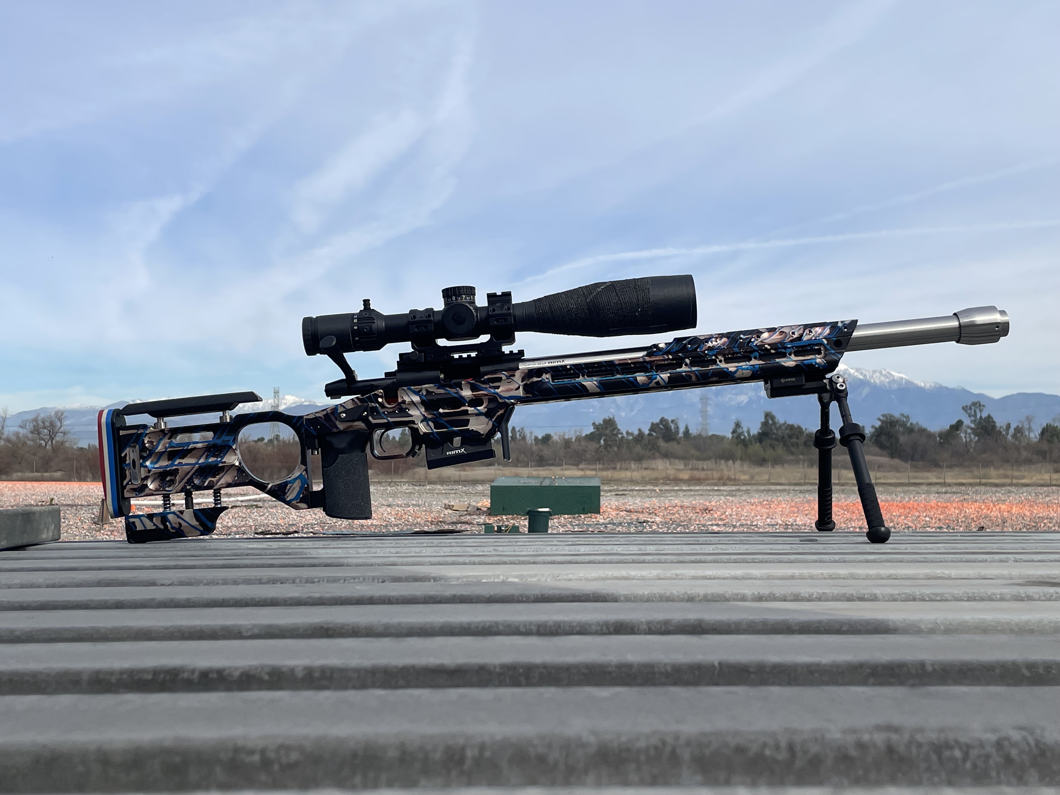

    Edit: I’ve got zero slop in the MP II chassis. Purchased from DI raw and with the standard all aluminum butt stock. More rigid than an ACC Elite.
    I had both now have one.
    Pics because she’s sexy AF.
