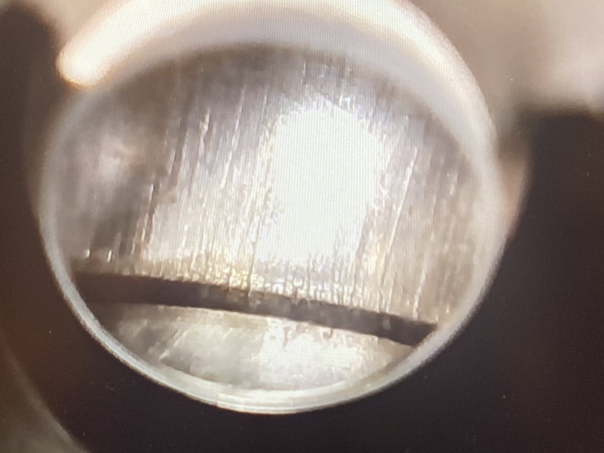

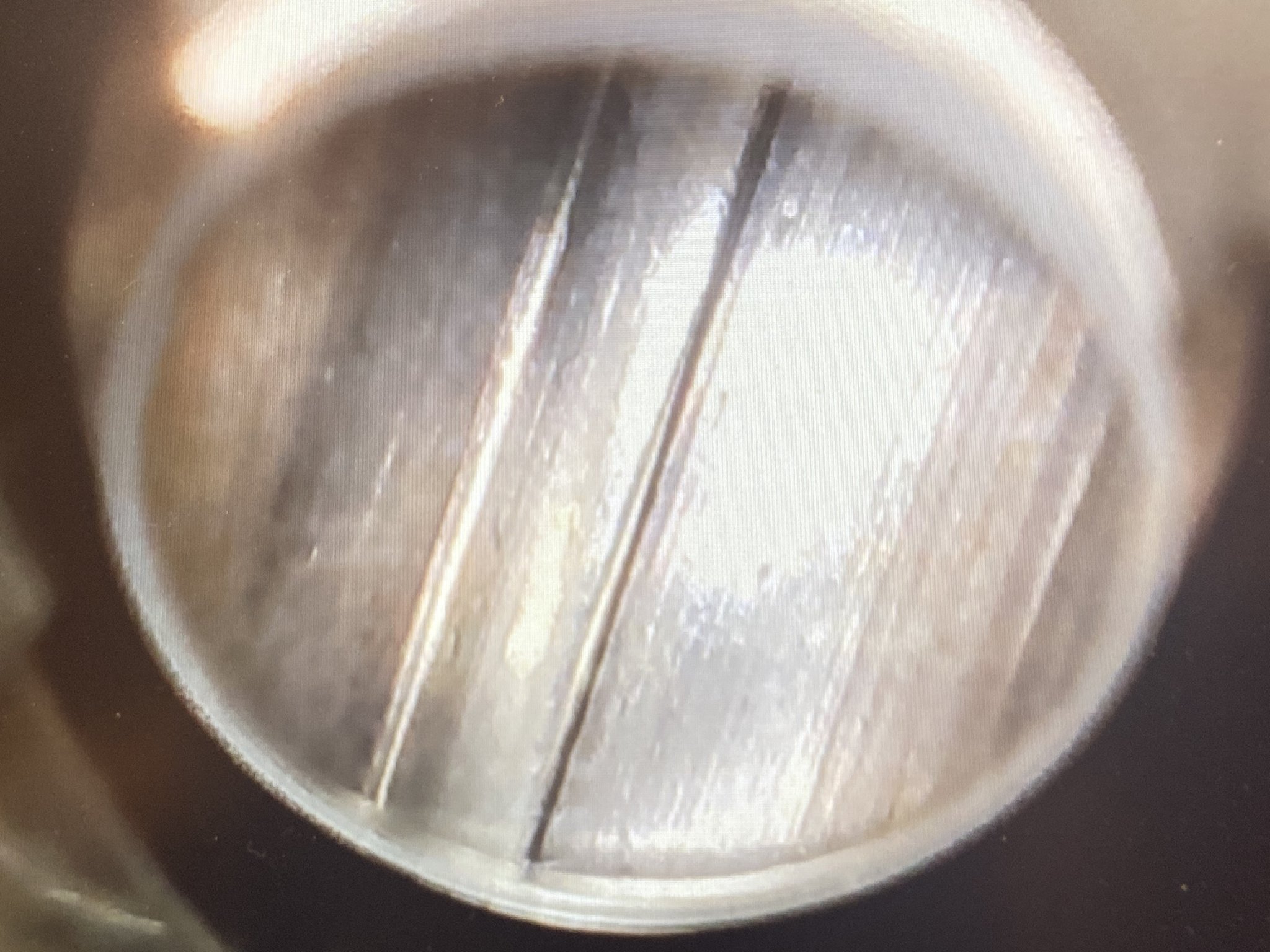

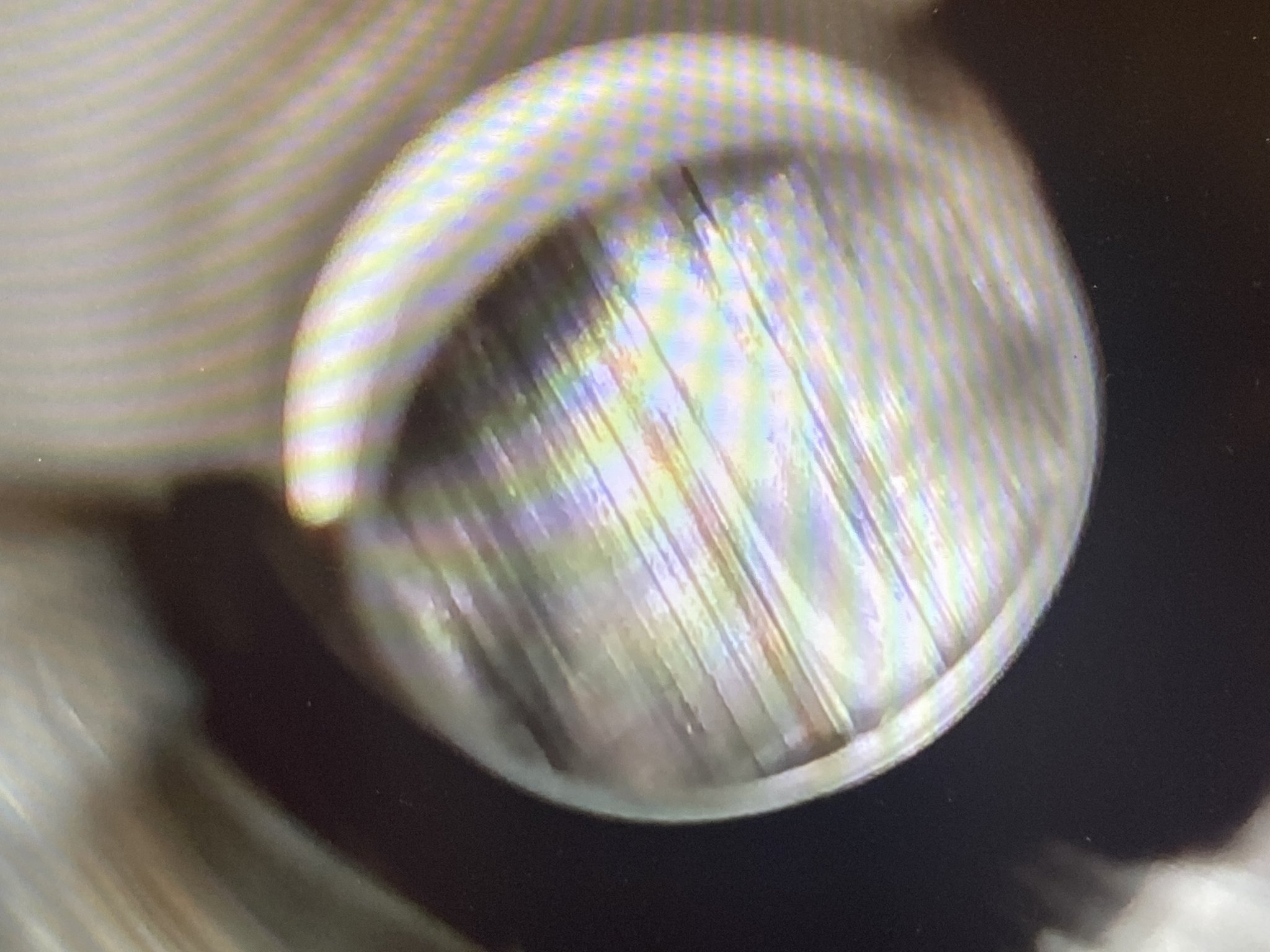

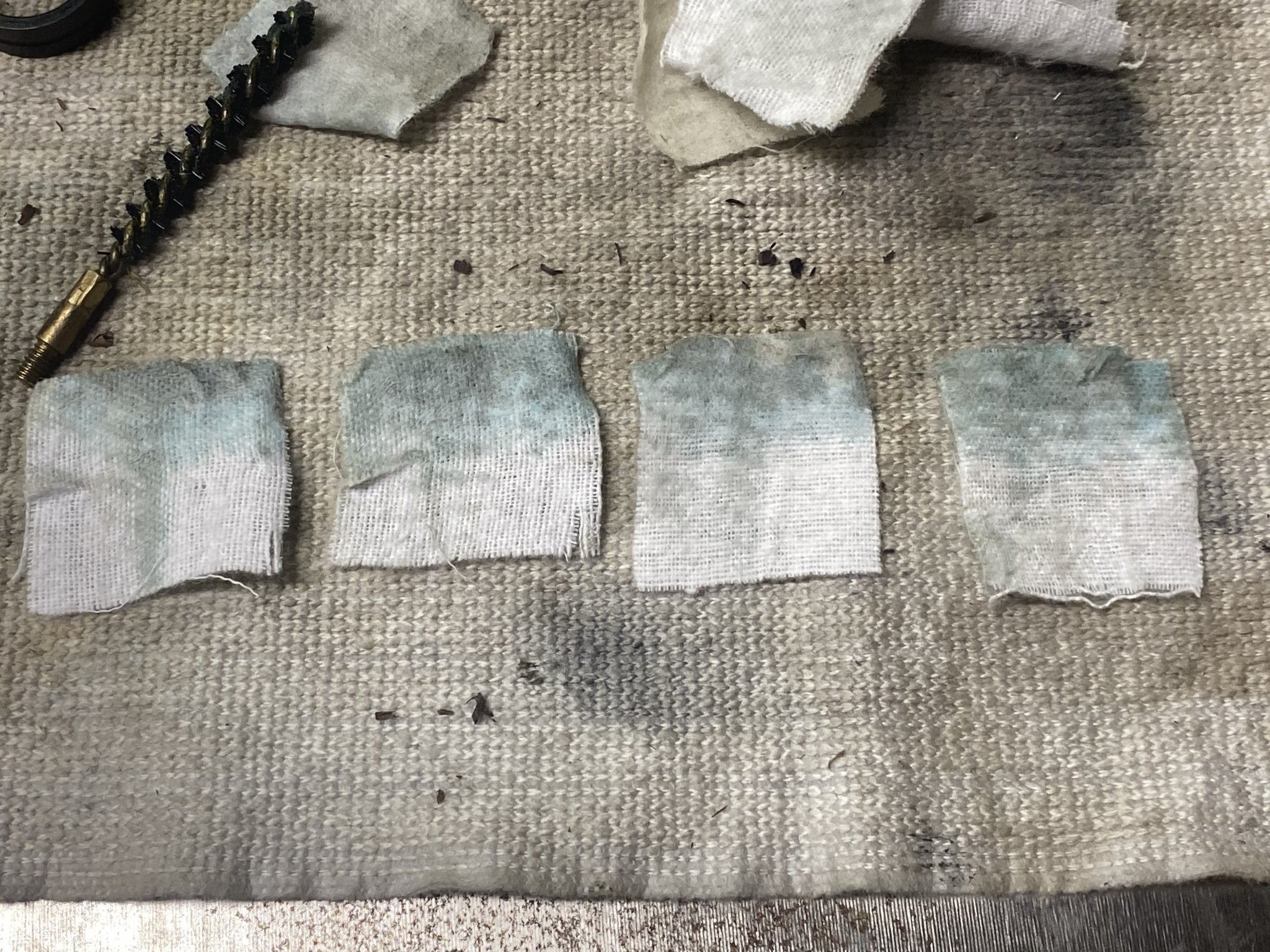

    So while waiting on a bore scope I went through a CLR then Barnes CR10 routine to get the carbon and copper out. I really cleaned this time. Or so I thought. Afyer this I measured to the lands and Surprise! I thought I had only eroded 2 thou. After cleaning that number went from 2.350 up to 2.365. So yea as someone mentioned above, the carbon was giving me a false reading. I’ve eroded 18thou over the 400 rounds.
    The borescope arrived today and I found I still had copper on the lands. Not a ton but leftover smears and flakes. Luckily my carbon ring was almost completely gone so I apparently did ok there.
    I went through one more Barnes job to remove the rest of the copper, did a quick Semichrome patch to polish things upjust a touch and hereare the results along with the patches that came out from the second go around.
    The first shot is the throat with ring gone. Second is midway up the bore. Lands are squeaky clean now. Also some groups from my last range trip. Not typical for this gun. We’ll see what she does in a few days. This has definitely been an eye opening experience. Hopefully she shoots and I can save that Brux barrel for another day.

    Adjust your seating depth if it doesn’t go back to shooting.
    Same for the ring, but use a mop or a patch on the outside of a brush to get the c4 to soak up there.
    Do you soak the mop, push it in just far enough to reach the throat, and then let it sit in there like that?
    As for getting carbon out, yes...I use C4 on very wet patches and it works very well. But cleaning up carbon ring....eh, that's a little out outside of my experience so far so I do appreciate the tips.

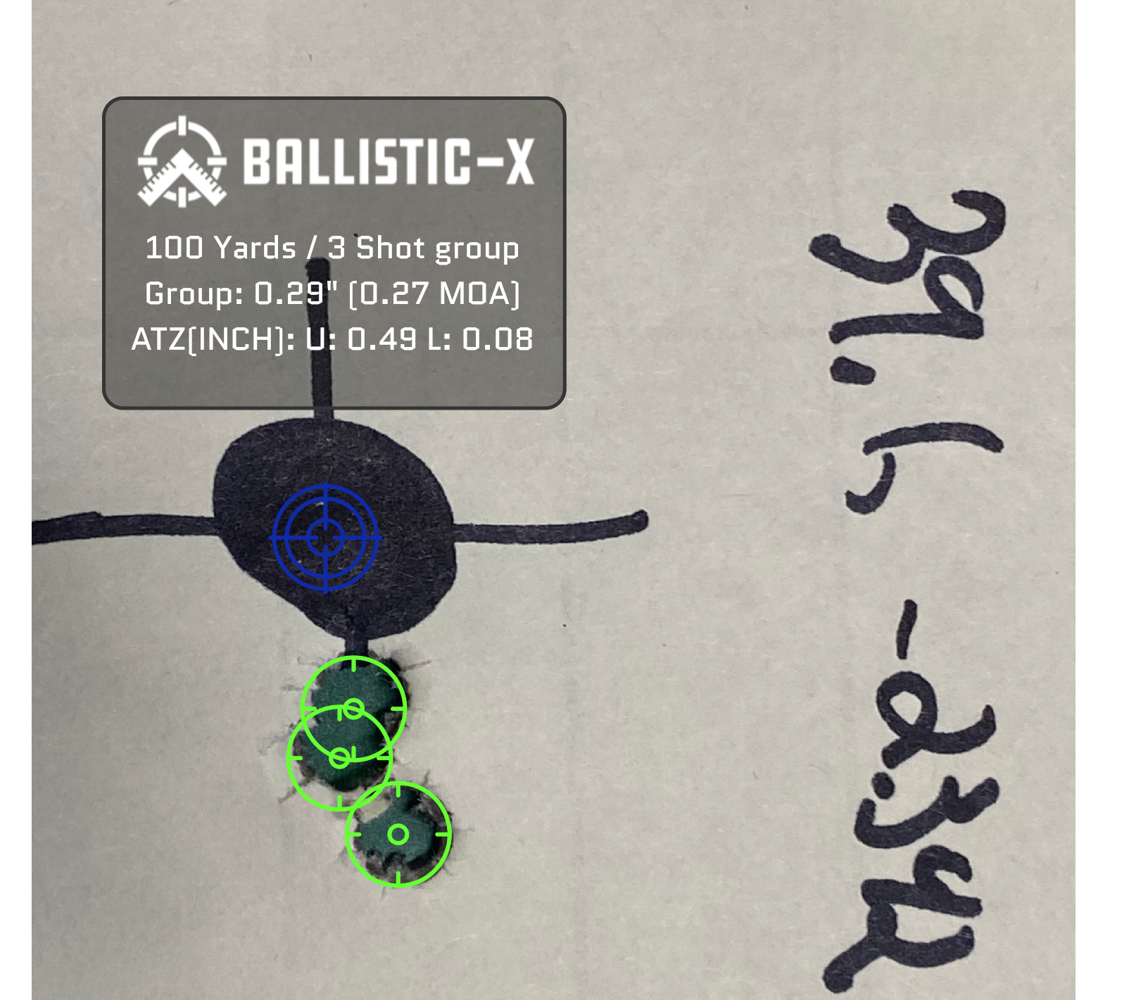

    Here’s an update for my 6mm. After a thorough deep cleaning, she’s back. Thanks to everyone who helped point me in the right direction. The simple fact is that while I’ve been reloading for over 20 years, I have just never shot enough center fire to have ever experienced an issue like this and has no clue what to look for.
    The issue was indeed a carbon ring. Coupled with far more copper than I thought I actually had. The bore scope didn’t lie and was money well spent. Also a great learning experience. The main thing that I’ve learned is that all of this “don’t clean it, just shoot it” talk is very much caliber dependent. What you can get away with in a .308 is not the same by any stretch for a 6mm Creedmoor.
    The rifle is back to shooting .3-.5moa. No more pressure signs and speed is back down in the normal range with consistent SD and ES. The only headache is that I’m having to redo all my load data for the gun. My old powder charges are a bit off and seating depth is certain a bit off as well. Normally this would just mean a lot of shooting and fun at the range. But in these times it means staring at my stock of primers and powder and thinking hard about how much I want to burn to get the consistency back that I had.

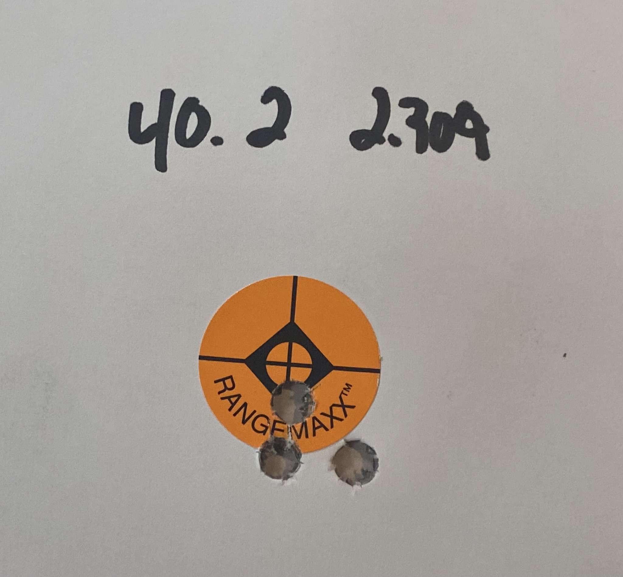

    I loaded up a few different charges and guessed at seating depth. A couple of good groups doesn’t mean it’s dialed in. I need to find consistency in a good node.
    I’m still not following. You had the rifle dialed in before the cleaning correct?
    If so, you shouldn’t need to be revisiting much more than seating depth.
    There’s not much more to this stuff than stable velocity and acceptable groups. And you can tune them separately from one another if you choose to.
