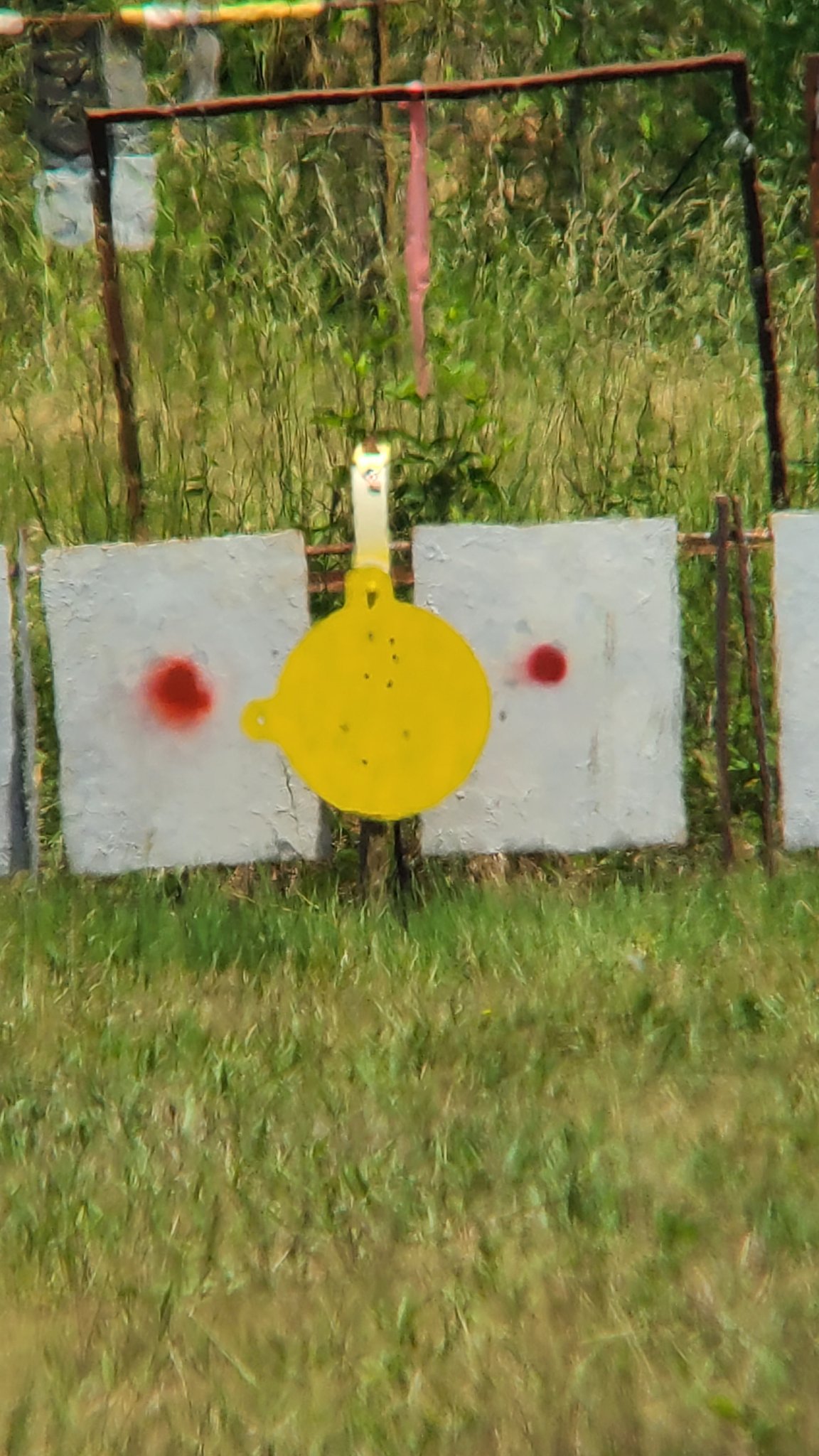

I shot some groups today with my Vudoo at 200 yards
The first group was marked and shot without the Suppressor for 5 rounds then suppressor was put back on for 7 more. A total of 12 shots of Midas + used. The first shot dropped low outside the group, the rest mixed in as you can see.
Then I made some minor dope corrections to center and align the groups better towards the middle of the plate
The average size was about 2.5" realistically speaking
The two smaller groups are 5 shots each, with the 4 above to play with the wind a bit, it was about 8 to 10 today
The head for reference is about 6" square

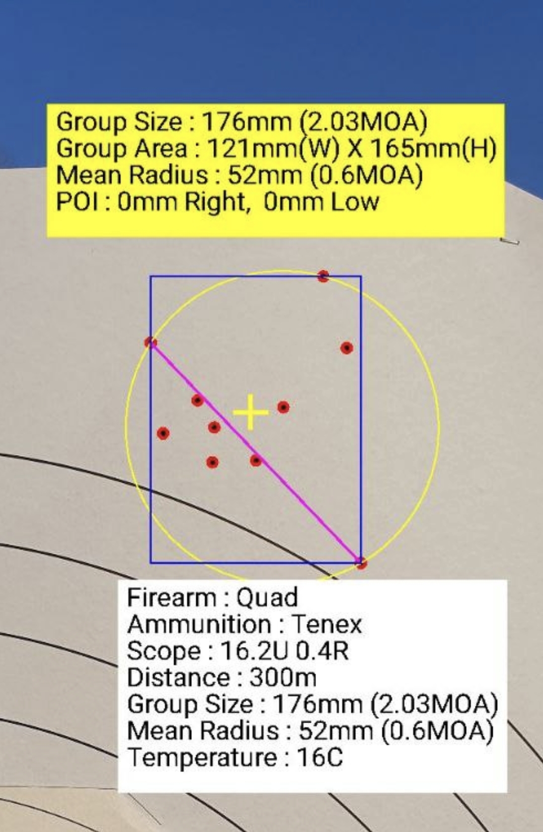

I switched to my trusted Eley Tenex and shot 10 rounds. Mean radius was 0.6moa and the whole group 2moa, I got one low-right (wind was from the right).
So there my lesson to difference between 22LR near and long range differences. They are like night and day, you cannot know how a cartridge does at far distances without trying. Price seems like a good indicator though. Differences this big are hard to comprehend.

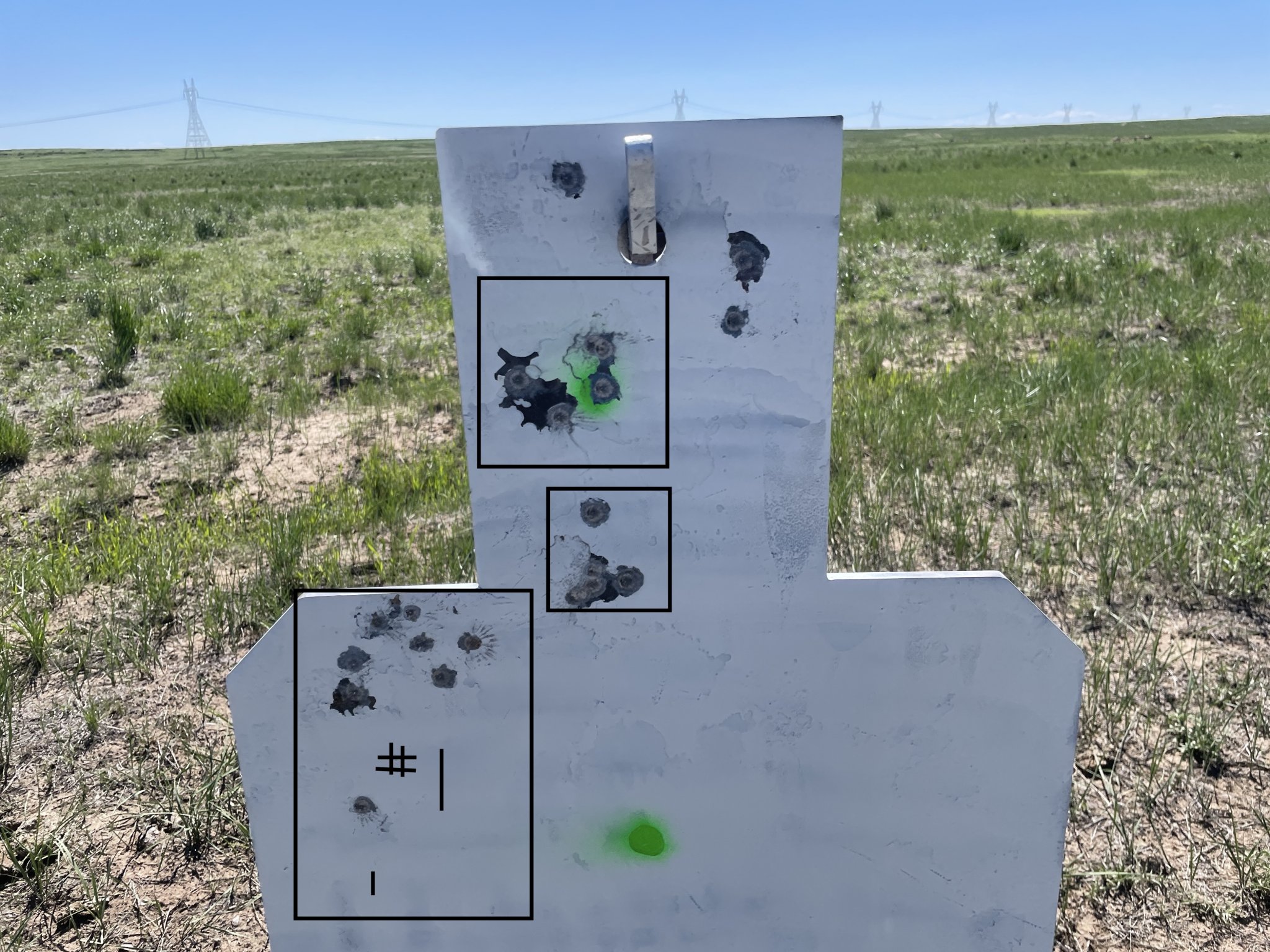

This is a 16" plate at 400yds and I'm using Eley match you can see exactly what we're talking about in regards to the vertical spread.

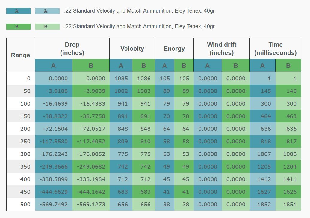

1 fps difference in mv can cause a surprising amount of vertical at extended range.
Eley Tenex at 50 yard intervals out to 500 yards
200 yards 1 fps is 1/10th inch difference in poi.
300 yards it's 22/100ths
400 yards it's 39/100ths
500 yards 62/100ths.
If you get a 10 fps ES y'er gonna get at least 3.9 inches of vertical at 400 yards
Very nice grouping for 400 yds.Love shooting long range 22 rf.
