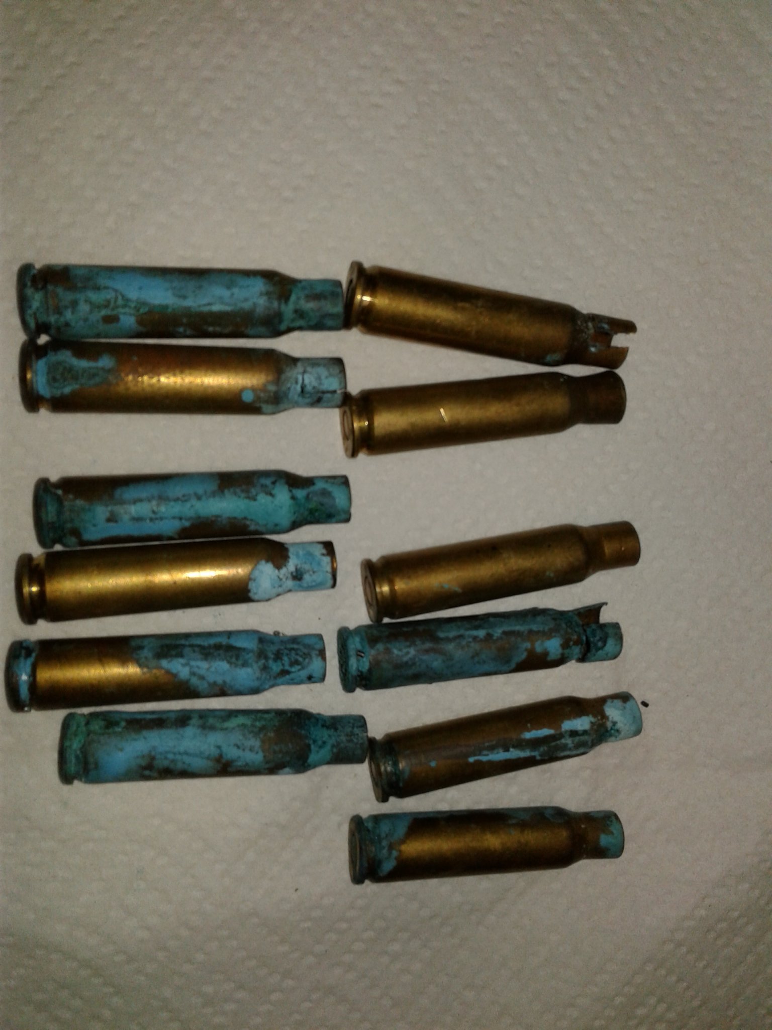

Short version reloading room had " funny smell ", kept looking for source. Found a jug of 4064 swelling in cabinet, opened lid , ( I have 3 more 1lbs jugs ) the same orange fumes as 2495 from last year. Grabbed reload book to look up, what / when / where loads I had. Opened 20 mm ammo can , same smell, grabbed first 2 MTM 50 count boxes on top. No question if powder damages brass !!! Did not know load would sweet, I have seen old mil surplus ammo corrode brass to become brittle. The necks are so brittle that I can push bullet to the side with finger and the neck splits, several of had cracks at neck. The powder , in the rounds that have no vissible signs, is clumpy / sticky.
In my defense, I shot a bunch of those reloads late last fall, no sign or smell of break down. I store everything in sealed ammo cans with desicant packs etc, etc.
I am not looking forward to phone conversation tomorrow, I have a hell of alot of re- loads.
