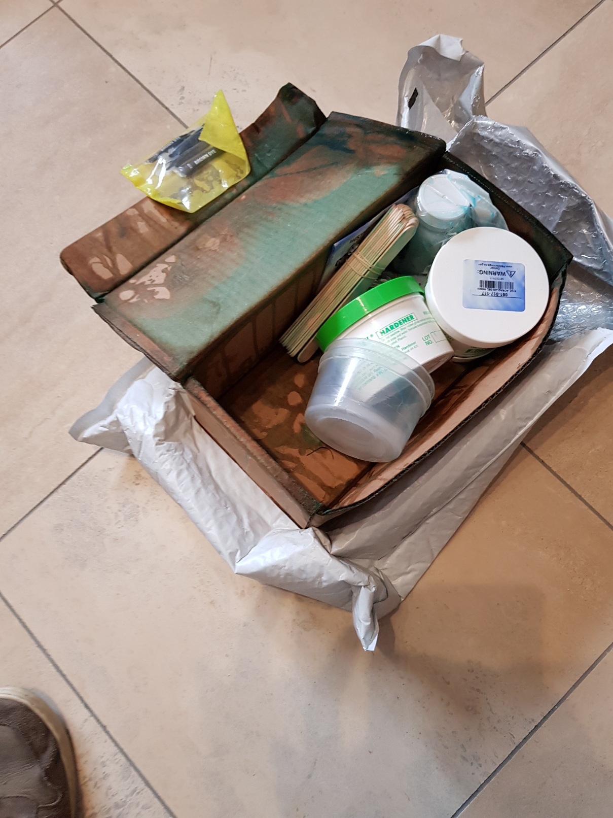

You could bed the action and see if it helps.
Bedding was my first idea but the mailman decided otherwise :p
Instead of purchasing the Bedding compound again, I decided that a massive steel block glued in the stock would be a more decisive solution :) but that's WIP...
