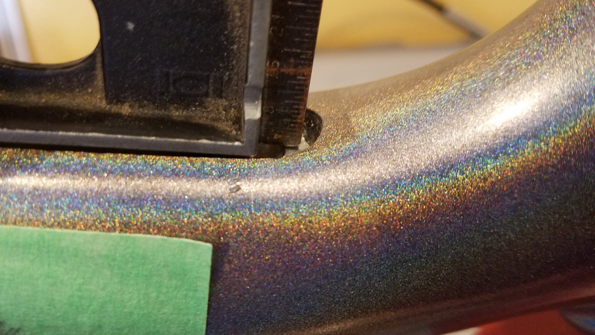

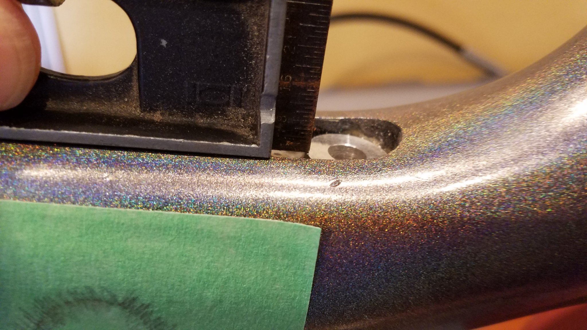

I have a 6BR that started life as a 22-250. The previous owner installed pillars and did a very nice job on the bedding so I left it as is.
Over the past 20 years, it has cracked 3 trigger guards.
A couple of months ago while working on a different stock I pulled the action to use as a fitting guide. I removed the front screw from the trigger guard and it popped up.
WTF?
I started digging into the issue and found the bottom of the pillar was not level to the other pillar. In fact, the front side of it was almost 2mm higher.
Here's the front side using a carpenter square.
Here's the back side. Note the clearance.
Sorry for the crappy photo, but the garage is awful for taking pics.
I took a dremel and a small file to the pillar and now the trigger guard sits in the stock like it's supposed to.
I bet I won't be replacing any more trigger guards.
