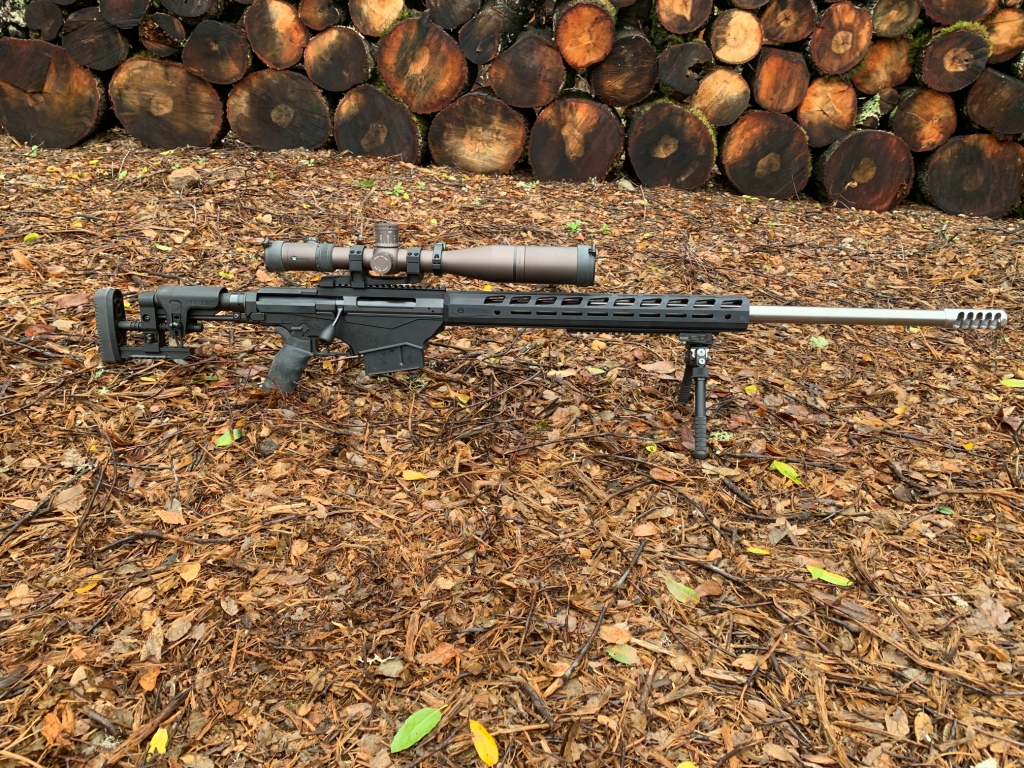

I am looking to build a 300 norma. Wondering what my action choices are, the catch is I hate 90 degree bolts. I would like a 60 for this. It is just personal choice. Only two I can think of that are repeater actions are badger 2013 and the ai stuff.... which ones am I missing?
Ruger Precision Rifle. Originally a 26" 338, now a 32" 300 Norma.
A field expedient solution, not a full custom. Any 1.25" shank blank can be fit if the barrel nut is bored 50 thou.
Nice! I hadn't considered that option. What are the barrel specs and how does she shoot?
1.25" for 5" taper to 1" at 32". 1:8 5R. Muzzle Brakes and More brake.
Shoots like you'd expect, half moa at 100 yards is typical for prone, off a bipod, on natural terrain. It's up to 22#, so very easy to shoot. Extracts well. There is a little hitch feeding from 338 lapua magazines. It's the cartridge in that magazine, not the action.
230 ATips pelted my target at 2300 yards like nothing I've seen so far. The BC and it's consistency are remarkable. I think AB has the BC at .414 and it beat their curve by 1/2 mil at 2300 yards. 3060 fps at the muzzle.
It's not for everyone. There is only 1 trigger available for them so it won't work for trigger princesses. The stock is a little irritating until you figure it out. For just another gun types, it's cheap, fast to build, and very effective.
It's not for everyone. For just another gun types, it's cheap, fast to build, and very effective.
