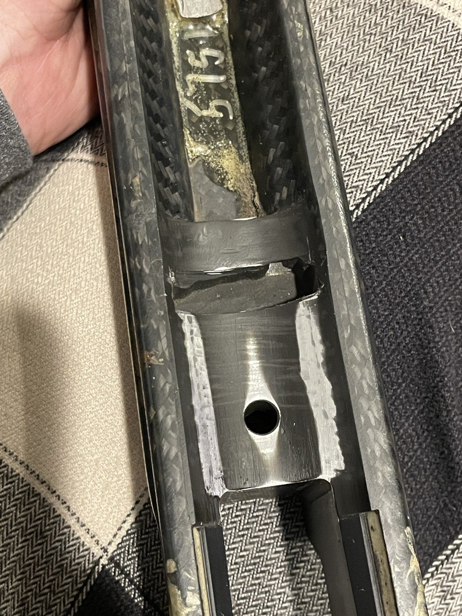

I just picked up a Manners stock for my TL3, but it doesn't fit. The recoil lug is a little wider than the channel in the chassis. Whats the best way to open this up slightly?

It is a mini chassis. I just added a picture to the first post. The seller said it hadn't been bed, but the black stuff seems like bedding compound.
Yeah that’s marine tex. It’s been roughed up and then skim bedded.
That sucks man. I’d be pissed if that wasn’t advertised.
Mini chassis is basically toast now so only way to get it to work with your TL3 is to hog out the material and then rebed it.
Well that sucks. So even if I try to remove the bulk of the bedding compound from the recoil lug area and leave the rest, the mini chassis is essentially toast and I have to bed it from now on?
I sent you a pm.
I would just worry about how much sanding or roughing of material they did before the bed job. Could definitely change the way the chassis interfaces with the receiver.
I’m picky about that stuff and wouldn’t mess with finding out. I’d just bed to the TL3 and you’re good to go
Reactions: kornface13
The mini-chassis is an aluminum chunk embedded in the stock, right? I’d be a little wary of scoring the aluminum (or worse) if I only used a dremel.

I'd hit it with a heat gun first to try and loosen up the epoxy. If it were an all aluminum chassis, then it would be fairly easy because you wouldn't have to be as careful. With that being a carbon fiber stock, I'd be leery though. Because the same epoxies used for the bedding is keeping the CF together and the mini chassis in place in the stock
I've removed plenty of epoxy from all aluminum chassis's (and golf clubs) with a heat gun. Best results were going slow. Keep the heat gun moving. Take short pauses to let the heat soak in to break the bond.
But then you'll have to rebed because depending on how much aluminum was removed to bed it in the first place, your action may not sit evenly

Work it out with the seller to reverse the sale and get all your money back or have it re bedded by a gunsmith. That is all!
looks Like I had some wrong info listen to Terry maybe if you send him the stick he can work his magic
