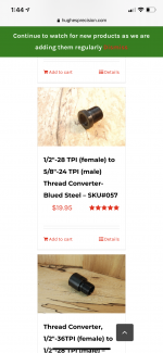

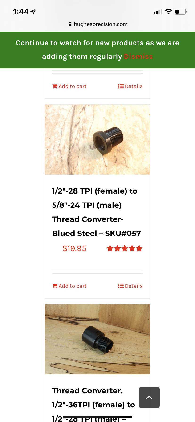

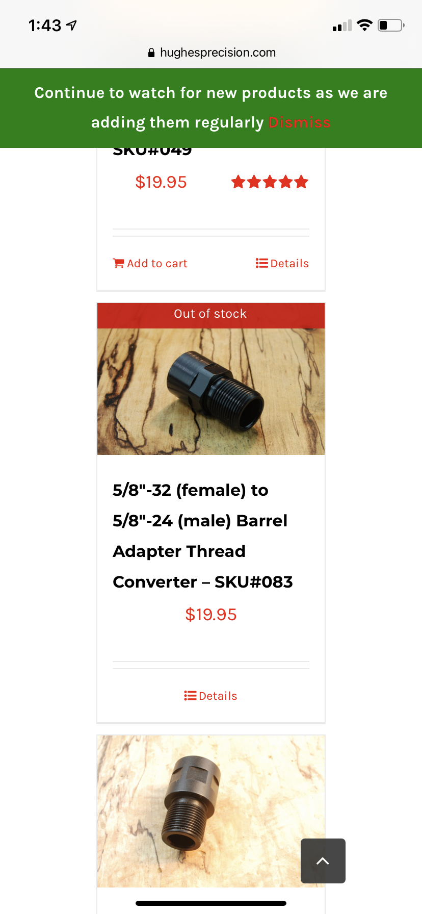

Thanks Blbennett 1282, but this is what I was looking at. Would this work or do I need to spend the extra $

I don’t know of them, so use at your own risk.

I have used the Hughes precision adapters a number of times with no issues, though never with anything so close in tolerance as a 450BM/Hybrid. They have been well made in my experience, but I would definitely recommend checking alignment with a range rod before shooting.
How ya figure?
Well on a rifle it didn't look like the bore was large enough but pulled a new one off the shelf and looked at my Hybrid adapter and looks like it might work. It's close enough you might check with Area419 but maybe yeah.
