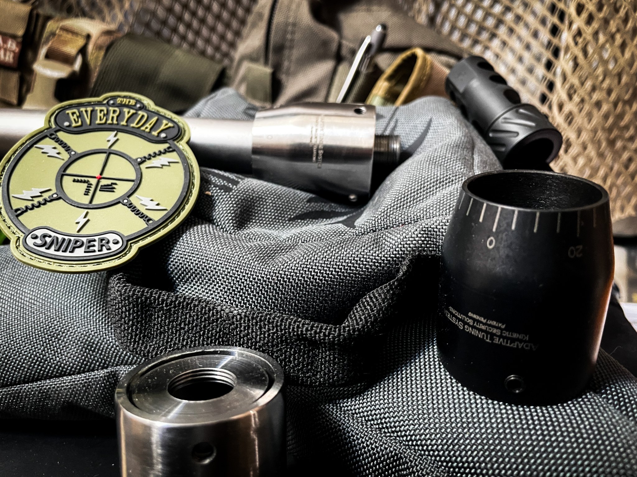

    I am jumping into the Tuner World, which I think is an awesome direction,
    Grabbed a few to give them a try, for a guy like me who uses factory ammo, this should be a nice improvement.
    I know we have a bunch of other tuner threads, didn't see a dedicated Adaptive ones.

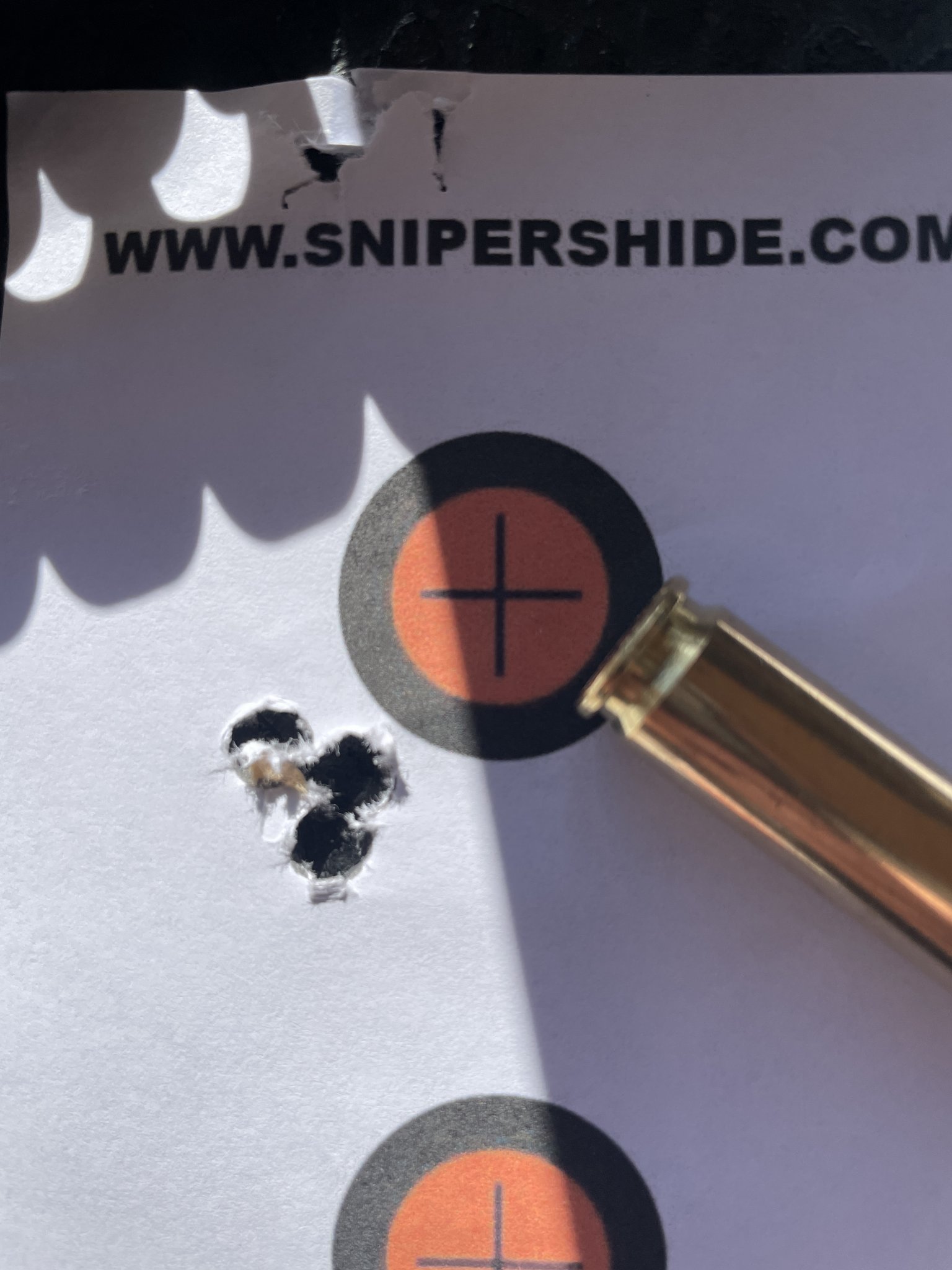

    Yesterday, I found a lower node at 2835fps with the 77s. Four rounds into a quarter inch and the 5th bleeping round doubled the size.

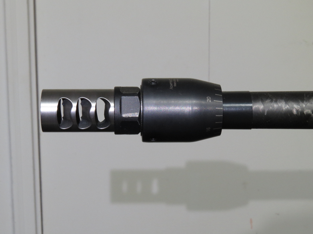

    I've got mine mounted on a 6BRA barrel. I've only tried tuning a little during load development, I hope to get out and do a little more this week. I did see groups open and close, but I didn't find a 'node' of multiple adjustment settings with small groups like I sometimes hear.

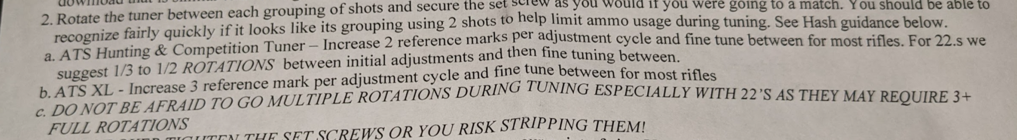

    Where did you guys start the tuning? Mine is pretty close to this image, which is what I think the instructions call for as a starting point, but I can't help but think there may be some benefit to running it further forward.
    Pretty sure the instructions say to start with it flush. That is where I started.
    Instructions say leave it where it arrived
    So how you took it out of the box is where you are supposed to start
    Then 2 hash increments is how I read it for centerfire
    In 2-hash increments, what is the total adjustment range? Put another way, how much ammo may be necessary for a tuning session? Just ordered one and want to be ready with ammo in hand...
    That would depend on the ammo. One took one turn and another was 6 and probably needed another couple. Have 20-40 rounds ready and you should be fine.
    @Rob01 do you do a full turn to the second hash or just turn 2 hash marks over, shoot, 2 hash marks over shoot, or full turn to the 2nd hash, shoot, full turn, to next 2nd hash ?
    It sort read like a full turn, but then it said 22 stuff, and then 2 hash increments, so I was a bit confused by that part
    The directions say start with tuner just behind the face of the collar, which is where I started. I then screwed in (towards the action) 2 hashes per over a total range of 3 revs. I found two positions that grouped well, about a turn an a half apart.

    From flush there are roughly 4 revolutions with 24 marks per revolution. So basically 100.
    For what its worth there is also ~3 revolutions forward of flush before the set screw reaches the end of the inner piece.

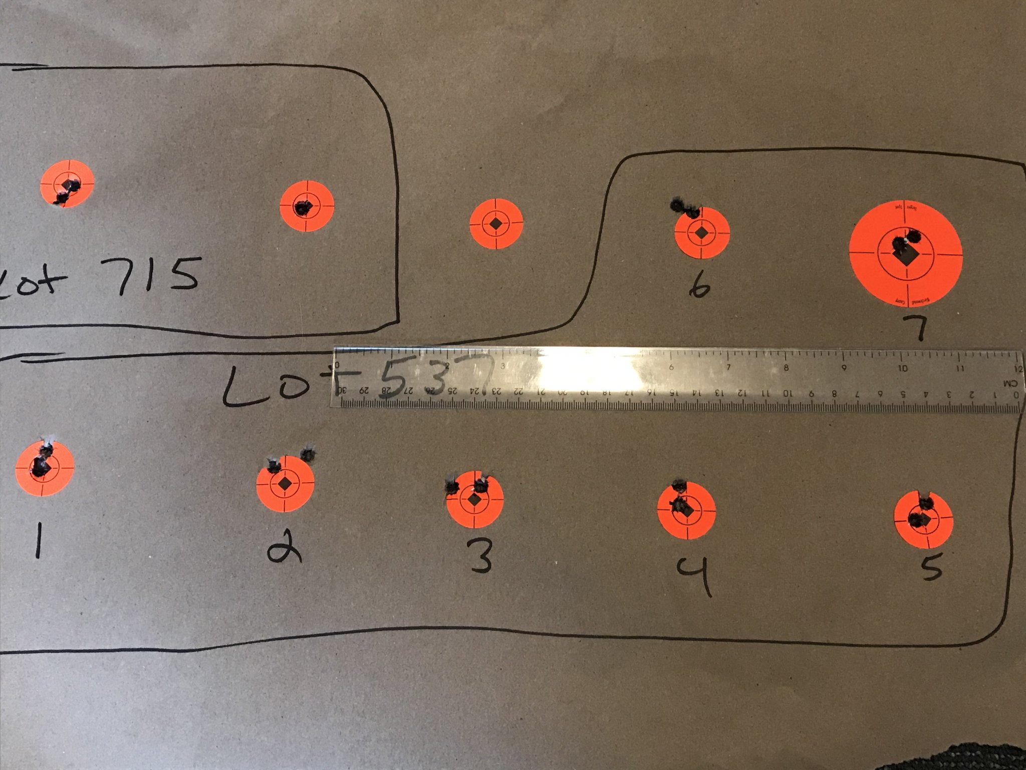

    After I got done I took a pic of the lot of ammo and setting so I had a record of where it is set. I just used the center of the brake as the reference point.
    Taking photos as a note. Nice. I do the same, but also have a log book of data. Redundancy. Good idea to record ammo lots.

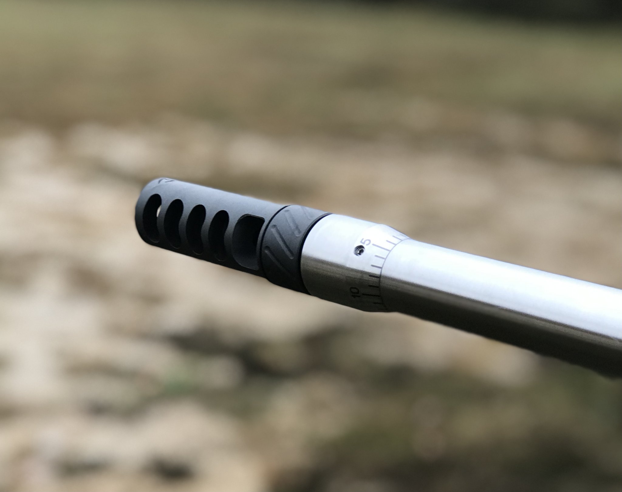

    Waiting on the EC tuner/brake, I did order a .750 shaft collar to see if that works as well. Saw some dude on youtube do it and it worked lol I'll be shooting at the range anyways may as well try for a couple bucks.

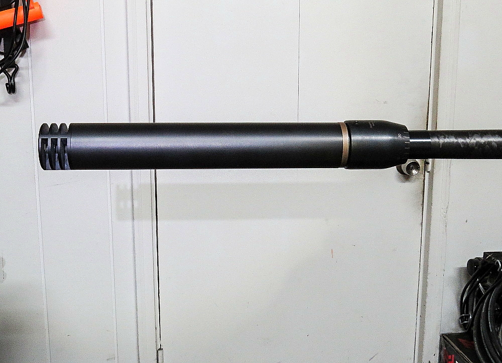

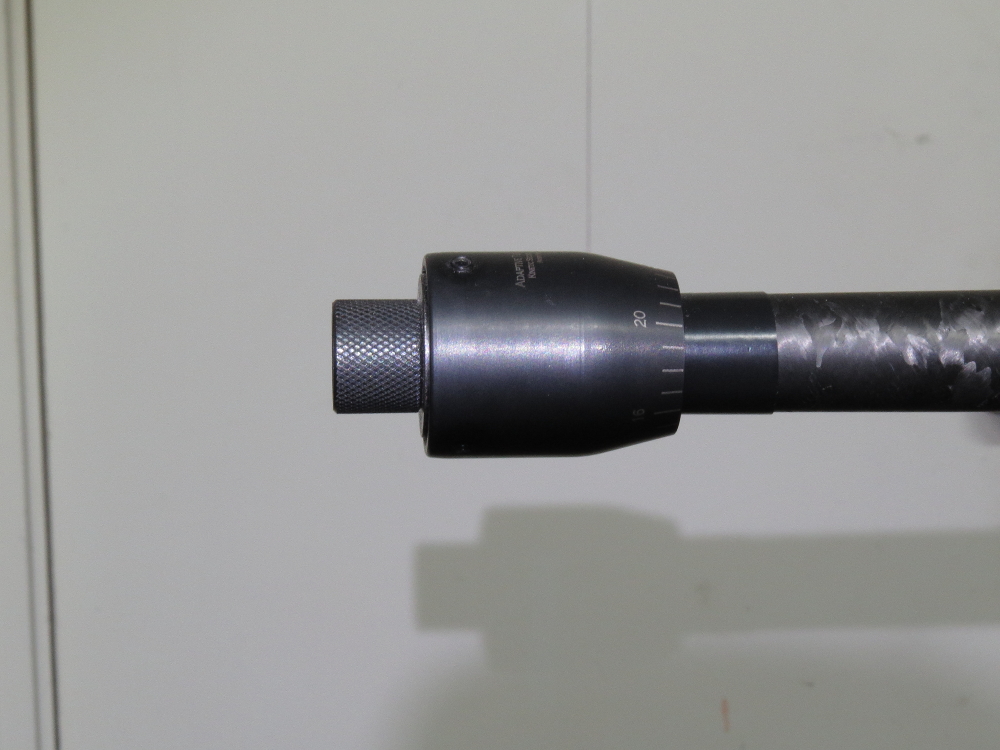

    I wonder if Tuners need to be so big and have so many revolutions. Speaking to F-Class shooters who have been using tuners for years, they talk about patters repeating around revolutions and that small changes in settings can have a material impact on groups. We really don't need 3-5 revolutions and hundred+ settings especially if you have a well-made rifle, use good components and have done some basic load development. We are 'tuning' a load that shoots well already.
    With that in mind, I am trialling the EC 'Micro' Tuner which is basically Erik's tuner reduced in weight by 40% for finer / less coarse adjustments.
    I tried various settings and Groups 0, 3, 4, 5 and 10 were sub 1/4 MOA with 0, 3 & especially 5 showing the most promise/repeatability following a second round. This was shot with new brass standing from a bench and I only used half the travel available from the EC ‘Micro’ tuner. I am planning to take those settings out to distance soon.
    I tried various settings and Groups 0, 3, 4, 5 and 10 were sub 1/4 MOA with 0, 3 & especially 5 showing the most promise/repeatability following a second round. This was shot with new brass standing from a bench and I only used half the travel available from the EC ‘Micro’ tuner. I am planning to take those settings out to distance soon.View attachment 7522095View attachment 7522096

    For 22LR, I had to do 2.5 revolutions until I found my tightest groups. The updated instructions say to
