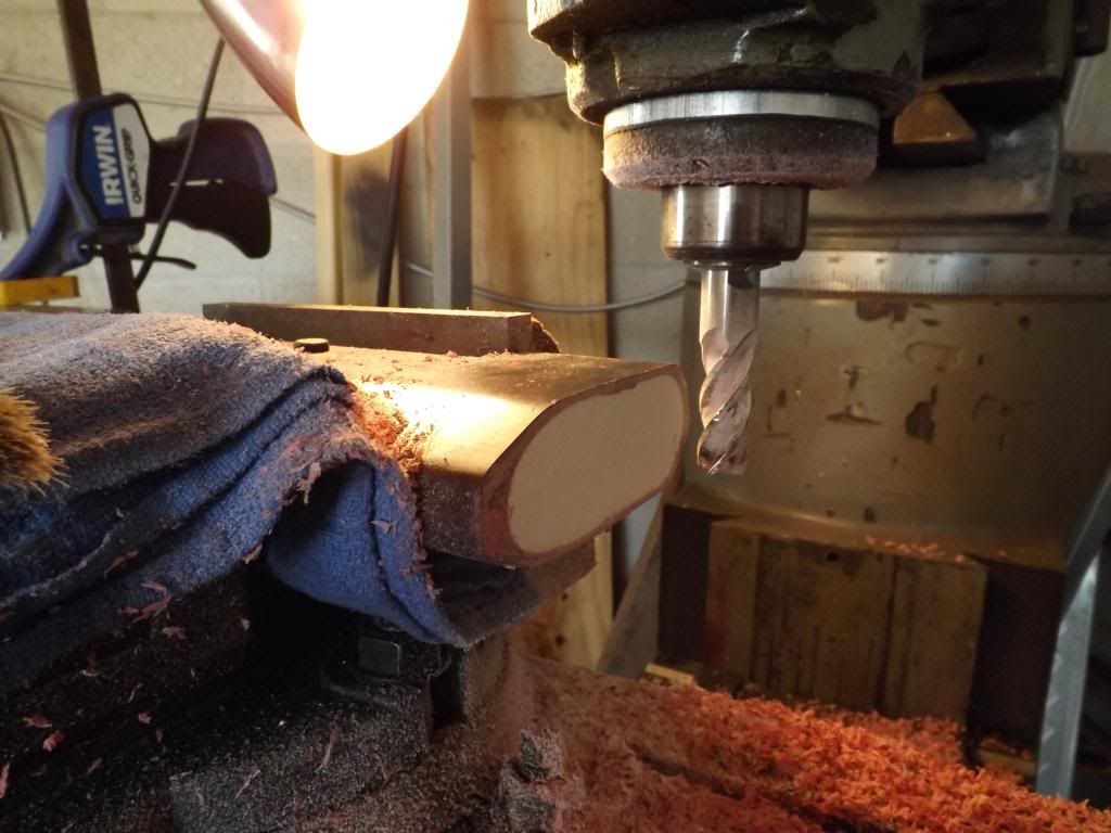

It will depend on the fill in the buttstock if I recall correctly.
This pic shows what you will most likely find in the McMillan stock.
Yes, I've done a couple of these projects. Buy the kit from Tom Manners or have him do it for you. If you have a few tools and understand what needs to be done, it's not that hard to do. A little cut and fit, some careful epoxy and finish and you're there. If you're a craftsman, it a very manageable project.
Call Manners and talk through it with them, great people and you'll know pretty quick if the project falls within your skill set or not.
^^^that what the inside of a Manners looks like too.
