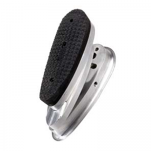

    Now that I've been getting my 37XC off the bench and out into the field, I've been running into issues with the stock and my rear bag. Not the least of which is that the sharp edges on bottom of the 3-way adjustable butt plate (see below) were ripping up my Protektor rear bag thanks to the heavy recoil.
    I ended up making a wooden spacer fit to my length of pull to stop this. It works, but it doesn't really look all that great. So, when I was at the machine shop to pick up my extensions for my cheek riser, I showed them the butt plate and asked if they could make me an aluminum spacer to match. It would be expensive, but they could do it.
    What does this have to do with an adjustable bag rider?
    Well, I've been enamored with the notion of using an adjustable bag rider since I first started using my Phoenix bipod and Protektor rear bag. When I'm out on uneven ground, I have to do significant readjustment between shots. It's really a pain if I have to reach way forward to adjust the Phoenix. So, why not get an adjustable bag rider? It is straight forward for many chassis, but for stocks, it's not so easy. You have to have a way to mount it with enough room to allow the dowels to clear. This means some serious surgery on the stock IF you can even find someone to do it.
    My thinking is that if I'm going to make a custom aluminum spacer so I can ditch the shitty looking wooden one I made, why not add a bracket to the bottom that can mount an ABR? So, that's what I'm going to try. I just ordered an ABR and will be taking everything over to the machine shop in a couple weeks. If this works out, I'll make some mods to my 300 PRC stock and try it there as well.
    I'll post progress here.

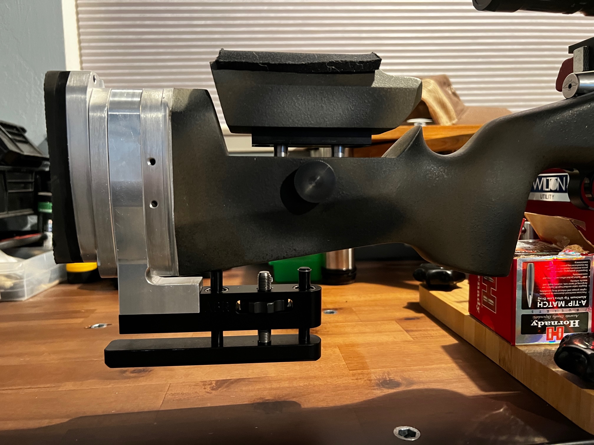

    I got my bracket back from the machine shop and it looks like it will work really well.
    I'll get to put it to the test next weekend, but so far just playing with it looks very promising. If you're wondering about the posts impacting the stock when the ABR is all the way closed, there are holes drilled where the rear two posts are - the forward post does not impact.

    I've seen similar, but I've never been a fan of the form factor. The adjustable bag rider is a lot more compact and, once installed, is part of the system, and not another piece of equipment you need to lug along. Additionally, adjusting something with an extra 15 lbs worth of rear bag on it vs. half that or so is a big difference - more work to adjust. The bag rider is smooth, simple, and easy.
    agreed they are clunky

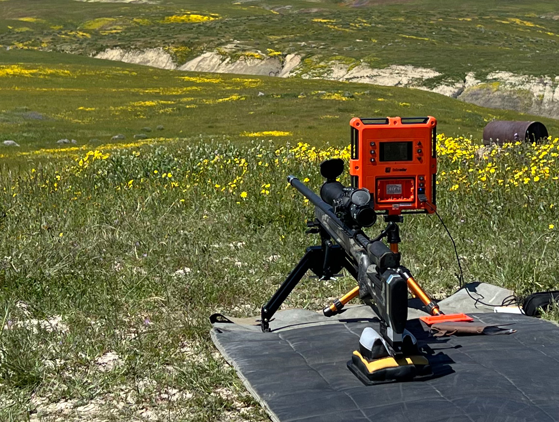

    Went out to BLM land to test out the bag rider. It worked very well - game changing...
    EDIT: Also, I had a low bag from Protektor. It worked just okay. I don't feel like it gave me the support I needed for the 375. It also doesn't need to be as low as it is, so I'm going to see if they can custom make a half-height flat ELR bag.

    For ELR...and especially at a place like Black Bear SHooting Complex where you are doing high angle shooting.....a lot of us use stacked heavy rubber blocks under our rear bag to give us the height we need.

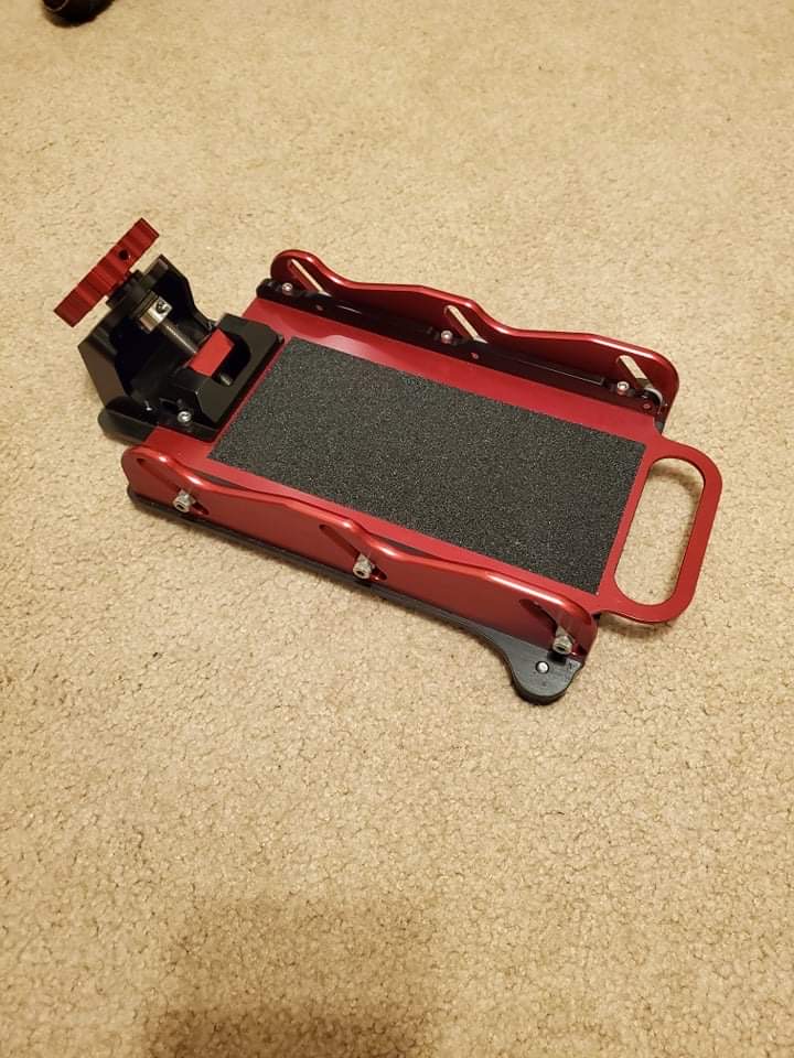

    remember these exist as well, i haven’t got to use mine thoroughly but they are very nice.
    I have 2 of them. They are better suited for prone shooting than benchrest, just so you know.....

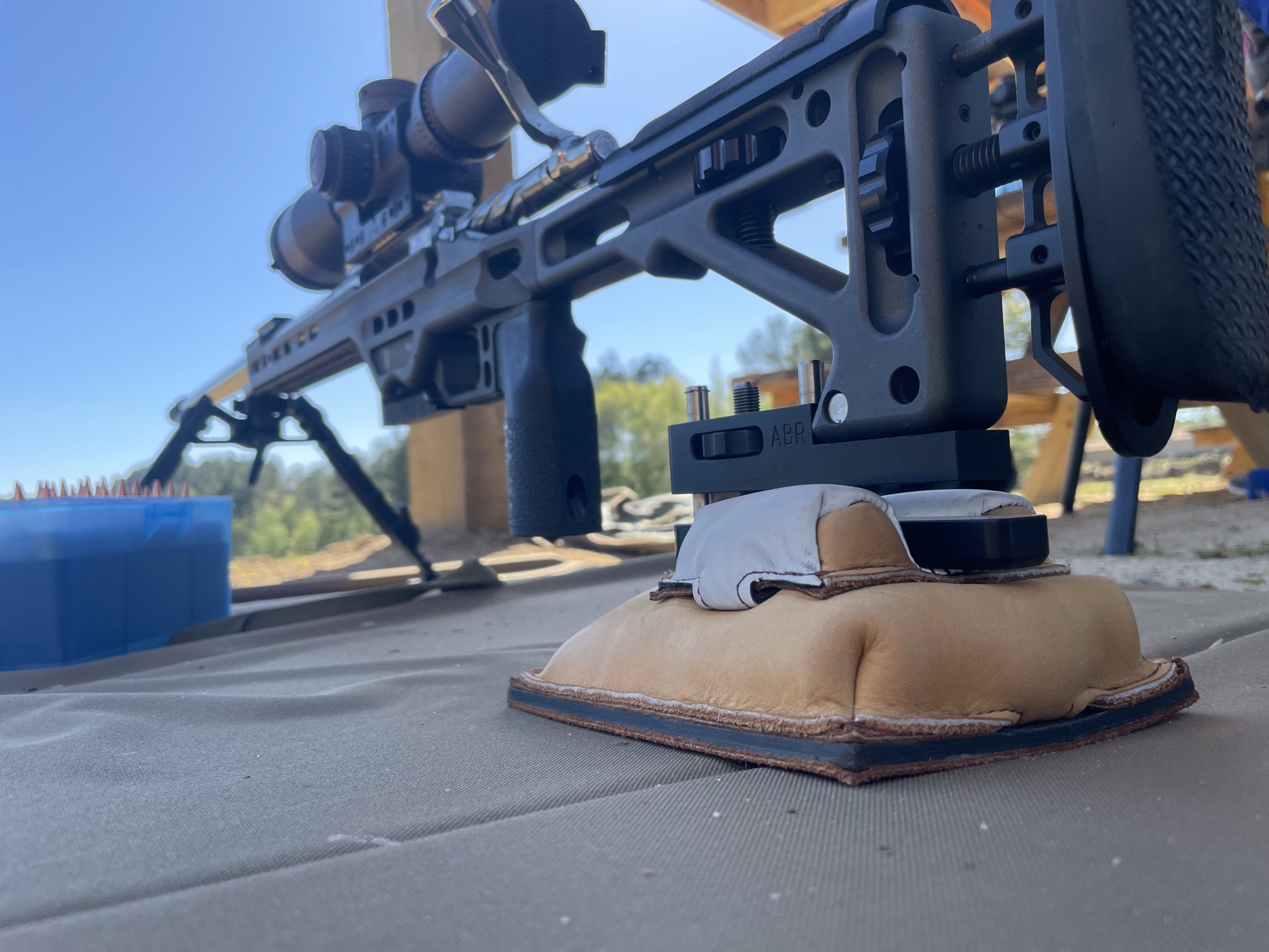

    anyone else have pics of adjustable bag rider on a typical style stock.
    Planning a build and I was wanting to use the new Manners ELR stock but apparently the adjustable bag rider version is only available for the larger actions, which I was going to use but plans changed.
    Hoping to see what solutions people came up with. I don't want to raise the rear end up crazy high, it would be nice if there was a stock out there that would accommodate it decently.
    The ABR on the Manners ELR will prevent the adjustable cheek piece from working its full range , they interfere with each other
    I'm assuming that means it won't go all the way down? I doubt that's an issue for most, usually need a tall cheek piece for big rails.
    it will only go down as far as the adjustable posts of the ABR . They set them in the same spot, move the ABR down and you can lower the check piece, move it up you have to set the cheek piece higher
