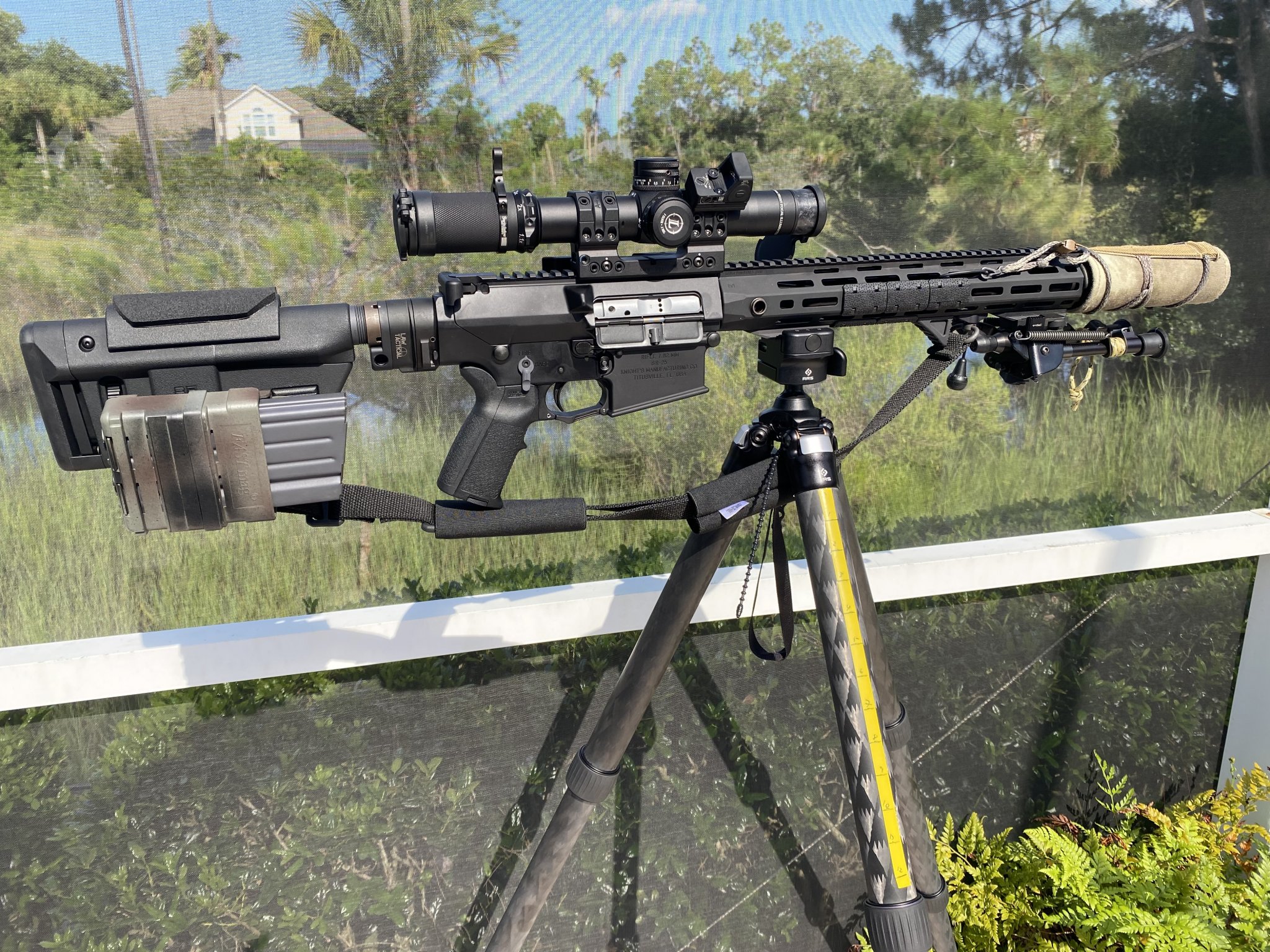

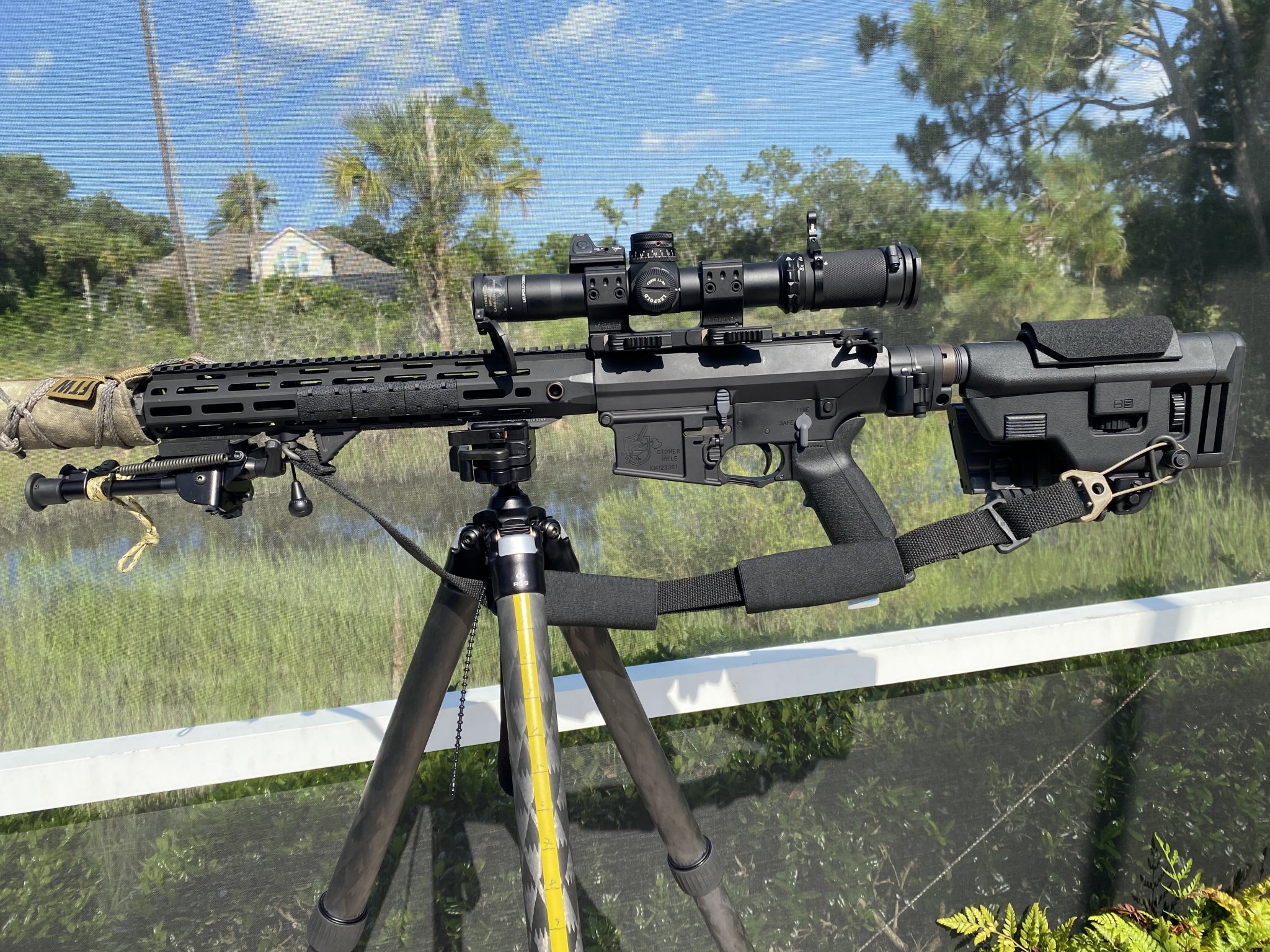

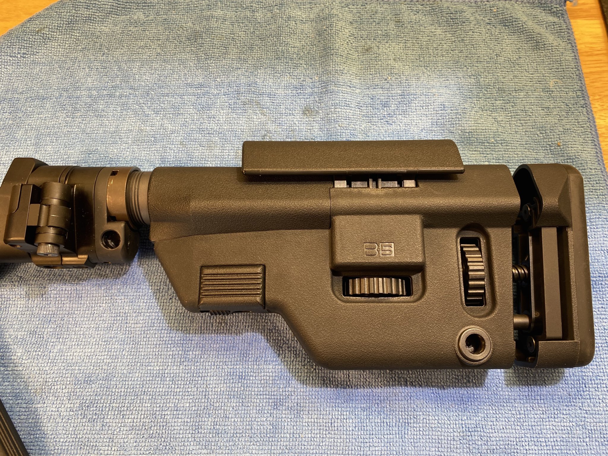

Maybe because lots of fully adjustable stock options. I was not impressed with the Luth AR (as in: sold it), but many people like them and they have other models now. The Magpul PRS is sorta the standard I think:
But simply EVERYONE makes an AR receiver extension buttstock. For adjustable, I also like the carbine receiver extension, as you then get to do gross LOP adjustments by moving the whole stock. You will need to replace your A2 extension etc so that may be too big a change for you.
(Don't ask what I have. I've customized something, fully building bits from scratch).

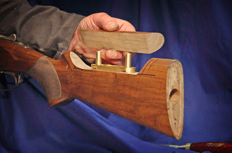

not that it would or would not work there was a video online where a guy cut his cz mtr which is solid wood and added an adjustable cheek piece and but . granted it was a 22 lr stock but there is no reason you could not just do the same thing with your gun using the wood it already has . sorry I can't seem to find that video link but a good gun smith who works with wood should be able to do the same thing if not you your self . I also am unsure what type of hard wear you might need nor whom makes it .
best of luck what ever you decide if you do it please send in pics and detailes on what you did that would be cool to see it before after and during the process .

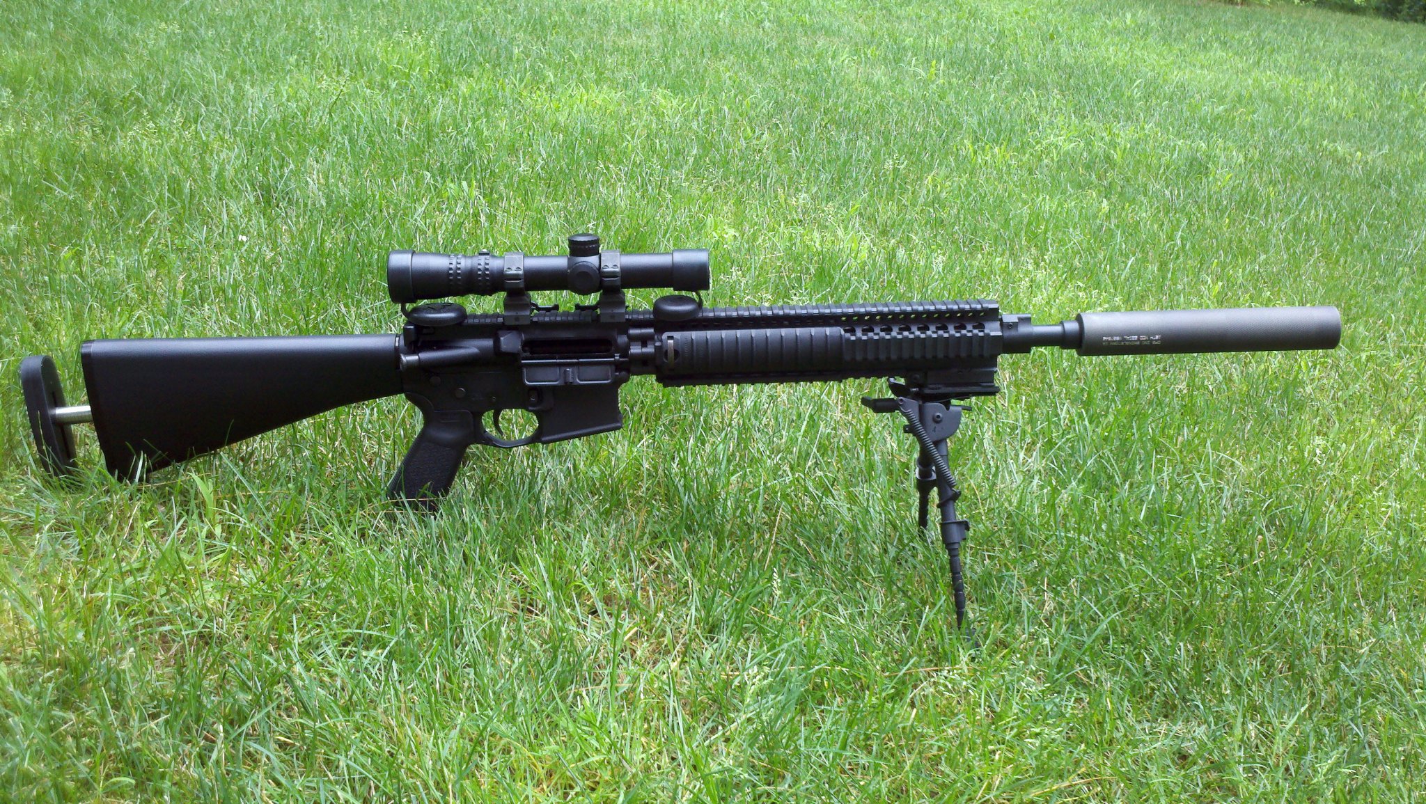

I have an Accuracy Speaks on my Mk12. I talked to Derrick Martin a few years ago and he was looking for a manufacturer to make more as he had a bunch of demand.
I would gladly make drawings to get some made, but such effort should include Derrick.
