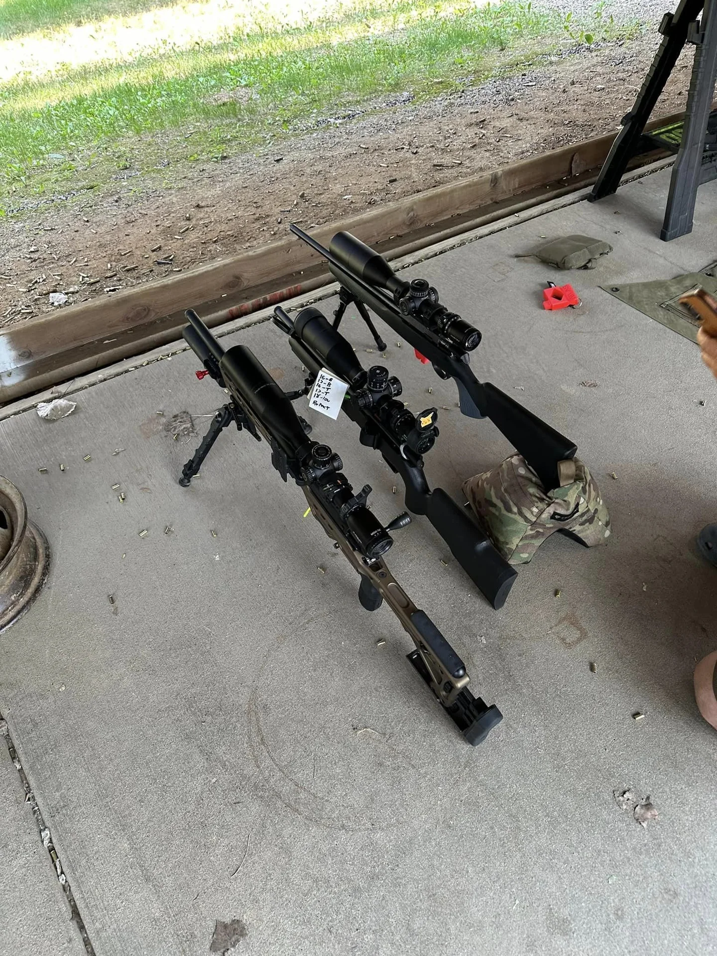

I added a Harris Pic rail adapter and a cheap UTG bipod to my Tikka T1X for NRL22.
It is useful for some of the stages and also for grounding the rifle when needed.
