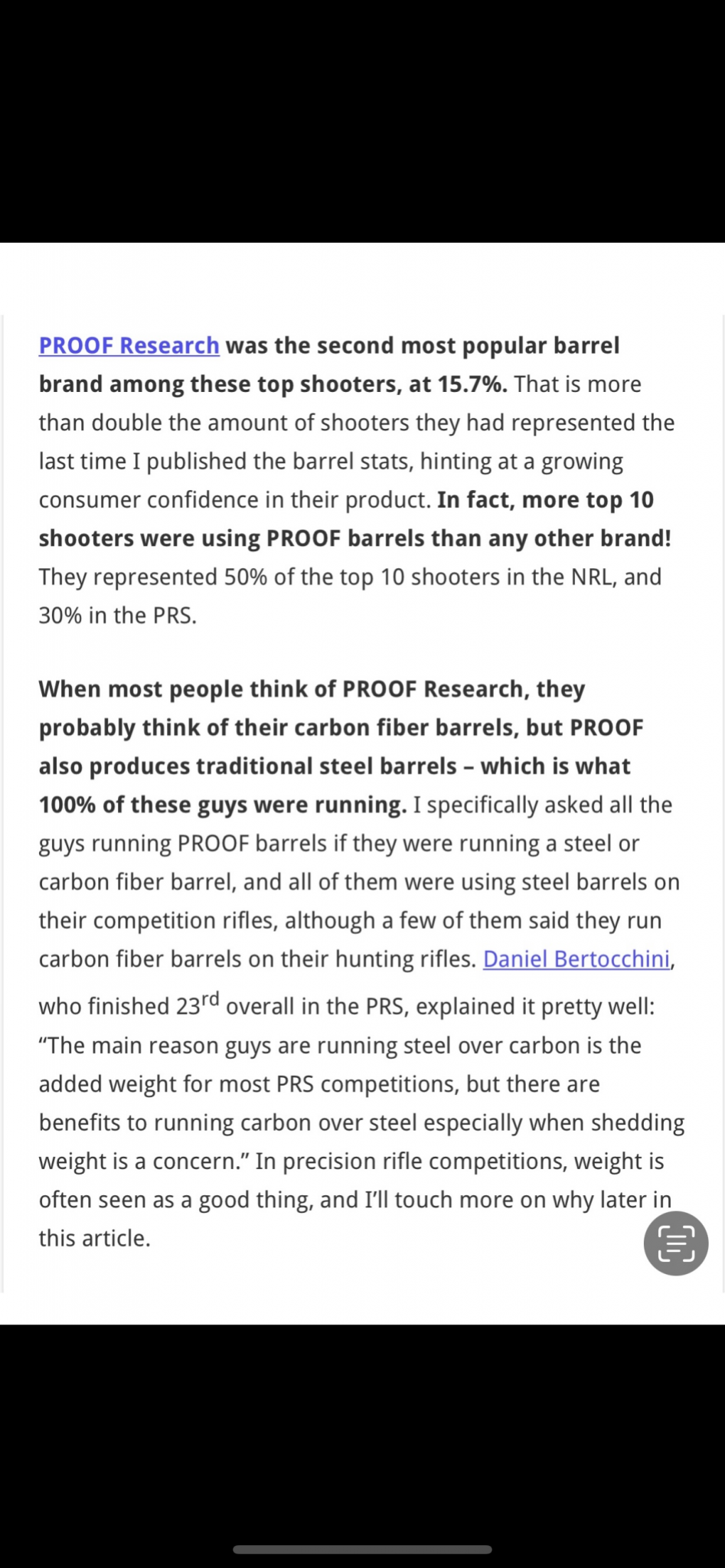

He said he’s an accuracy snob and mentions holding up under long strings of fire. Fact is that rules out carbon fiber. As I posted above even proof shooters shoot stainless. All of them. Besides 16” isn’t going to be very heavy even in stainless.

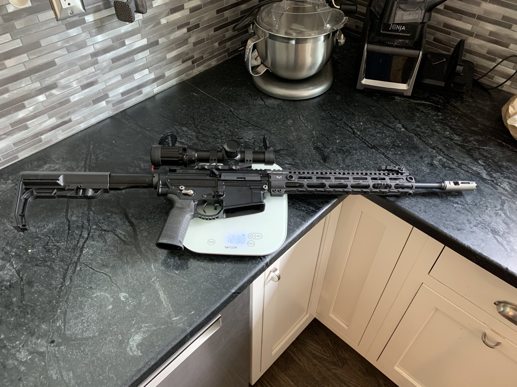

Who said AR10’s were heavy? That’s 7.68# with a not so light SWFA 1-6 Super Sniper scope. I did eventually take the titanium muzzle break off and put a Area419 Hellfire on it so I could get repeatable accuracy with my suppressor; which added a little weight. The barrel on this one is a Faxon Gunner 16”. As far as accuracy goes, the picture below is of a group at 100 yards with Federal 168 GMM. I shot one round with the Hellfire brake, then removed it, put my suppressor on, clicked up 1.3 MRAD, shot another round, took the suppressor off, adjusted the scope down 1.3 MRAD, put the break back on, shot another round…….got board after switching back and forth for 7 shots and decided this level of repeatable precision was good enough for me.

Great group. The reason Im planning on going with a kreiger or bartlein is quality control. Looks like youve gotten a great barrel from faxon. But not all faxon barrels are going to shoot that well. Im hoping that a craddock bartlein offering is guaranteed sub moa 5 shot groups, or better.

I agree, I did for sure. I have three different Faxon barrels and they all shoot well, but I’ve read other’s experiences do not mirror mine. Also, I would never expect a Faxon to compete with the ones you have listed, they are just not built to the same tolerances which is reflected in the price. I also have a lightweight 16” 5.56 and a 20” 6.5 CM fluted match; all my Faxons group 1 moa or better with quality ammo. I consider myself fortunate from the complaining I’ve seen online.

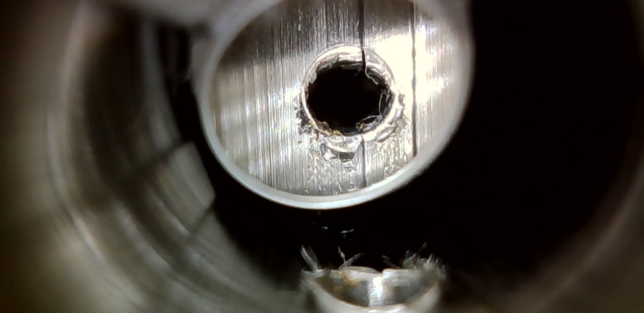

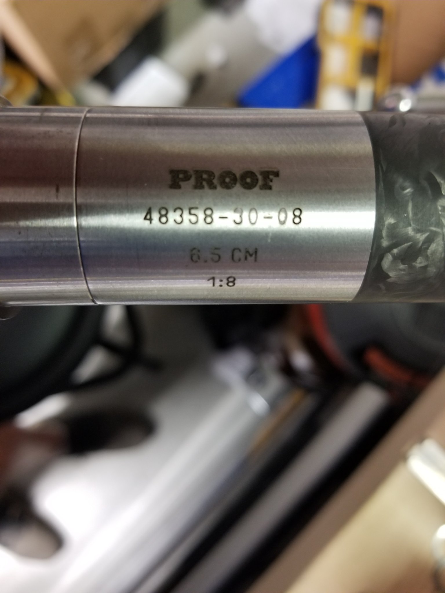

I went down the custom DPMS-pattern 6.5 Creedmoor AR10 path. I'm done pulling my hair out & left a voicemail with CLE for an all STEEL barrel.

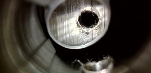

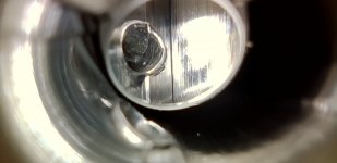

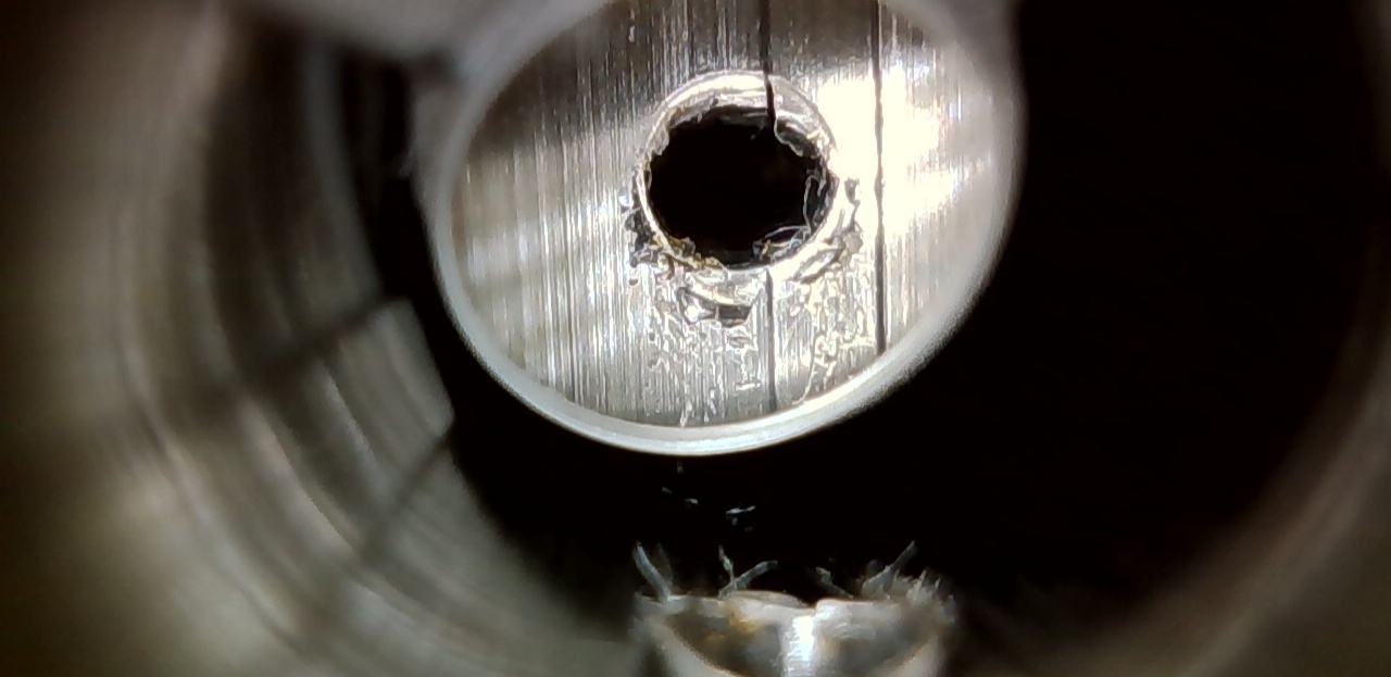

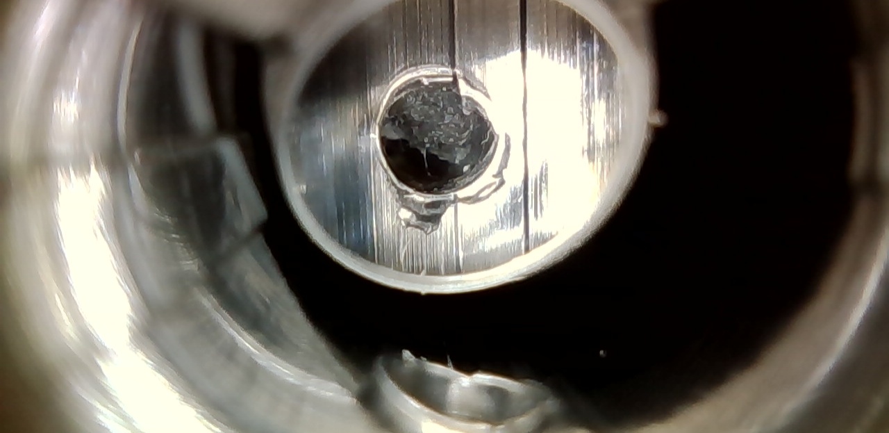

I went with a Proof 24" 1:8 twist pre-chambered 6.5 Creed Carbon Fiber barrel for an AR10 build. The 1st barrel was sent back per my gunsmith's advice. It had a rolled-over piece of steel projecting badly into the barrel and got caught on cleaning patches, etc. Bad enough to not be able to be lapped out. A call was placed to Proof, they replaced the barrel at their expense after I sent borescope photos and had the gunsmith on speaker with me and the rep at Proof. 2nd barrel was better, but still had flashing in the barrel from when the gas port hole was drilled. It was hand-lapped out by my gunsmith. The crown was checked with a gauge and was opened up by pre-threading for 5/8x24 and relieving the stress. The fix was to rebate the crown back inside the bore where the threaded muzzle began. Problem solved, tight crown. Barrel length effectively now 23.5". The barrel was epoxied into the upper after truing the receiver face, Trigger tech diamond trigger installed, JP Enterprises FMOS, Silent captured buffer system, Magpul PRS stock, adjustable gas block. Area 419 Hellfire system installed on top of a Kinetic Security Systems tuner to fine tune for factory ammo.
The problems began when trying to hand load for long range accuracy. Never could shoot more than 4 shots without subsequent shots going "Haywire". At 200 yards this morning with zero wind & mirage, the first 4 shots were all sharing one hole. Shot 5=1" due south, shot 6=@ 2" south...and so on. I clicked up a half MOA, aimed high 10 ring and blew shot 7 out the top. I let the rifle cool for 15-20 min & repeated. With the exact same results.
So, I guess the barrel would be great to hunt with or shoot "Stages" with no more than 5 shots/stage. No good for 10-25 shots at a time like all my other conventional stainless barrels. What a colossal wa$te of time & money. I DID absolutely love the weight of the rifle...only positive that I can think of. I'd rather have the accuracy.
Good lord those are some ugly bore scope images. This is the main reason I am shying away from Proof Research. I have bad luck when it comes to QC issues - if there's a lemon on the line, it will almost certainly get shipped to me. I know Proof will stand by their product, but I dont want to deal with the hassle. Thanks for the response. Hope the next build goes more smoothly.
