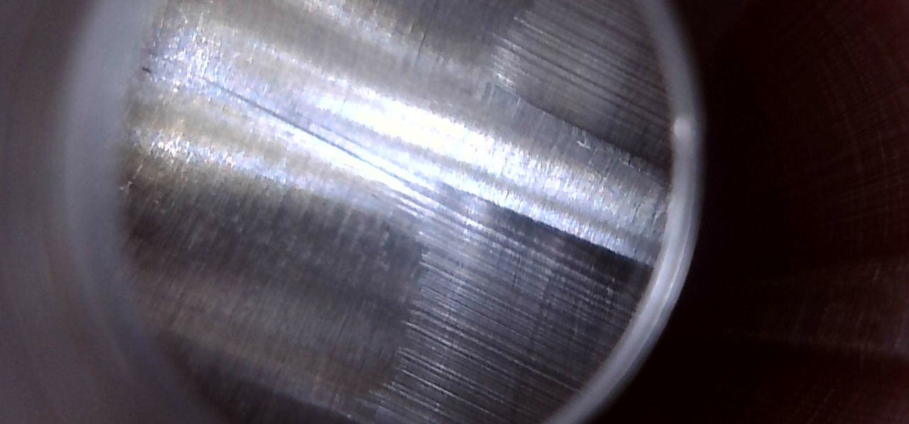

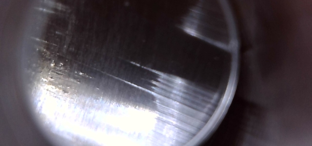

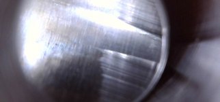

    Welp..... I ended up getting my buddy to rent me a finish throat reamer from 4D. I watched a YouTube video and went at it. I'm not sure if I want to leave it where it is now (OAL BTT, w/ 175smk) 2.791", I thought about going another .020" to get it to 2.811" OAL with a 175smk but not sure if I should?

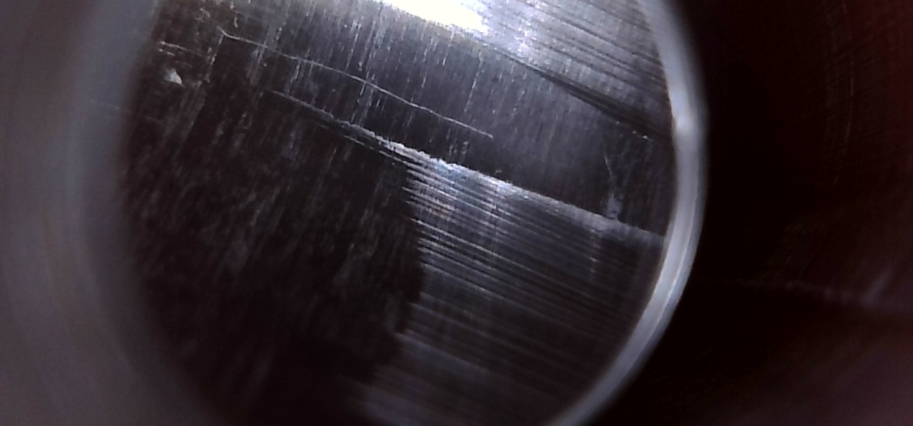

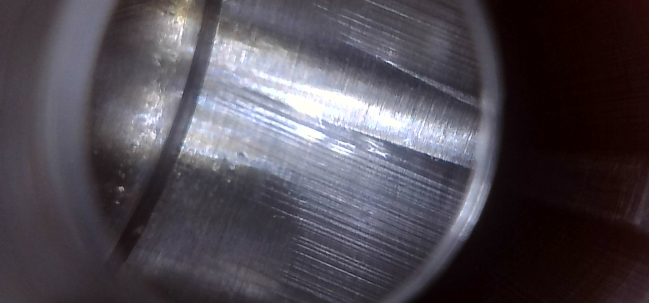

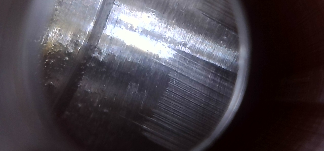

    Fortunately, he only had a chamber reamer, but he rents stuff from 4 D often and so he found and rented the uni throater for me. It came in yesterday, and I did the deed last night. Not sure if I want to go 20 thou more or not though. Also not sure how even it should look when using a bore scope. Looks pretty even but not preferably even. Though that's what all the other throats I have looked at generally look like. These pics show the biggest difference between lands and groove start/stop point, which isn't all controlled by the throat reamer of course. It can only cut what's there's already but I think it looks pretty good right?

    Correct. That's exactly what I got and it worked really well. I found the starting spot by running the nuts all the way down then went out by 20 thou at a time, just because I had so much I was removing I wasn't worried. Then I measured, and cut about 10 thou at a time, cleaned with brake cleaner, measured , re oiled, cut again..... until I reached my depth. I will probably end up going 20 though more to match a chamber that Frank Green sent me drawings for that he also wrote the OAL with a 175smk down for me on it. (Which I will share if someone needs it, just pm me). It gave me a lot more confidence to know where I was trying to go with that drawing. I didn't go quite as deep though yet, still trying to decide on that one but I probably will go 20 thou more to get to an OAL of 2.811 using a 175smk bullet. (Base to tip)

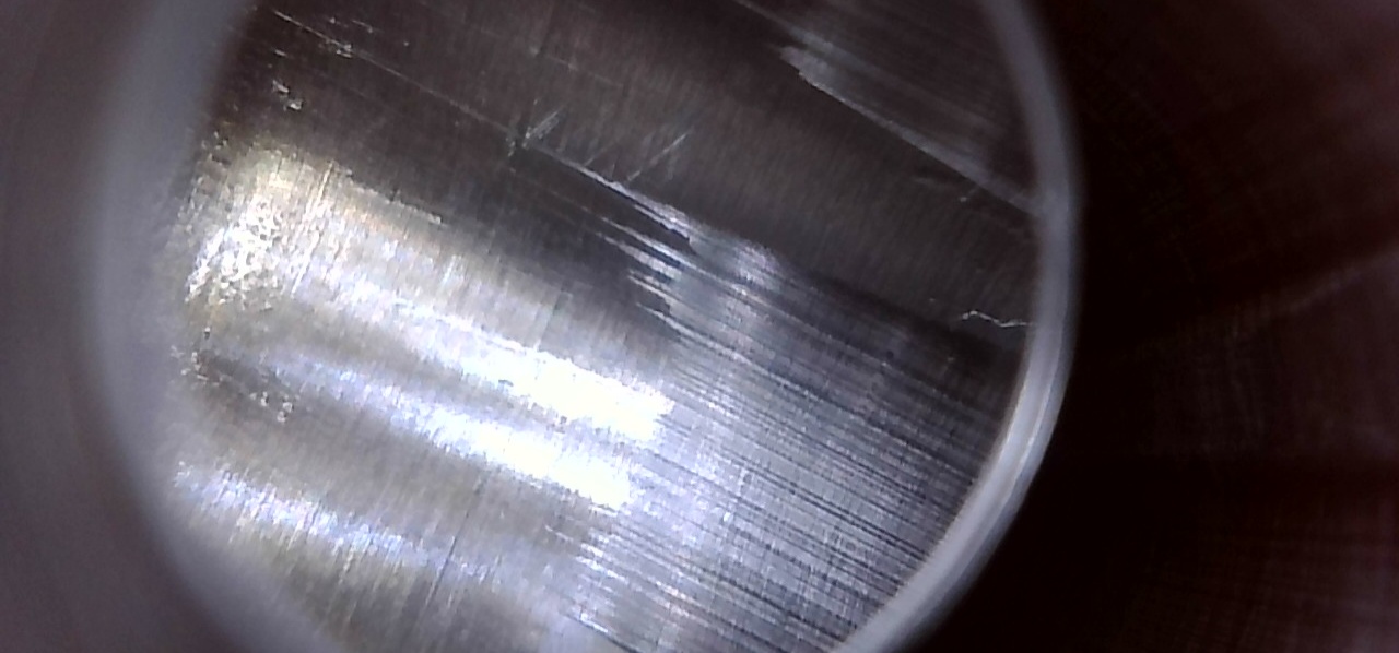

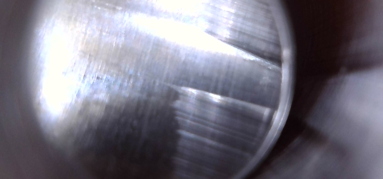

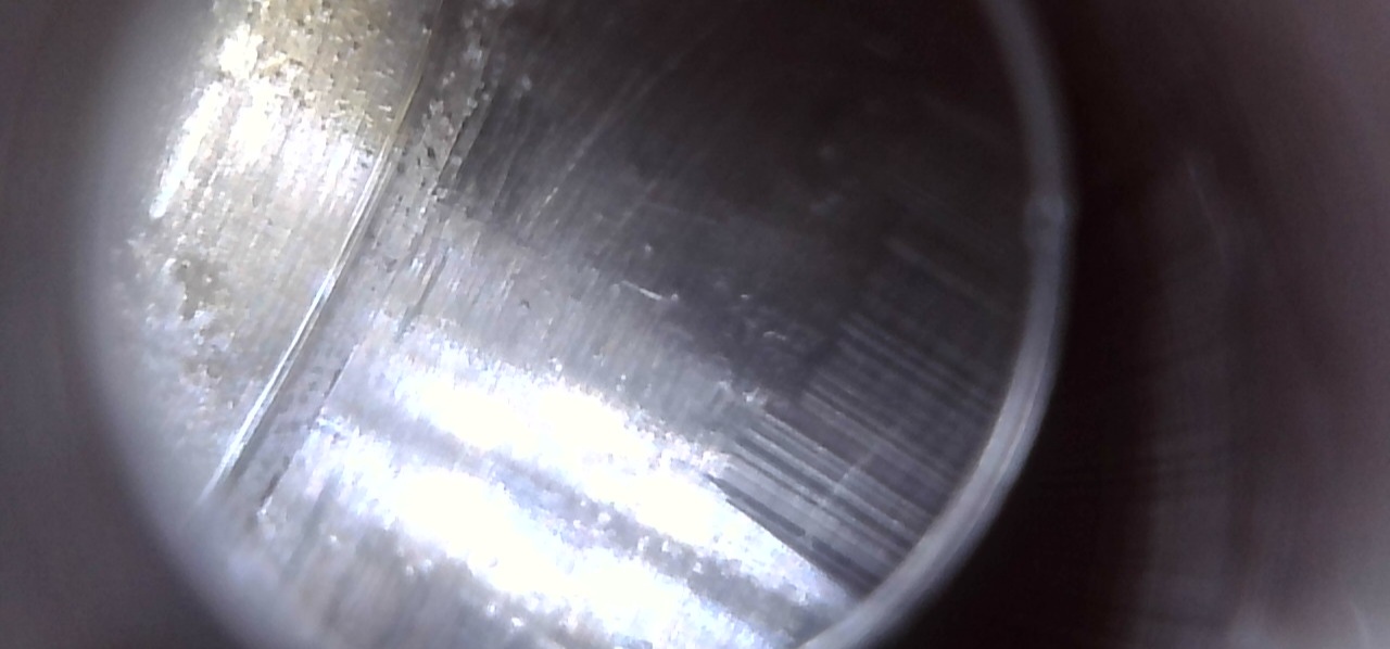

    Well after looking at the measurements on my last barrel that BMP did for me, I decided to extend the throat a little more. I also did the last of the depth a little differently and it gave me a very even final cut . I used my left hand to stabilize the handle and cut the final three times only cutting .0025 at a time. I also flushed it with oil and used a bunch of oil while doing so. I got very good results doing it this way.
    Final measurement are:
    OAL base to tip- 175SMK = 2.8350"
    BTO- 175SMK= 2.6650"( #8-30 comp)
    My other barrel was .030 longer throat but 2.811" OAL with 175smk is a size that some use when chambering so I figured right in the middle of those two lengths would be good for me. I can reach the lands if I need to but also can jump and still have good case capacity so I feel like this will serve me well. Here's pics of the final throat.
