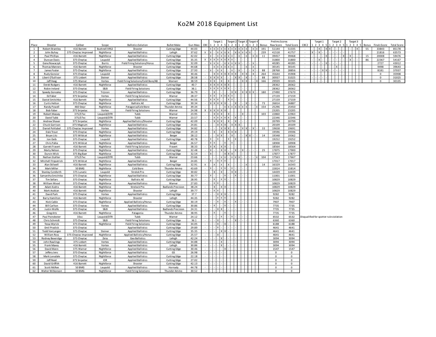

A few folks I know say the DTA’s show pressure early and can be challenging. See what JJRock or others have to offer that will build a better experience and ELR time. I would look at the 375 Cheytac before the 37XC to be honest. Here is a chart what folks shooting out to 2 miles under a time restraint and pressure used. Cheers

Jeff HeegView attachment 7029505
I noticed that none of these shooters are using trasol as their firing solution. What's the scoop on this?
Xdeano
Good question, it seems as soon as folk look at 2000 + its either Field Firing Solutions, Cold Bore or Applied Balistics that surface. Trasol has had a rough road as far as support for a few years and that is changing some now, also Trasol has a maximum range of 3500 yards.
