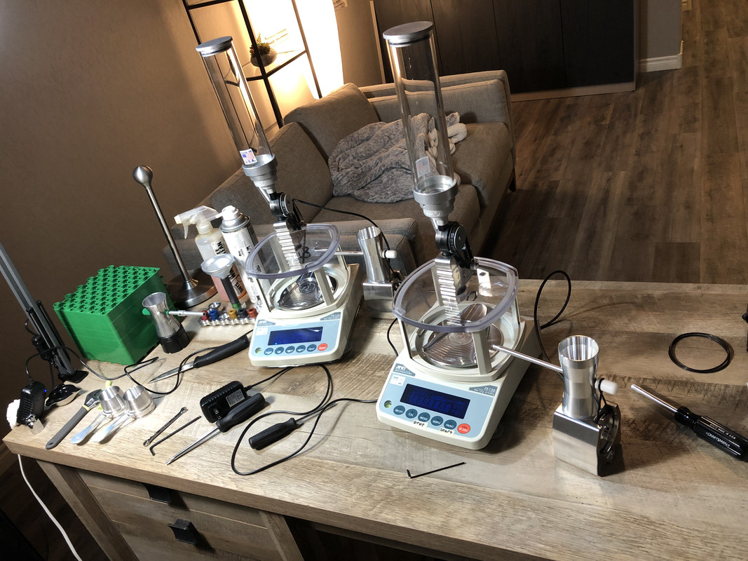

I have a rockchucker, but never really considered going to a progressive. But the slowest part of the reloading process for me is the chargemaster. Waiting 30 seconds per charge is brutal. If you are okay with the chargemaster, get another one and have two running at the same time.

If you were going to upgrade for speeding up the process, I'd go Auto Trickler>>Giraud>>AMP.
For accuracy benefits I'd go Auto Trickler>>AMP>>Giraud.
The AT will speed up your time at the bench significantly over even a tuned CM1500 or Lite. The weighing of powder will still be the limiting factor in your loading timelines, but it's so fast that it'll probably dump a charge as fast (or faster) than you can seat a bullet.

The auto trickler would be my next upgrade.

How much brass are you planning on loading? I'd start with the V3 regardless, it's a game changer.
I currently reload in batches of about 50-150 per session right now and sometimes less if I’m splitting my attention. If I’m prepping for a match I’ll do about 250 rounds of the same load but broken up because of how long it takes.
The powder drop is the single longest stage in the process. I’d vote AT and after ya got all the stuff you need, get 2. It’s even faster.
Thank you. I was leaning towards that being my first upgrade. The Chargemaster and I have a love-hate relationship. It has the straw mod, is reprogrammed and has the slick Area 419 upgrades. Some days I’ll over/underthrow about 12% of the charges and others it’s closer to 30% which adds a ton of time.
I think I’ll be going Autotrickler-> Giraud->AMP -> Dillon if I still feel the need

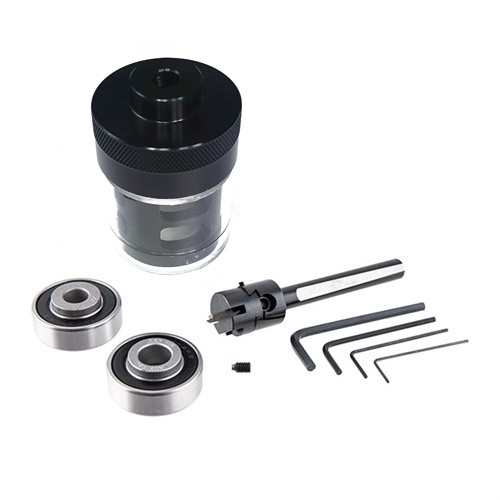

I too am looking at the giraud trimmer, but I think I'm leaning toward a trim-it2. Being able to change the bushing when changing cartridge families. Otherwise, you're buying whole trimmers. I dont mind adjusting the cutter a bit.
Yeah, but the trim-it doesn't chamfer IIRC. You'd still need to do that after trimming. The Giraud does it all at once. As to dies, the Giraud is the same. Some dies work for multiple cases, based on the shoulder diameter/angle.
The 2 has a 3 way cutter head, per their website.
I reload 223 and 308 mostly, so the giraud would be more expensive. I'd just chuck it in my drill press either way.
I dont have either setup yet. Just commenting to bring up another option
It does a three way, youre thinking of the similar worlds finest that is trim only.
When you change a bushing you still have to adjust it to the correct length with the trimit2 by the rough adjustment and then the finer micrometer once youre close.
And youll need to adjust the cutter blade if your new bushing isnt for a chambering of the same caliber. You only have to adjust the cuttter blade when you change calibers, different chamberings of the same caliber would not require adjusting the blade and only the bushing.

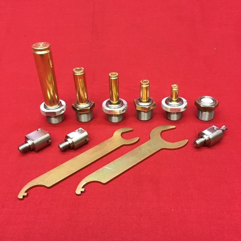

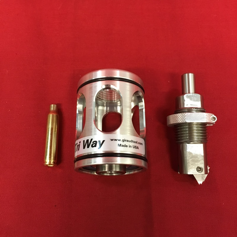

The same thing applies to the giraud sort of, you could use different triway bodies instead of the bushing on the same cutter with all the same caveats have each having to be adjusted to the correct length.
The trimit2 and the triway are basically the same thing, the trim it2 just one has the body adjust with a seperate bushing where the triway has the body act as the bushing. And if you change something there really isnt a quick reference to get back with out having to redo the whole set up, especially if you change the caliber the cutter is set for.
The giraud benchtop is a different beast. It has the case holder bushings but with a lock ring it can be reinstalled into exactly the same position with no adjustment. Then you can get individual cutter blades that you can swap calibers quickly with out having to adjust. Once the benchtop set up is set it can switch and swap and never have to adjust anything for repeatable results.
You can get dedicated bodies, bushings, cutters for the trimit2 and the triway in an attempt to replicate but by the time you do and invest in all that youre better off just buying the giraud benchtop.
I see. (I just watched the review of the Trim-it II). So, if you're only shooting one, maybe two cartridges, I could see that being useful. Where the Giraud shines however, is the entire cutter head can be swapped out, so you don't have to constantly adjust your cutter between different calibers (consistent repeatability). With the Giraud, you can have multiple cutter heads set up for different calibers that can swapped out when the case dies are swapped out.
For example, in my case (no pun intended) I have a .22 caliber cutter head, but have .223, .224 Valkyrie and .221 Fireball trim dies. Same with 6.5mm (grendel, 6.5x55mm, Creedmoor dies) and .308 (.308Win, 300BO dies). When I swap, I get the exact same trim and chamfer I had the last time I had that die/cutter combo inserted.

Giraud and don’t look back.
Time is valuable. If you want Precision without tinkering or wasting time, get the Giraud. If you don’t mind tinkering get the trim it or any of the other drill attachments
Takes me maybe 2 minutes to switch calibers chamfers deburs and cuts precise.

Yep. Semi- annoying to get the initial position for the cutter, but after that, it’s easy.
I put lock rings on all my pilots and have a cutter head for each casing.
That's a fair point. So basically, skip the triway and go straight for the bench top. I'll definitely check deeper into this before I make a final decision.

V3 Autotrickler and Autoloader... The precision of the powder charge will have a significant result. And it is significantly faster than Chargemaster. I can reload 50 rounds from primers to in the box in 40 minutes.
