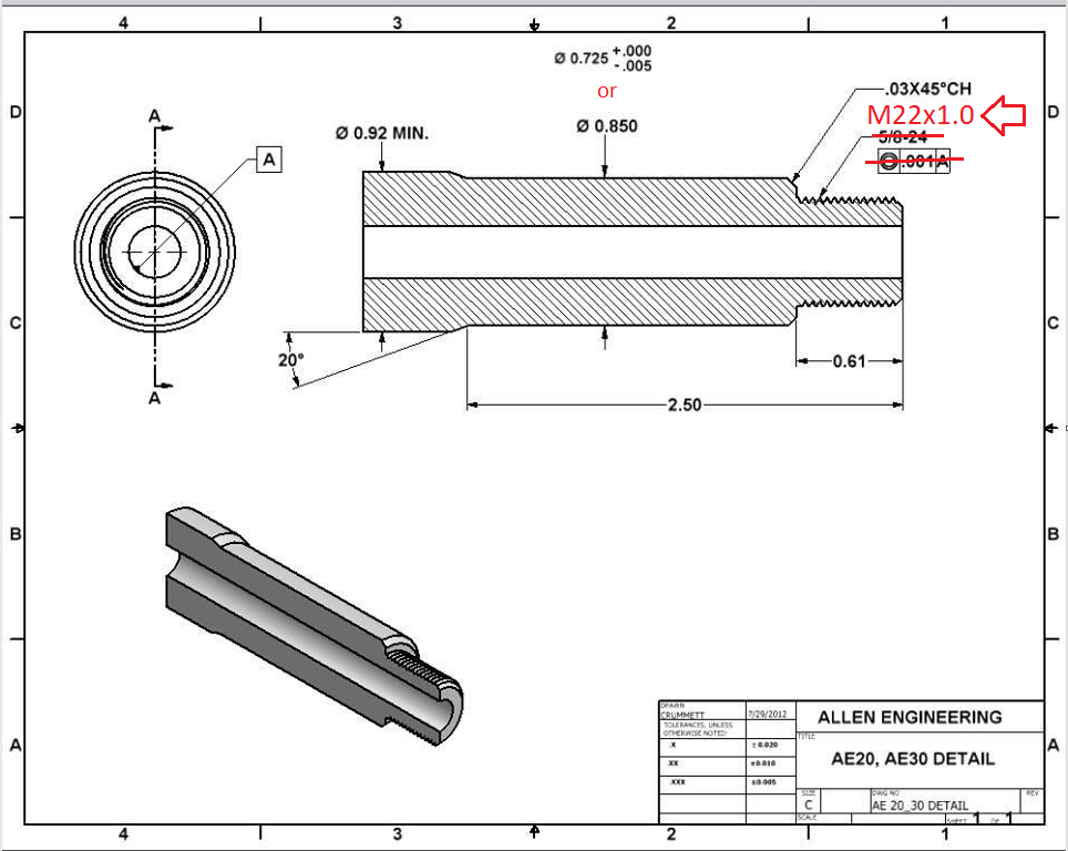

That thread literally has the prints from Allen Engineering.

Taper to muzzle shoulder is easy math you could have done. 2.5” from taper start to muzzle end less 0.61” call out muzzle thread.

The AE30 print IS the print to mount the AEM5 without a collar you fucking jackass. The threads on the outside of the brake would then occupy the area of the muzzle thread. You’re a moron; God bless.

The 5/8x24 to M22x1.0 is what you would change on the print. If you leave the barrel diameter forward of the taper at 0.850 you should be fine since the M22x1.0 threaded muzzle would be larger in diameter (22mm or roughly 0.866 inches). You can step down to the 0.725 or so if you want to more closely match the MK12 SPR barrel contour.

bringing this back up.... is the internal thread of the AEm5 actually the m22x1.0 metric thread? why did i think it was 1/2x28? i guess to keep someone from threading it on a skinny barrel with the 1/2x28 thread and no rear collar support.
You were probably thinking of the muzzle brake in the 2 piece system (muzzle brake + collar) that normally threads onto a 1/2x28 threaded barrel. That brake has outside threads that are M22x1.0 which the suppressor itself screws onto. When you cut the directly onto the barrel, you can forego the muzzle device and collar.
2 piece setup -
Machined shoulder for collar → Rear Tapered collar → muzzle thread 1/2x28 or 5/8x24 → muzzle device 1/2x28/M22x1.0 or 5/8x24/M22x1.0 (internal thread/external thread) → AEM/OCM Silencer
Cut direct onto barrel -
Machined Rear Taper → muzzle thread M22x1.0 → AEM/OCM silencer

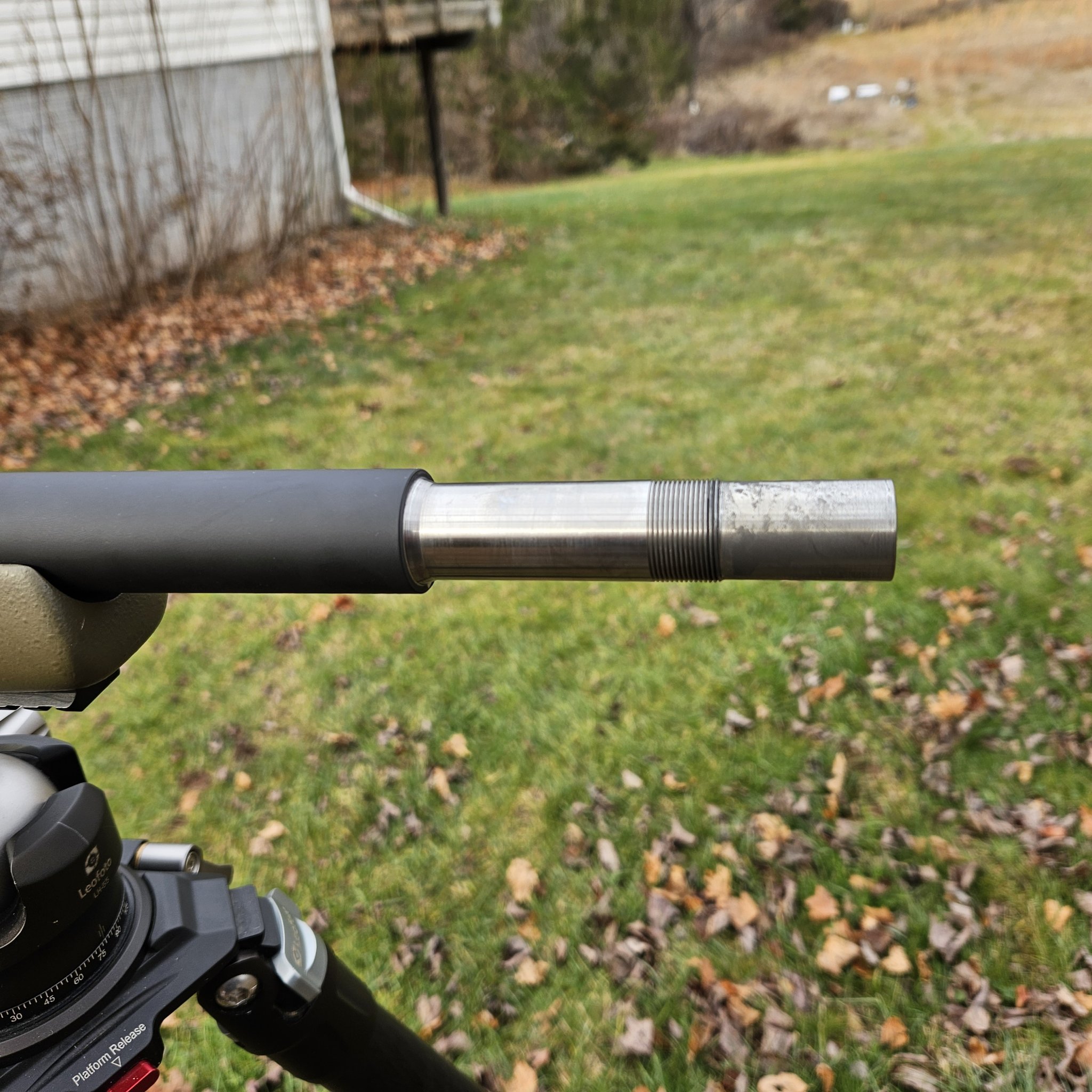

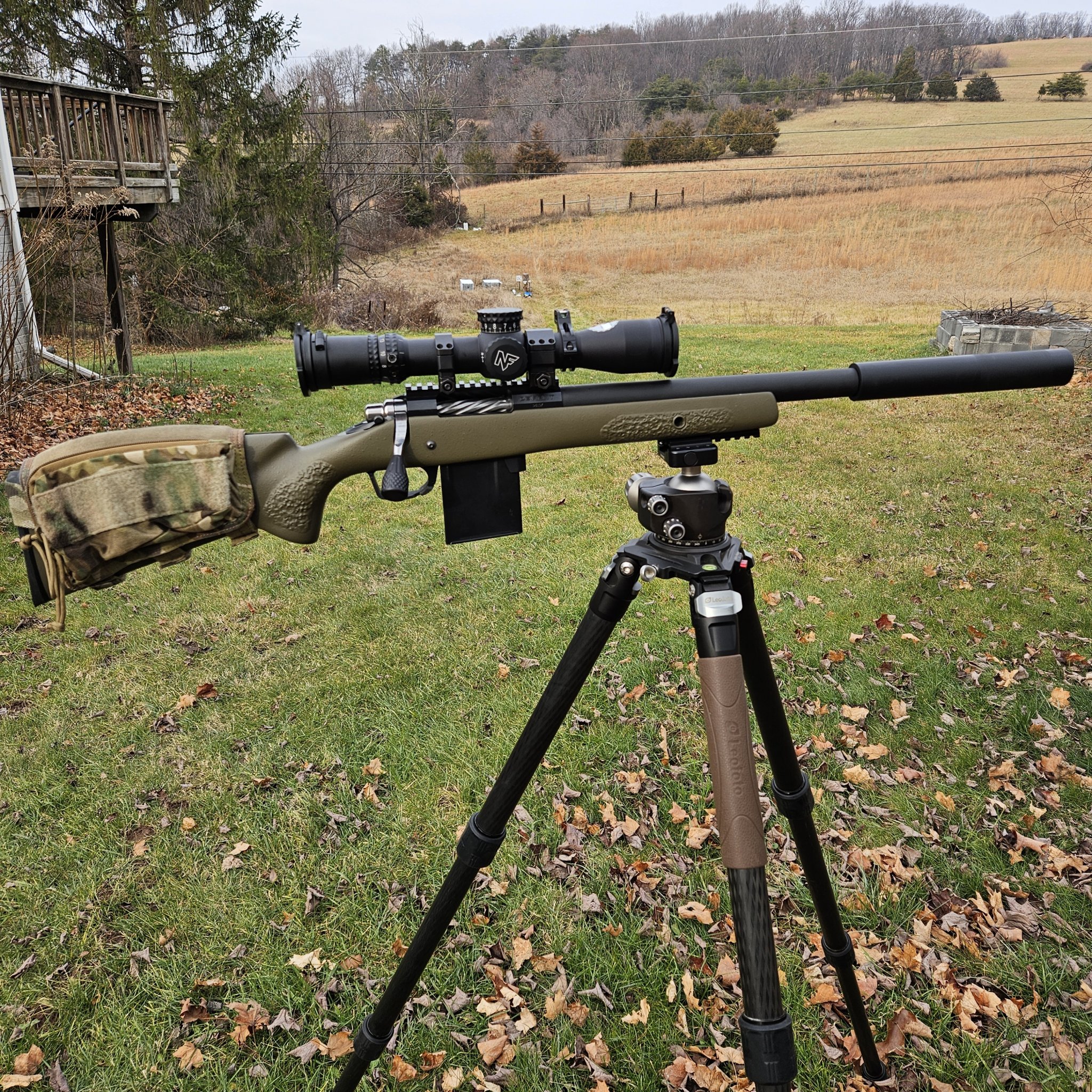

Ryan Beck of Base Camp Customs did a custom CNC program for mine to maximize barrel length. I'd highly recommend him
Yeah you hooked me up with him. Had it in the works since last year. Just was looking at the spec right now
Jzerfoss, Can you tell me barrel profile and length at the m22 threads?
After or before the m22 threads? From the taper to the start of the threads is 1.906" long and .862" diameter. The end of the threads to the muzzle is 1.3" long and .81" diameter.
