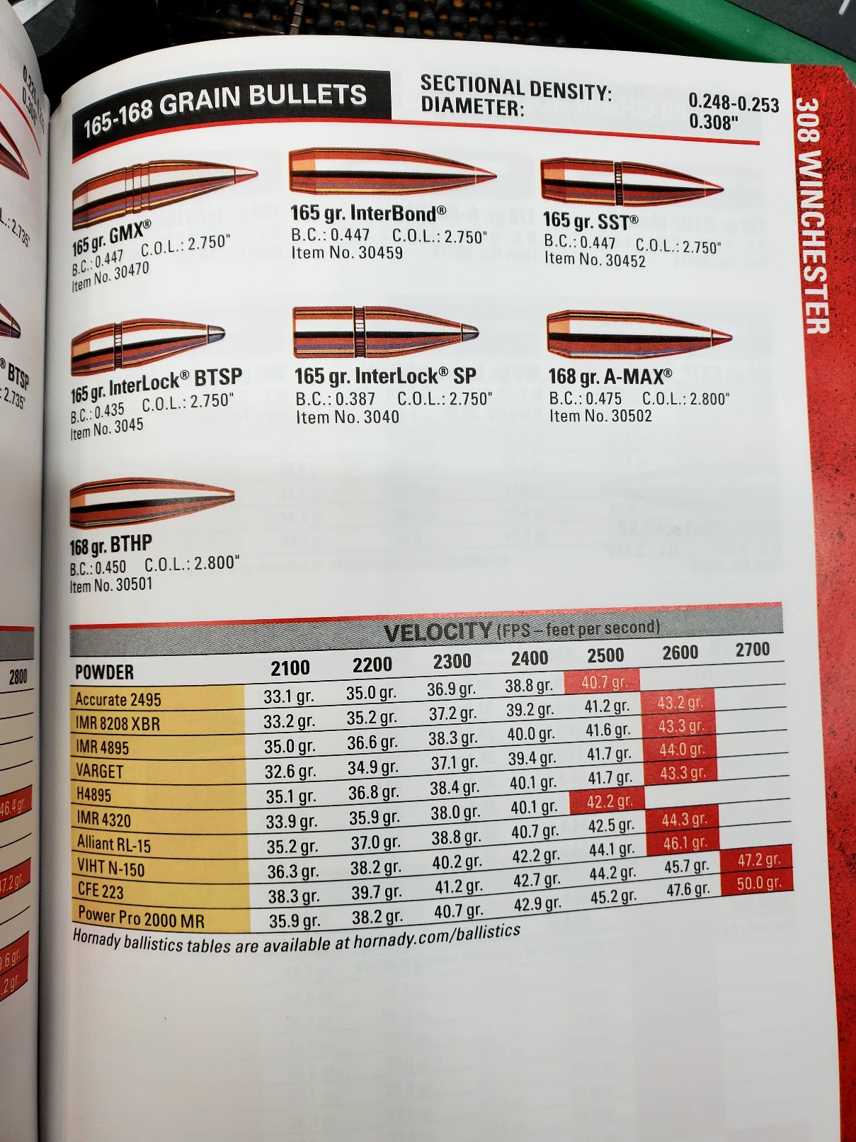

D Daily Driver Private Minuteman Mar 20, 2022 3 0 Rhode Island Mar 20, 2022 #5 Mar 20, 2022 #5 Was looking at developing a load based off of 165 sst and imr 4895
2aBaC̶a̶ Humans are amusing Full Member Minuteman Jan 27, 2019 6,054 7,498 I Da ho Mar 20, 2022 #6 Mar 20, 2022 #6
918v Rapper on benefits Full Member Minuteman Jul 15, 2007 10,358 10,910 Miserable CA Mar 20, 2022 #7 Mar 20, 2022 #7 Daily Driver said: Was looking at developing a load based off of 165 sst and imr 4895 Click to expand... In what brass?
D Daily Driver Private Minuteman Mar 20, 2022 3 0 Rhode Island Mar 20, 2022 #8 Mar 20, 2022 #8 918v said: In what brass? Click to expand... Lapua
918v Rapper on benefits Full Member Minuteman Jul 15, 2007 10,358 10,910 Miserable CA Mar 20, 2022 #9 Mar 20, 2022 #9 Then reduce Hornady data by one grain at least.
