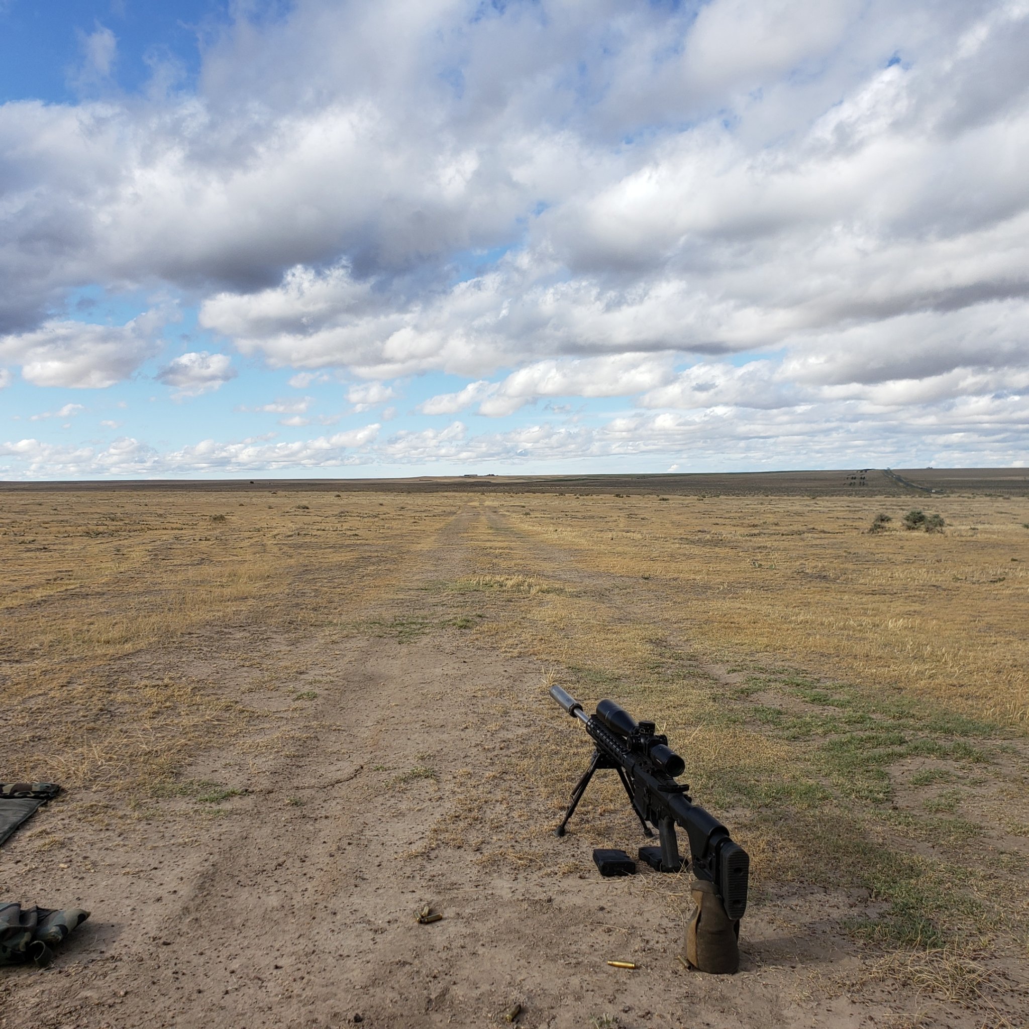

I was attending a DM class and built a new rifle in preparation.
Aero upper, lower, and BCG. Geissele SSA-E trigger and a Criterion 6.5 barrel. The suppressor is a Form 1.
Handloads with Hornady brass, Winchester LR Primers, H-4350 (41grn), Hornady 140 VLD-M (2750FPS).

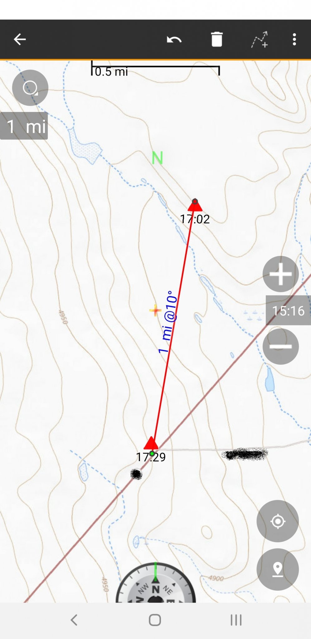

Overall I was extremely happy with its performance and its reliability. Over 5 days and about 700 rounds I had 3-4 rounds fail to go all the way into battery but it was near the end of the day shooting suppressed all day (cleaned nightly). During our time on the long-range I was thrilled to get the chance to shoot at a mile. My calculator got me to within 3MILS or so and I took 3 rounds to get my dope. Then out of the next 10 rounds I had 5 hits on a 19"x28" steel. There had been a good 10-15MPH wind all day but it was just starting to settle down a bit (5-10) when we did the mile shots.

Looks like a fun day you had there. Nice shooting eapecially with the 15 mph wind. I love the ssa-e trigger.

Well shit Brother, post a closer/bigger pic of the rifle, sounds legit.
