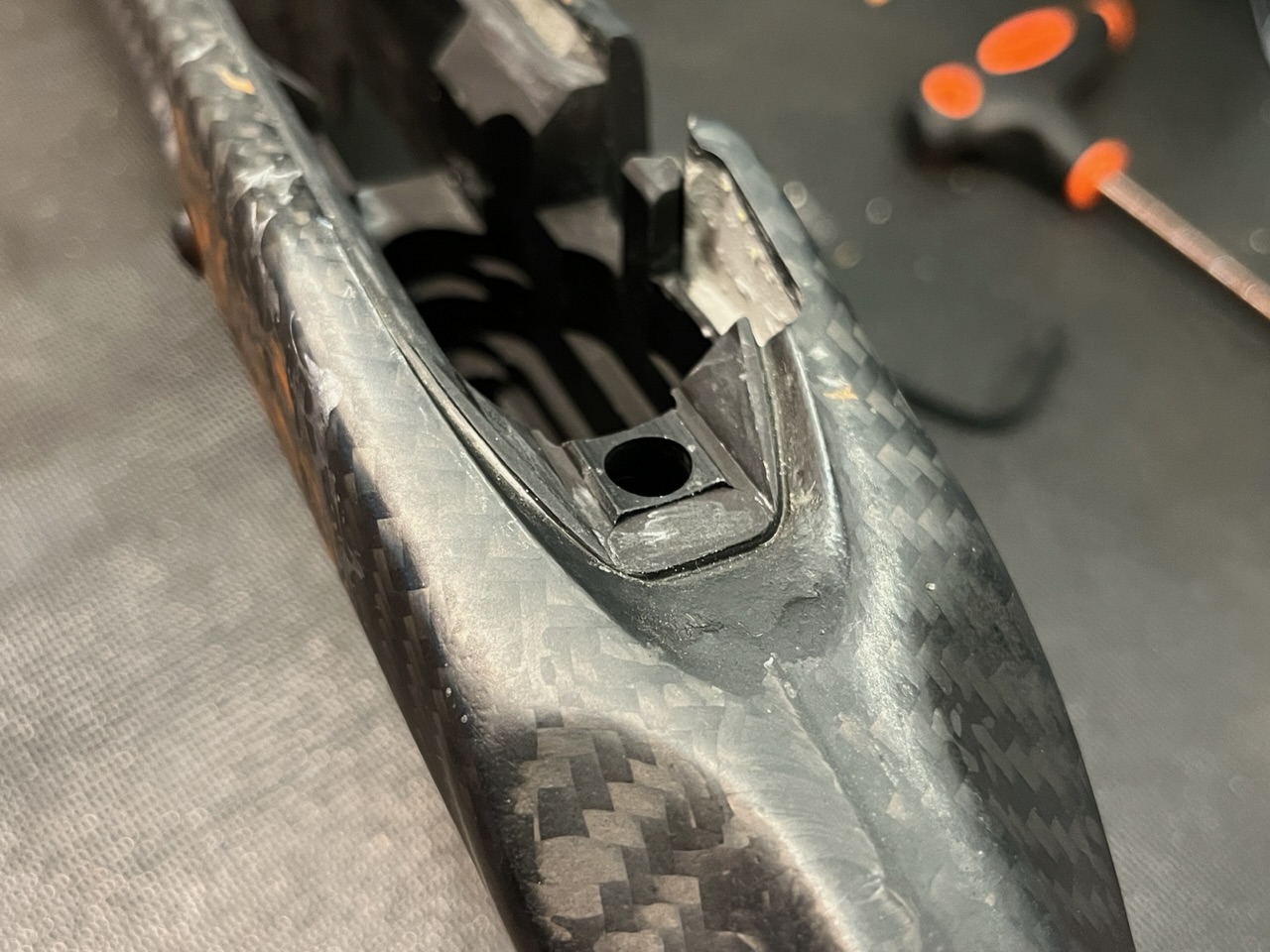

Anyone run an Aero Solus in a Manners TCS stock? If so, drop right in and work well? Set mine in a TCS, rear tang portion behind rear action screw does not make contact with the stock. Looks like rear tang in front of rear action screw does make contact.

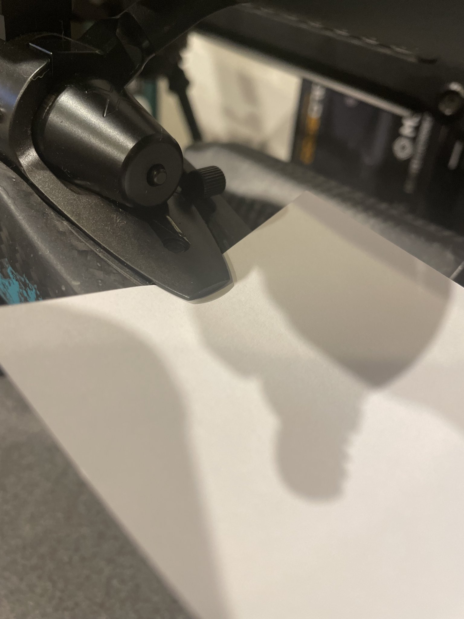

Hmmmm, checked my RimX in its tcs, same deal.

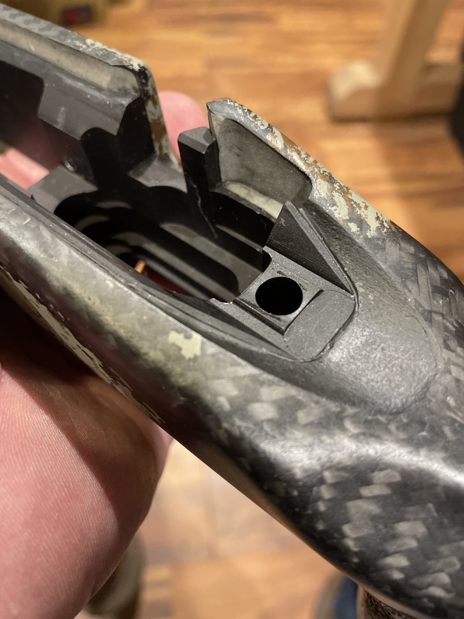

Does your chassis have the raised section around the rear screw hole for that to make some contact on without risking bending the rest off the action besides that screw point for solid contact elsewhere?
Reactions: ClayH1994

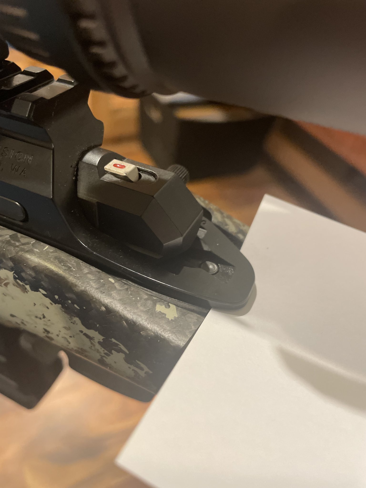

Yep, I have the same elevated pad. Just never noticed the gap before. Makes sense tho!
