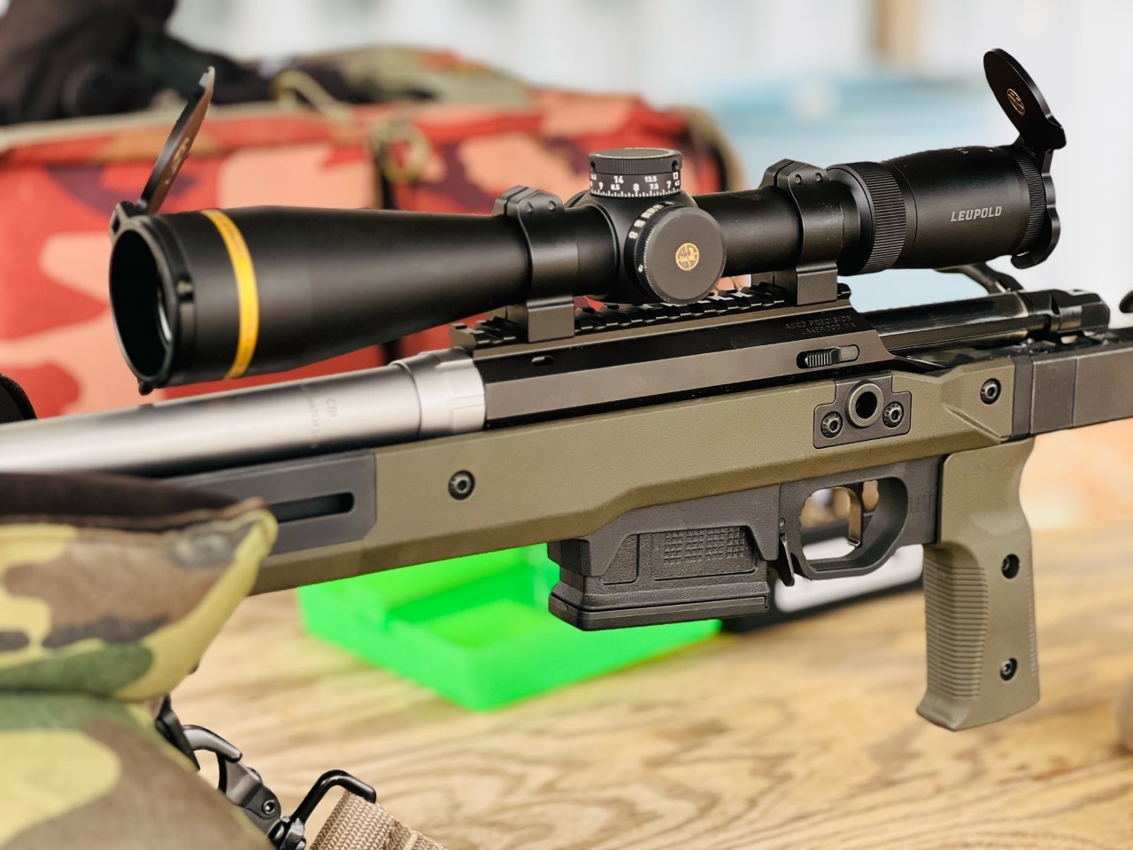

    Got the SOLUS to the range today. It was a range trip full of firsts!
    First time building a rig with these components:
    SOLUS action
    CBI 26" .243 AI barrel
    Magpul 700 Pro stock
    TriggerTech 700 Special
    .243 Lapua brass
    88gr Hammer Hunters
    SOLUS:
    It operates smooth, 100% feeding from the AICS mag, ejectors send brass zinging at 3:30 about 5 feet! :D I started catching them so I wouldn't ding my newly fireformed AI brass! The little darling just impresses with feeding and ejecting so I'm hard pressed to find anything I don't like about it! Finish is nice, bolt throw short and it's got that nice chambering sound a bolt gun should have. Fits the Magpul Pro stock nicely. So, I guess I'll get onto the other things!

    Magpul 700 Pro Stock:
    I didn't think I was going to like it as much as I do. It is a solid feeling piece of kit! It has full adjustability of everything one would want. No flimsy parts here that's for sure. The grip is adjustable to your trigger finger length with solid hash reference marks. No problems getting that 90 degree to the trigger finger placement. The only gripe I have is the front end is heavier than I think it needs to be, but if you are bipod, shooting from a rest, no worries. This gun set up for varmints and yotes, shooting off a stable position. The folding stock is really handy and locks up tight in both positions.

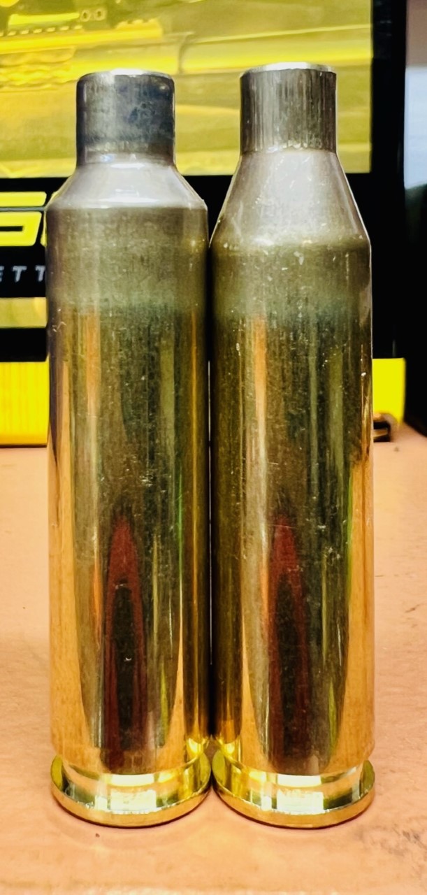

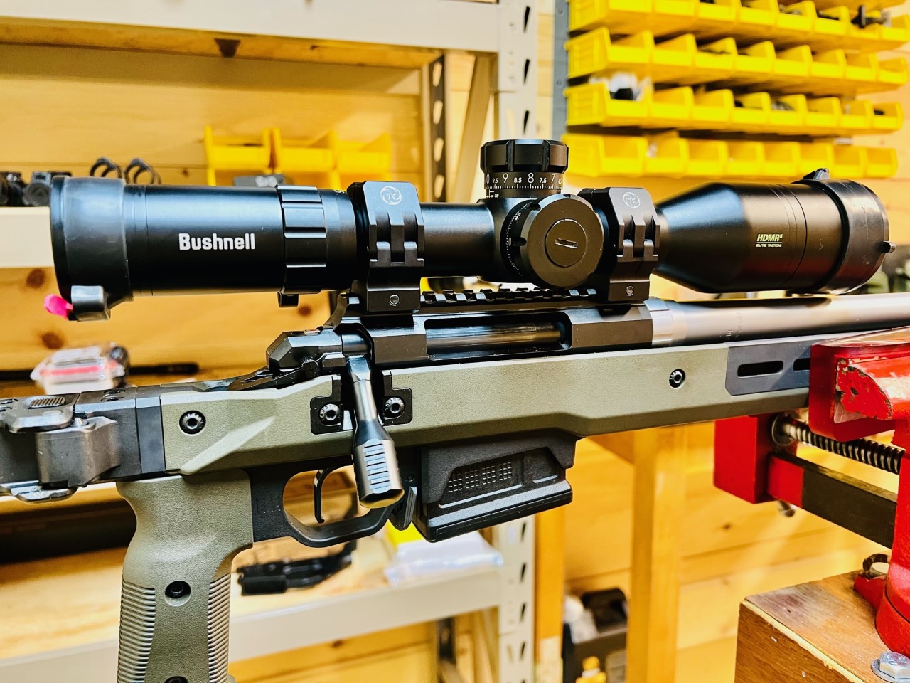

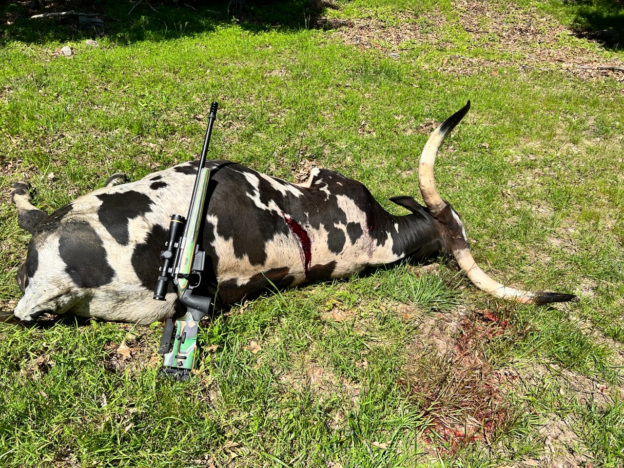

    4 months in. I've shot the action in an MDT TIMBER, M700 Pro, and now Aero 17" Chassis. Currently sporting a 22" Bartlein CF Origin prefit from Southern Precision Rifles. 243AI and 308. ARC mags, and Magpul AICS been great, even with 243AI shoulders. I really can't find a con to the action. I do wish the stock folded. Current hunt rig config:
    Dropped an “Ankole-Watusi” longhorn in 308 mode. MDT TIMBR Chassis:

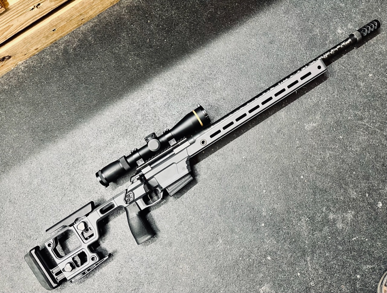

    What do you think of the Aero Precision chassis?
    Sleek. Is the first and best word that comes to mind. I like the push button snap adjustments for cheek and LOP adjustment. The butt pad assembly has some wobble that I plan to fix with some JB weld. I found a tension screw for that butt pad wobble under the bag rider. The grip, I would prefer a little more meat up top. Would like a folding stock version. First world problems! :ROFLMAO:

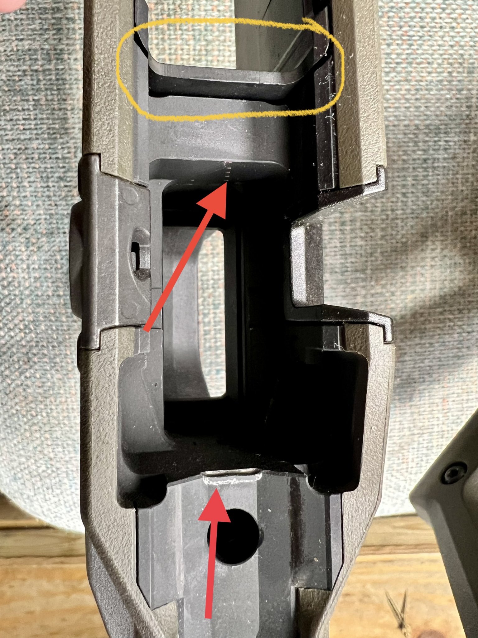

    @VAL62 Update:
    Took a hard look at my SOLUS sitting in the M700 Pro. Though it was shooting lights out, the SOLUS trigger hanger does not properly fit the M700 Pro. Reference pic:
    Yellow area would need to be cut out to fit front of action. Rear red arrow area would be too drastic a cut to make.
    Just wanted to correct my mistake and keep putting out valid info.
    I would drop the SOLUS into a SOLUS chassis.

    Well that’s disappointing. All your above posts did not reflect your latest info. I was worried about trigger hanger not fitting but now even the action lug needs to be modified!? I was under the impression that the Aero Solus was a Remington patterned action or is it Magpul‘s M700 Pro chassi? 😵‍💫
    No shit. That is why I made the correction!
    A non-trigger hanger 700 footprint, like my ARC Nuke, fits the 700 Pro with no interference. (Yes, after the SOLUS discovery in the 700 Pro, I went digging at all my actions and chassis fitments. All good in the armory now. If you still want any advice from me, I would recommend the SOLUS chassis for the SOLUS.
