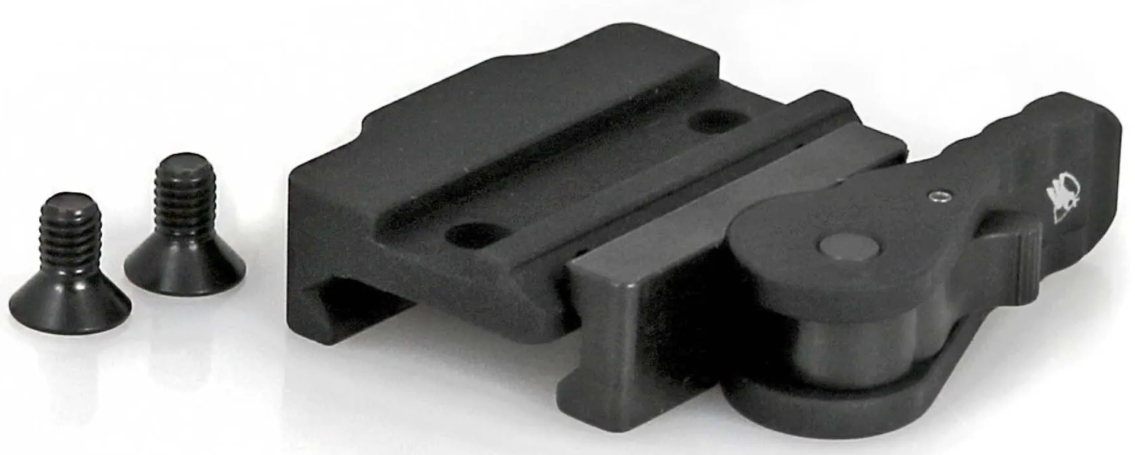

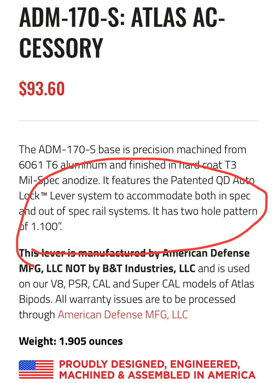

This is the screw hole distance shown on the ADM-170-S, which Accu-shot specifies fits the Super Cal:
1.100” center to center.

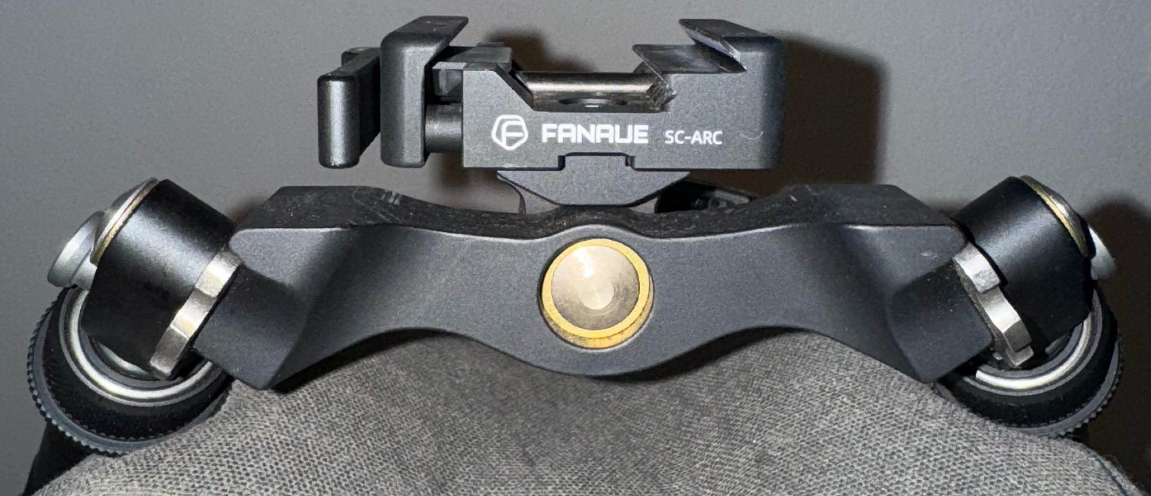

I chose to use the Fanaue SC-ARC since it will work with both Picatinny and ARCA rails. This allows me to use the mount on different rifles. Note that there's no lock on the lever. So you must make sure that the tension is correct and check it from time to time.
If you want a locking Picatinny mount, you can order the ADM-170-S from BT, as others have mentioned above.

Hello, thanks for the advice.
I think that the bi-standard adapter are the rigth choice!
