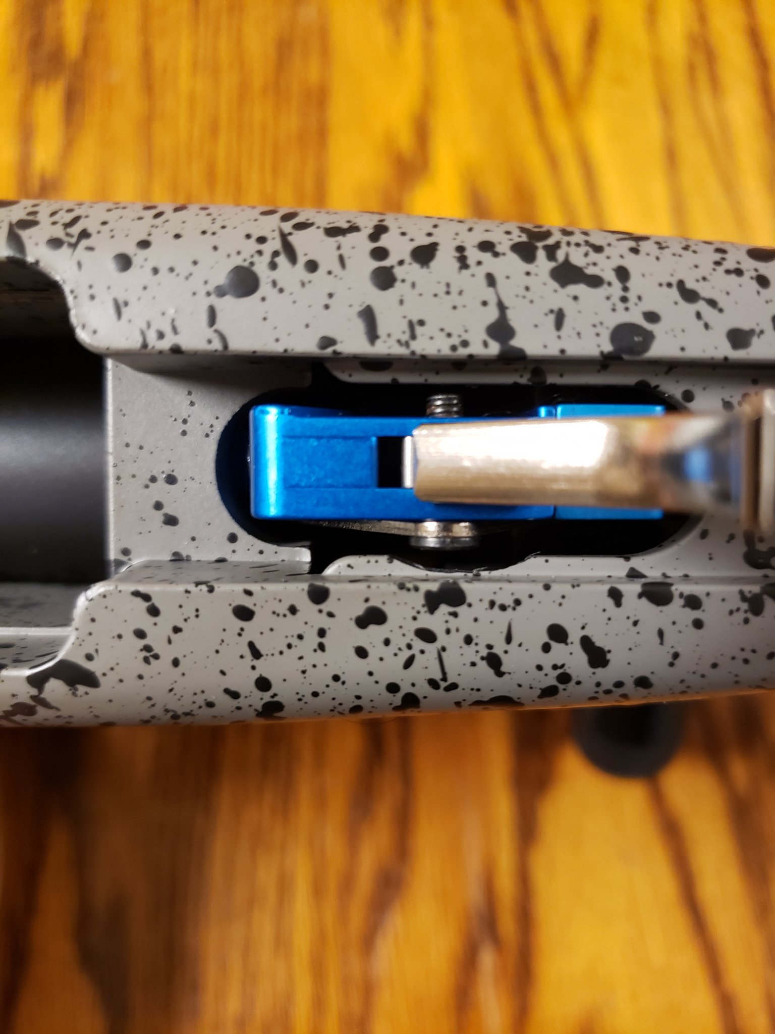

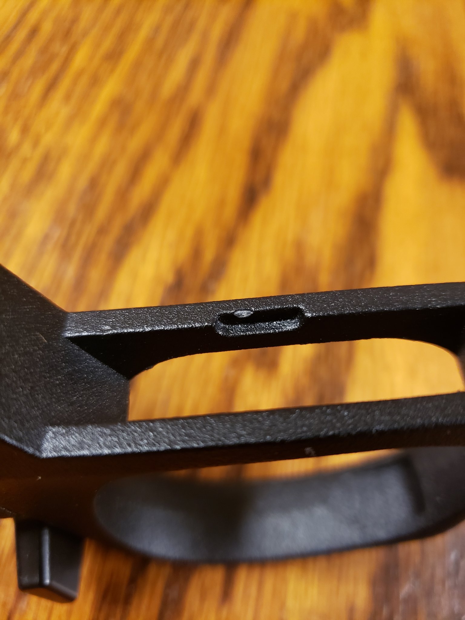

Timney Calvin Elite 2 stage, didn't work without clearancing the stock and bottom metal.
When assembled it torqued the action to one side.
