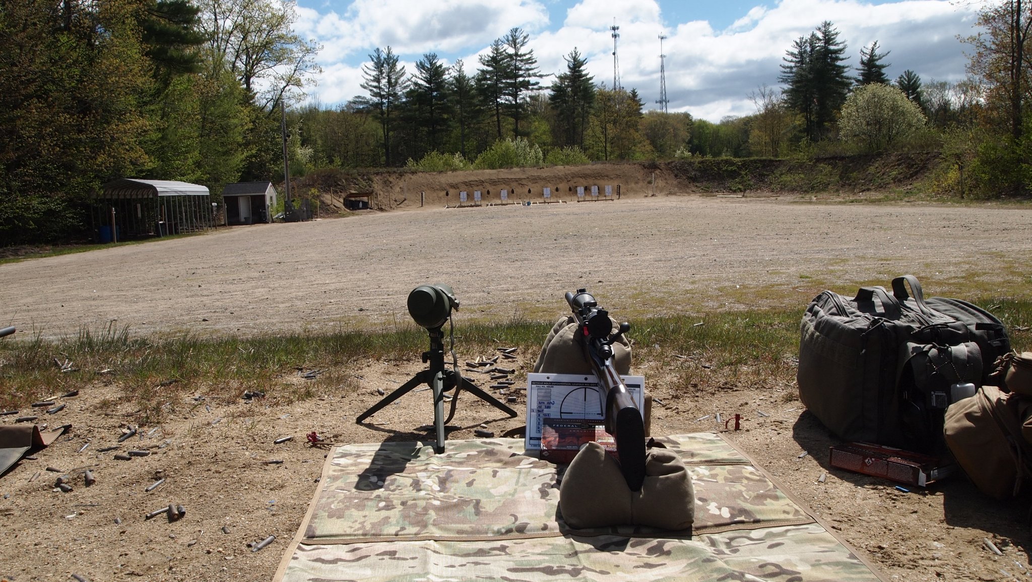

    Reach for 1000 Class at Sig.
    Going to shoot an old school .308 with SFP scope and capped turrets. Hoping to go to 1000 shooting a simple 5 mil reticle.
    Age of corona virus....reports direct to classroom.
    Im early because there is no better time than morning.

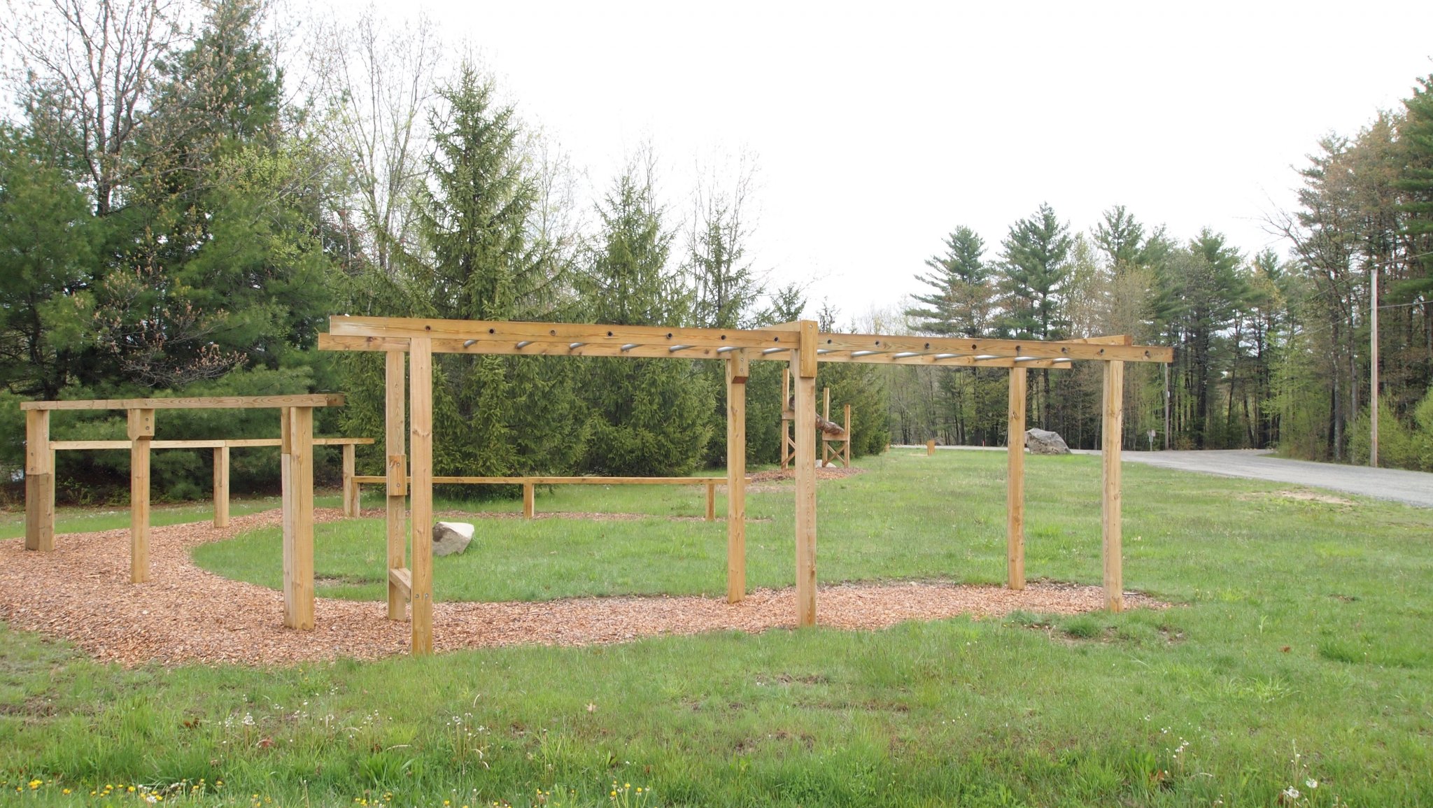

    Looks like Sig is building out there "O" course and incorporating some physicality into their classes. May have to try one of those....
    Think there is another Hider attending this class.
    Lunch break. We made it out to 750 before stopping.

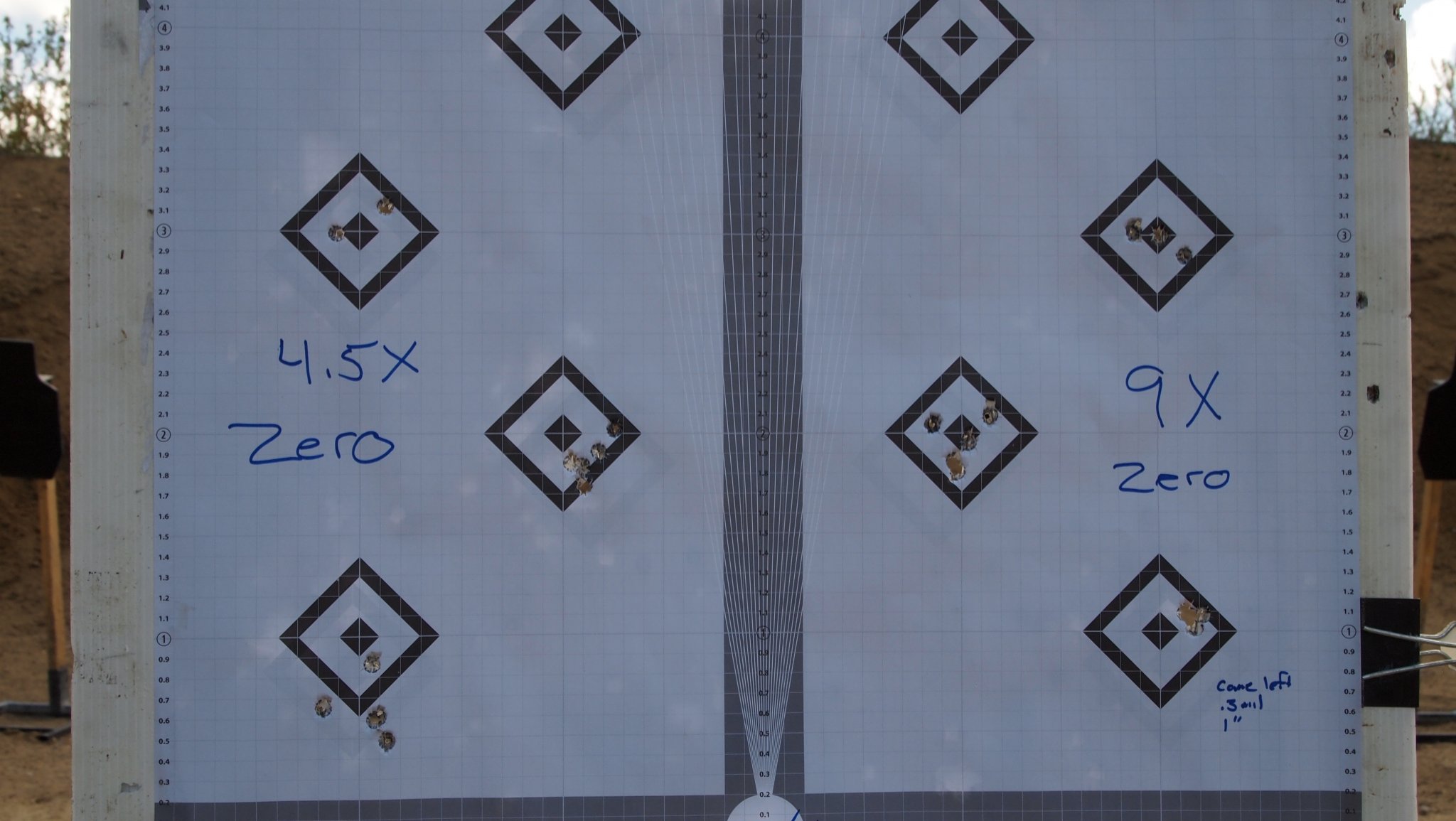

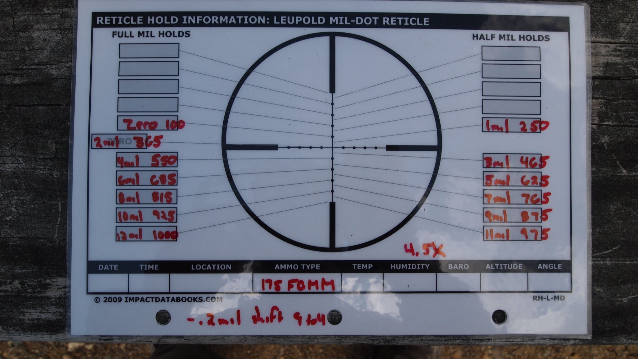

    100 Yard initial zero using a 2 mil hold under....
    Those were shot at 9X full magnification.
    Im using a M40 clone but cheating with a Leupold that has a mil dot reticle....
    Down range....
    My end 100 yard zero.

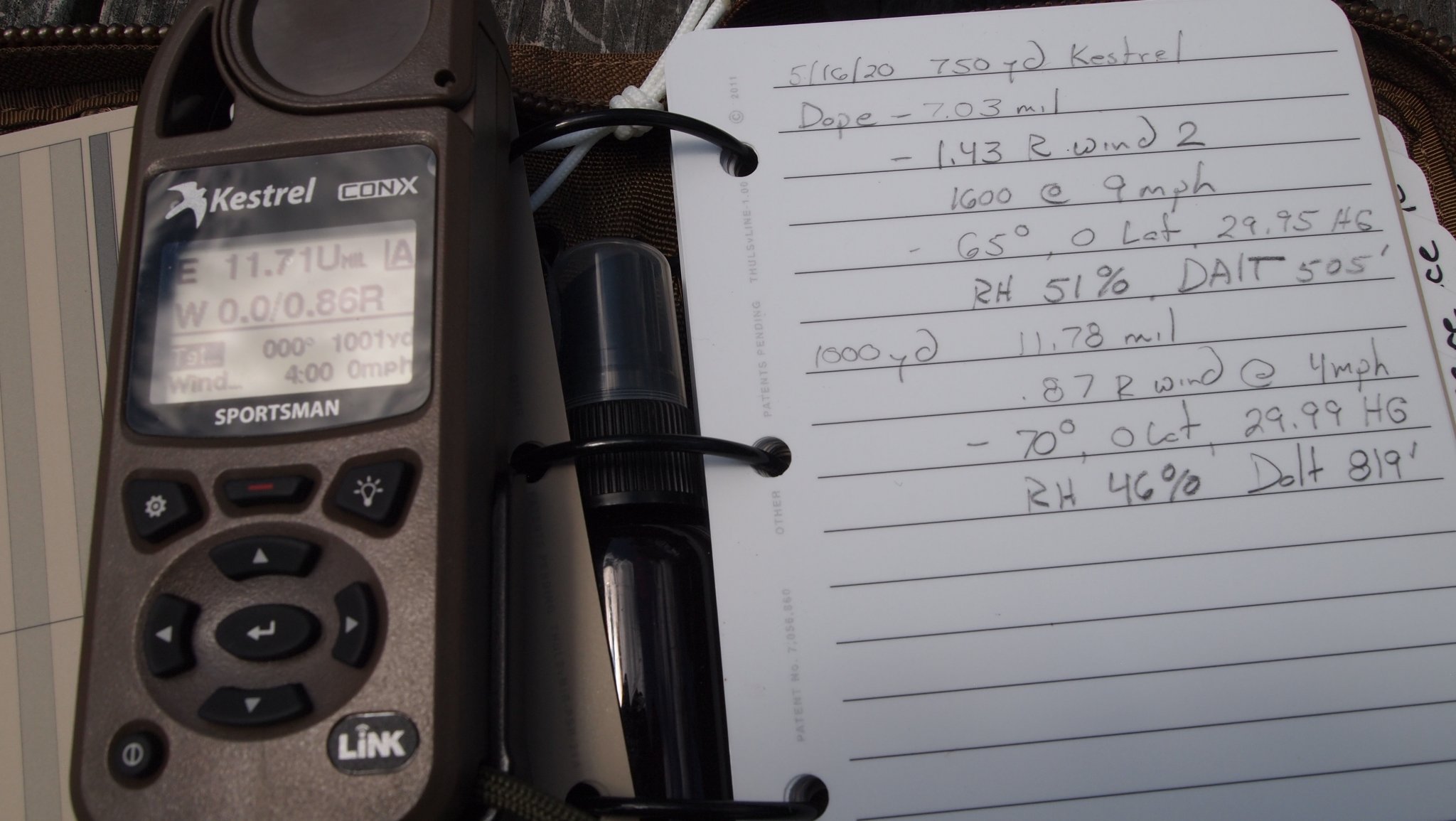

    I can get 7 mils of reticle hold at 9X. 750 yards per Kestrel and actual shooting was 7.03 mils of hold.

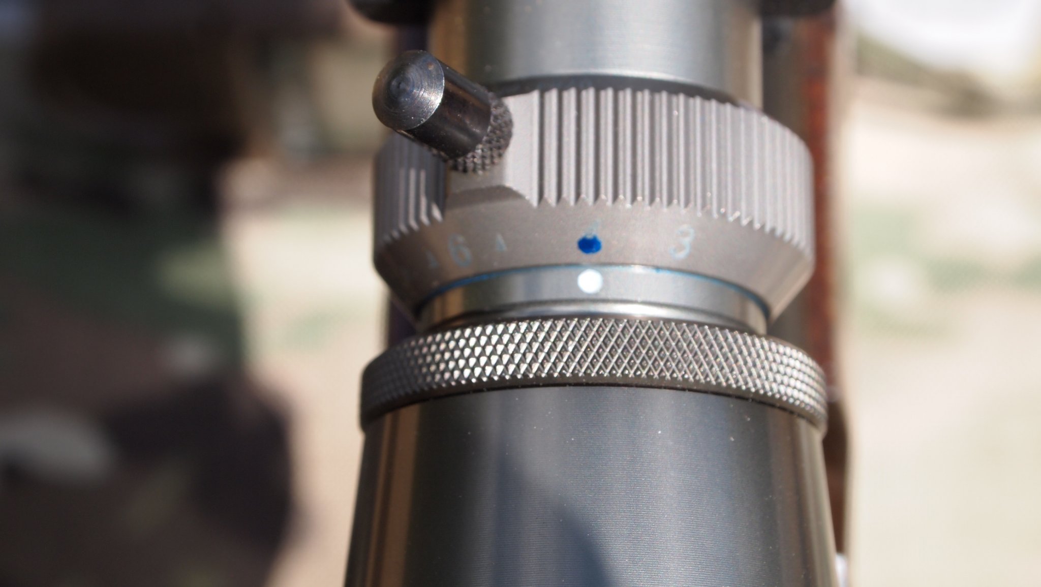

    1000 after lunch. Ill have to mag down to 4.5X. Going to be a challenge. The metal butt plate M40 packs a punch too once you get beyond 40 rounds. Collar bone will have some new colors tonight

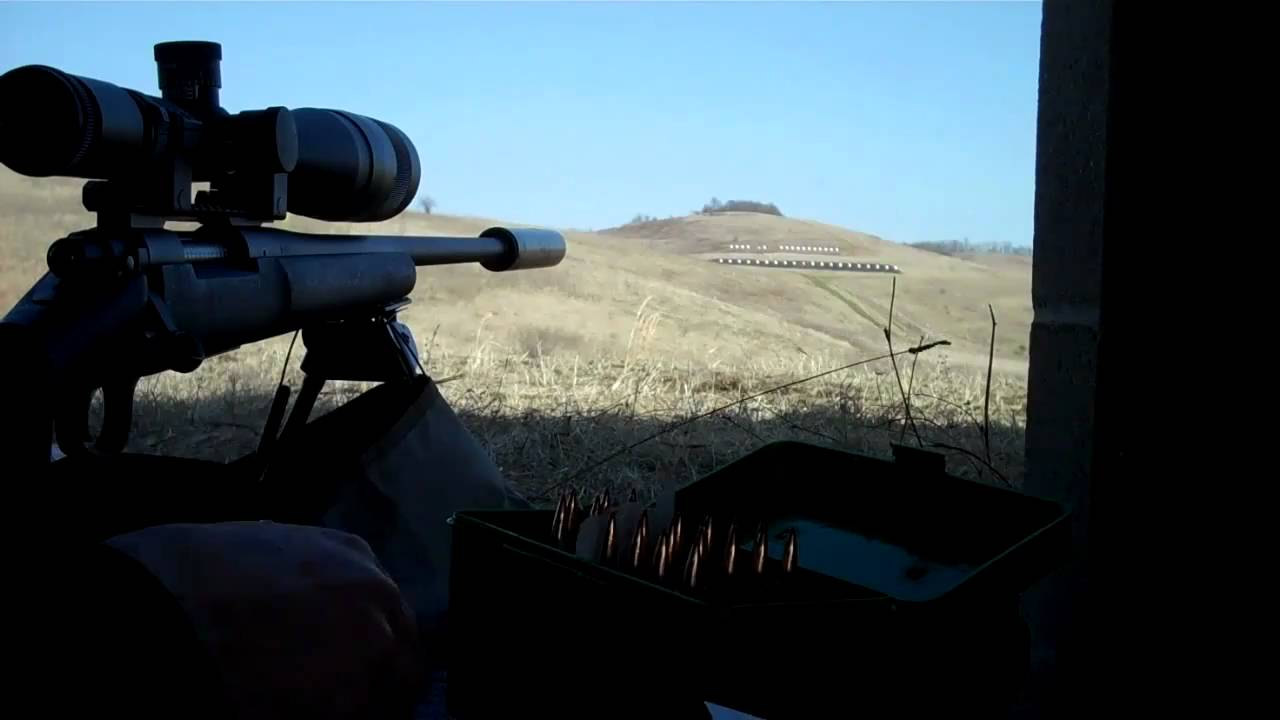

    1000 Yards
    Data from the Kestrel...
    My pre arrival estimates....
    Down Range....

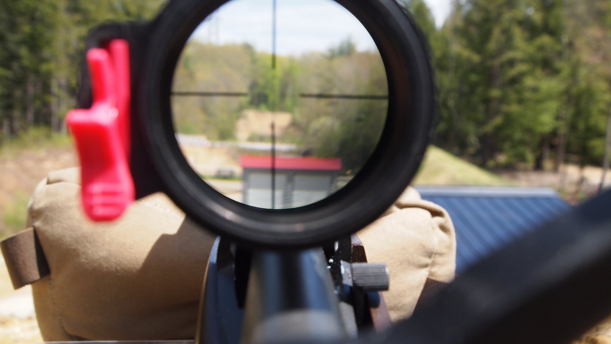

    The scope view at 4.5X...Camera focus sucked
    My doubling reference mark...
    Banging the 4x4 Gong was pretty easy. The Kestrel/ConX linkup gave pretty good info
    I made hits on the torso, hit a sub MOA balloon. Most of the shots would cause you to ruin your shorts more than send you to the hospital but big respect for guys that carried these in combat. Its a good rifle for what they had to do and I had the crutch of having a mil reticle.

    Would you do it again? The 9 power sfp?
    I learned a lot today that would likely improve hit probability next time.
    At 750 and 1000 The top of the duplex was my hold. It covered alot of the target.
    If I wanted to really succeed Id be better zeroing at 5 mils under and keeping 9X as long as I can or learning the magnification points that put the center cross on target at certain ranges - like a BDC reticle of sorts.
    Im going to return my zero back to the center croos but its good to know that if needed I can drop mag down and get 10 mils out of my reticle.

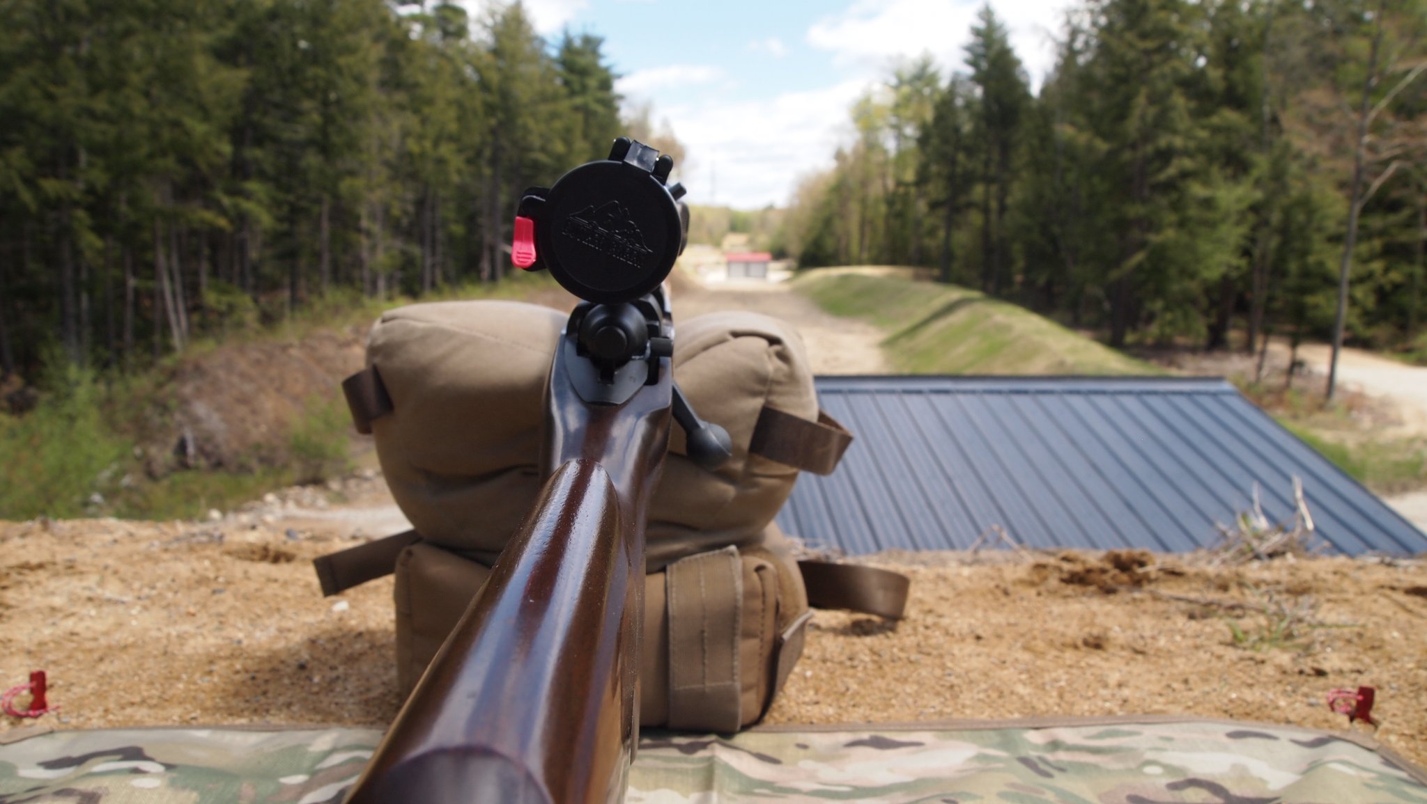

    I do have a pre 64 Model 70 with external mount Unertl that would be fun to try. 30-06, metal butt plate, straight fine cross hairs. I think I checked the numbers and there is just enough adjustment with my scope blocks to get me there.

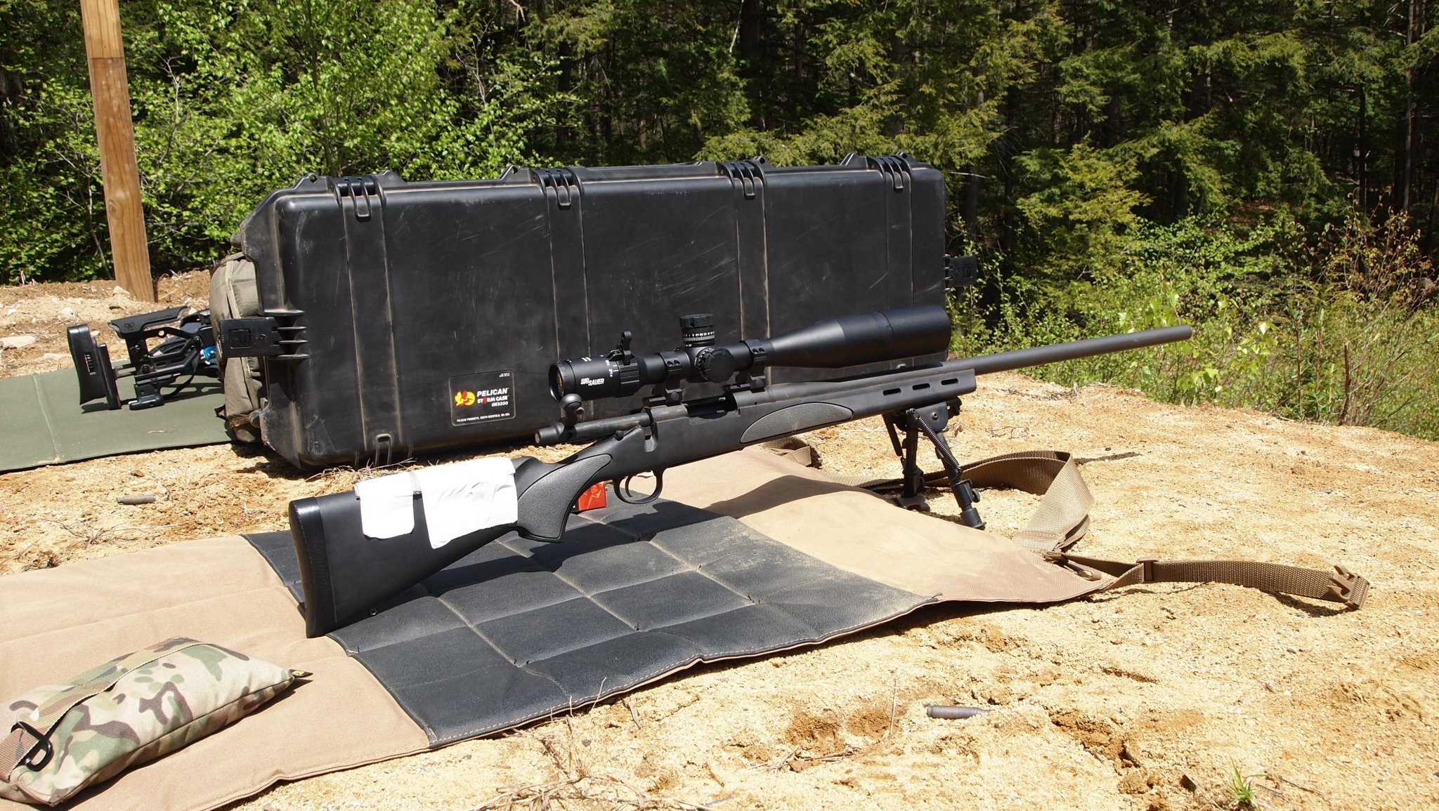

    Forgot to post a picture of this guy....
    This shooter came up for a full week PSR 101, PSR 102, PSR 103
    He bought the .308 Varmint R700 BDL, prepping for the class. It was the only thing available in the Covid 19 world.
    He bought a Sig Scope at the Academy. The first one failed the day before his PSR103 class. That scope was fresh mounted yesterday morning and zeroed.
    He was shooting 168 grain FGMM.
    He was crushing steel at 1000 and popping balloons.
    So to all that say R700s cant do it, your primary extraction wont allow you to extract spent brass, the plastic stock will flex, their barrels are shit, 168 SMKs drop from the heavans at 800 yards..........I saw none of that to be true yesterday.
    Sure there may be better but you can get it done on budget gear.
