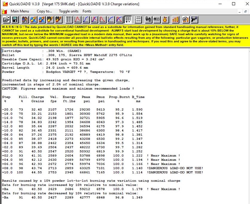

I haven't use Varget in a long time since now my go to powder is AR-Comp for my .308. But when I used Varget, the load that was most consistent for me to push the 175 SMK's was 40.5 grs with a COAL of 2.894 in Federal brass with Fed-210 primers. Out of my 24" barrel I was getting MV's at ~2550 fps.
PS: if you get a chance, you really should try the new 169 SMK's as I find they perform quite a bit better than the 175's.
Additional info of interest:

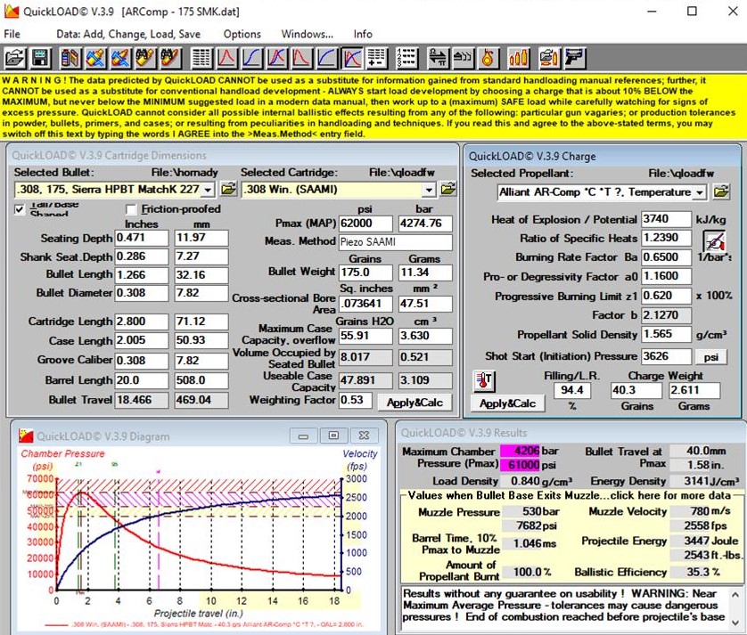

I use 41.6 grains of ar comp in Norma brass with a br-2 primer for the 168 and 40.3 for the 175. Velocities are 2670 and 2550 respectively. All out of a factory 20 inch barrel.

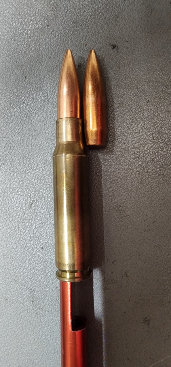

This is pushed all the way to the lands with a 175gr SMK. The base of the boattail is just about half way up the neck. I like pushing my bullets out as much as the next guy, but that is just too much. I just don't feel the bullet has enough hold on the neck to load it this long. I measured before with the 168gr ELD and it was worse than this. I have another 308 barrel for my AW and it's about the same when I measured it out too.
Looks like your AR-Comp is performing similarly and well like mine:
Hmmmm??? Well, if one is loading to touch or jam the lands, seating with this amount of bearing surface being held is not a problem, and. . .it helps to have enough neck tension to hold the bullet in place.
I've VERY often loaded my cartridges with this amount of bearing surface being held (and I think sometimes a little less) being .010 - .020 off the lands with 175 SMK and others and not had any problems. Your discomfort for doing so, doesn't mean that it's something that can't or shouldn't be done. :rolleyes:
