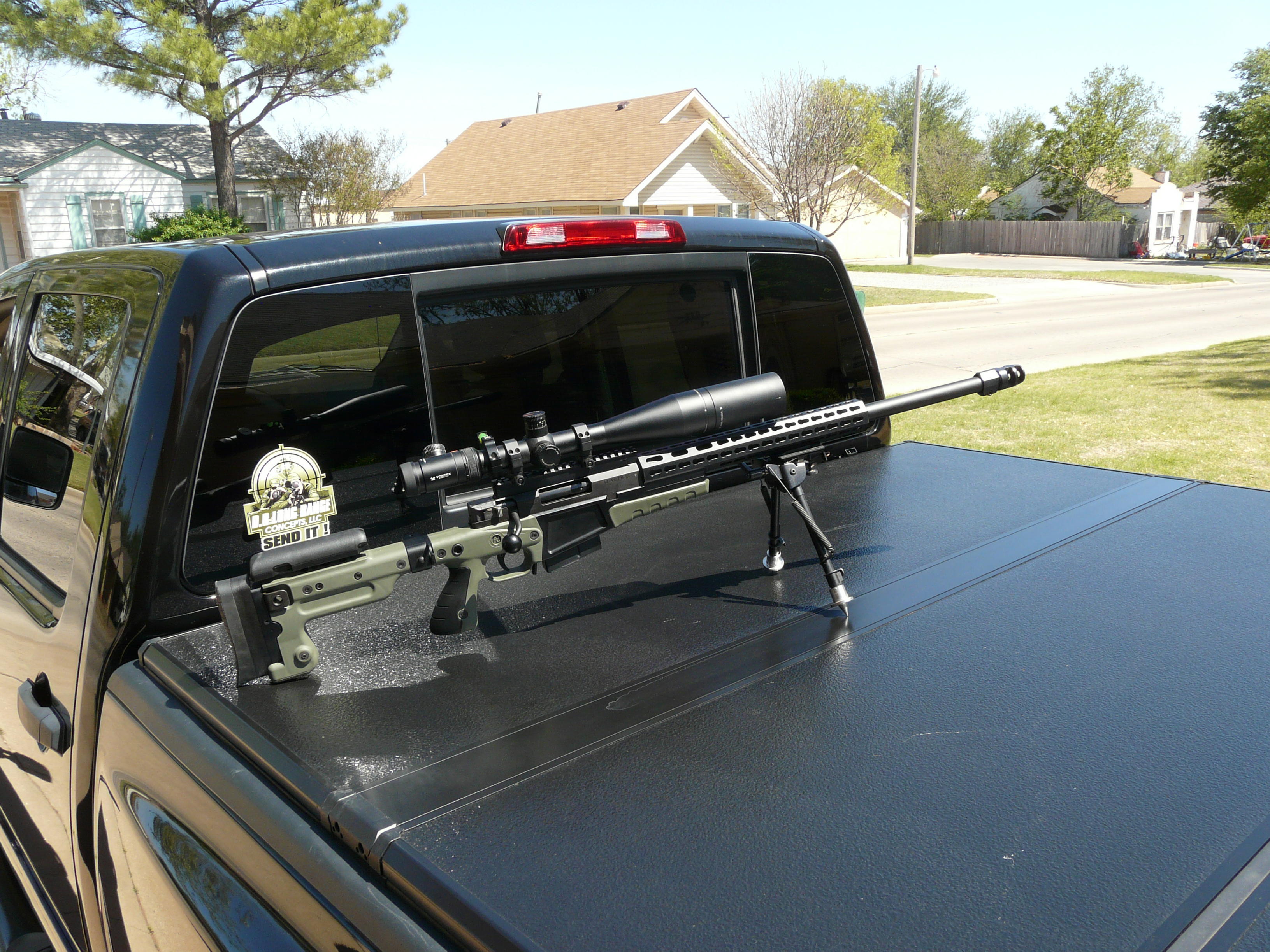

The AIs are definately an addiction. I am a recent convert myself. Got this beauty of a 260 from Mile High 2 weeks ago. I am now officially ruined for anything else!
