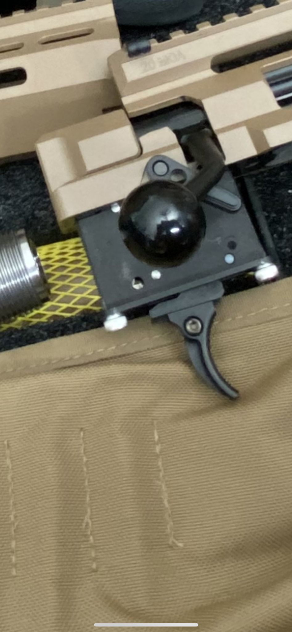

Dawg, let me put it to you this way. I took out to the ASR trigger to swap it with an OEM, and it didn't work. The ASR has a longer housing. Its also using a roll pin to hold it in place, along with the standard 2 screws.
Reactions: M8541Reaper
Too lazy to take the action apart. But you can see the difference in this pic
Ahhhh ok. Good lookin out man, thanks.
So the AX (same as AT/ AMXC etc) AW and AT-X (comp trigger), the trigger housings wouldn’t let the screw to line up properly with the threads on the ASR.
Also, without it being screwed on (obviously) The bolt wouldn’t even close with any of those triggers, yet it still did with the ASR trigger.
