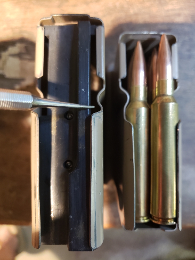

The issue with the older mags is the shoulder fold stop location..
I have found 300prc will actually run flawlessly out of the 338 lm mag if you bend the feedlips inward a tad...
The shoulder stop folds in the 300 wm mag are more forward than the 338 lm folds ironically.

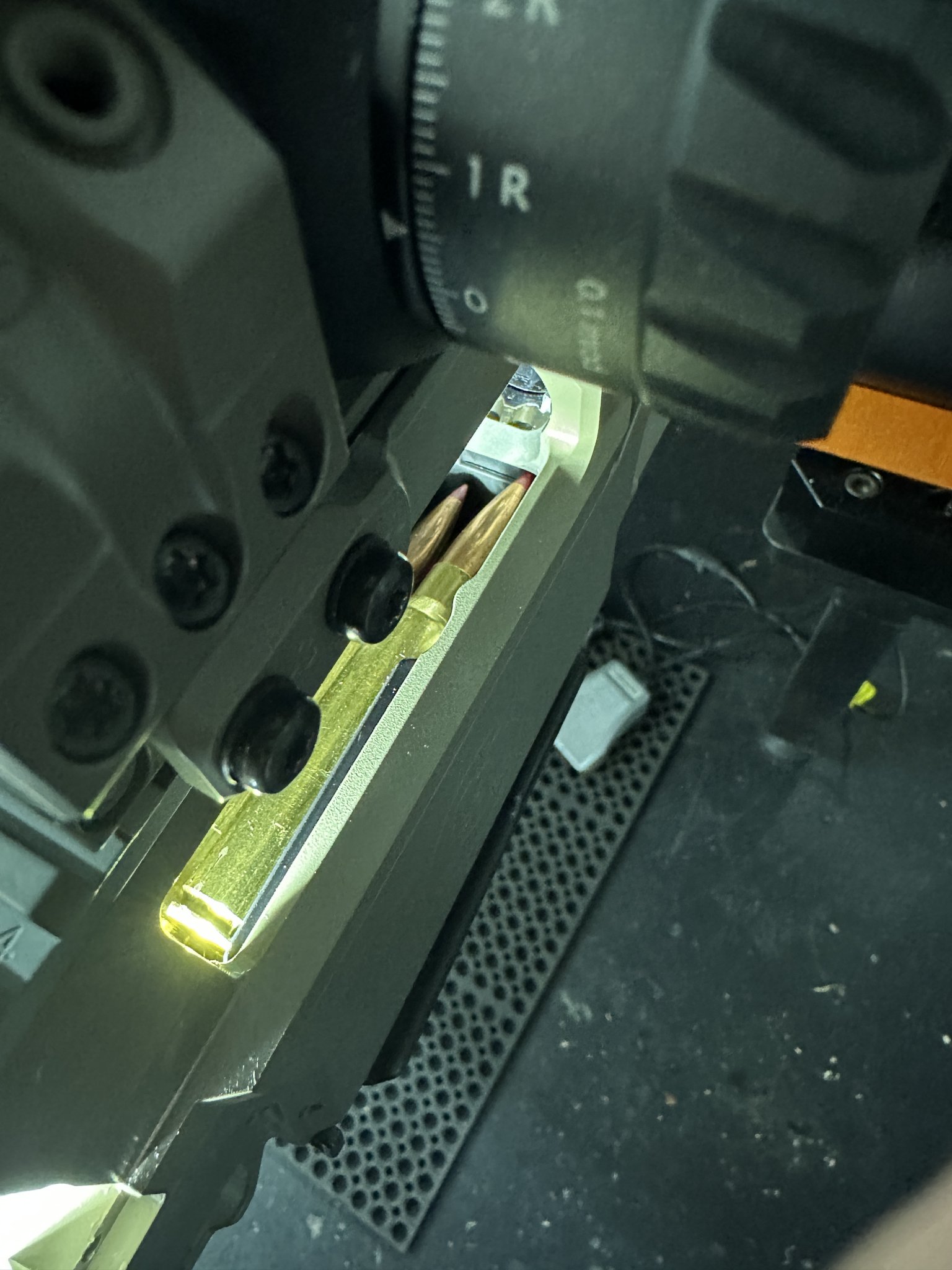

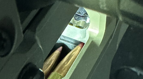

Here’s an image of the condition with the mag inside the rifle. It’s curious from the design that the barrel extension is behind the feed ramp on the chassis. It would make more sense if this were in front, similar to an AR.
I would contact ai with that photo and see if they will swap it out for the newer style

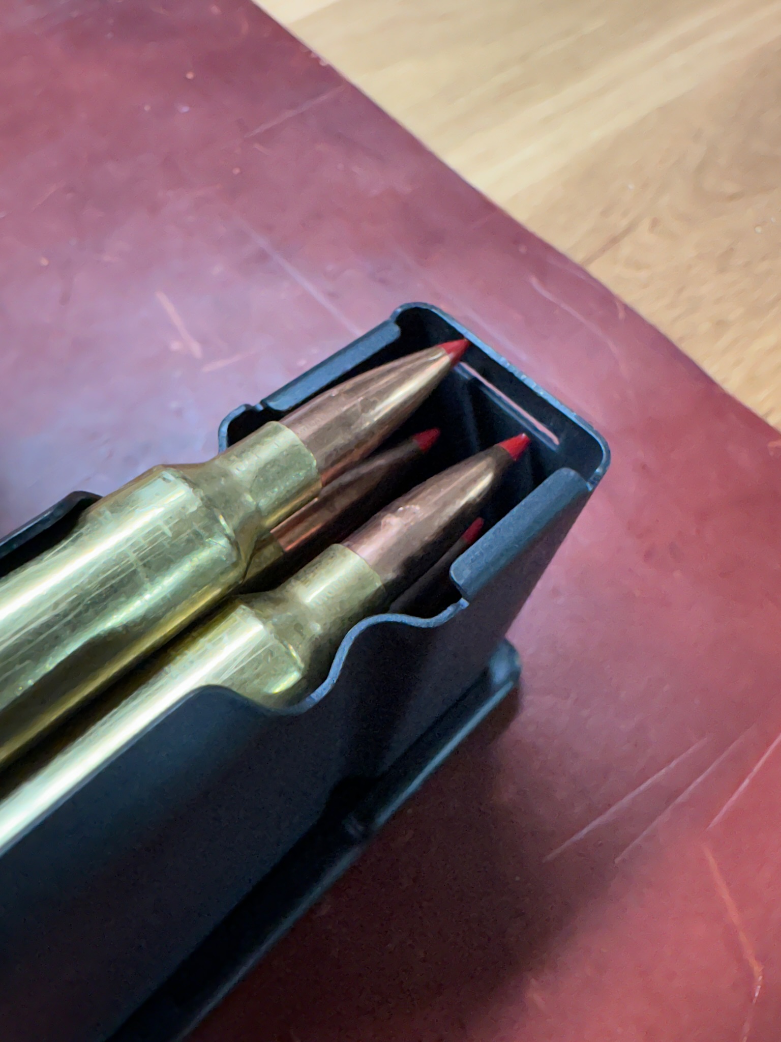

Update……..I emailed Tim at AI on 3/15 and have not received a response. I had a chance today to look more closely at the issue. Huskydriver is correct in that the magazine shoulder folds are causing the issue. The height of the round stack is not the issue as the first few rounds will feed normally and when the stack is square. The problem is the round stack tilts forward during the feeding cycle and does not recover to the relaxed position once the round has been fed into the chamber.
You can push down on the rear of the stack to correct the issue but it repeats on the next or after round.
It seems to be a combination of interference with these folds and a bad design of the spring and follower (for 300 PRC). The follower could definitely use more even spring pressure at the front, but that may not be necessary with .300 Win Mag rounds.
I agree completely at this point that using a .338 Lapua mag with closer feed lips would be a better solution that bending and hacking at my customer’s $160 magazine.
