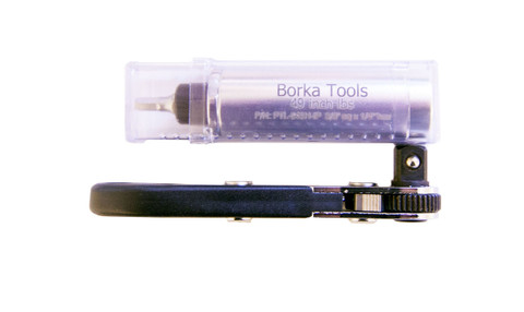

    @Badfinger no, just hand tight. I screw it until it hits the face of the action, back it off a little, then jerk it tight again and keep torquing for a second. I’ve been using 55 in-lb on the quickloc lately instead of 49 in-lb, but other than that nothing special.

    I have a fix it stick 49 in/lb limiter and I just hit it with that.
