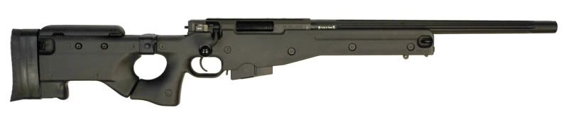

    Also keep in mind that the two rifles pictured above differ in rail mounts. One has an 11mm AI dovetail and the other a Pic rail. The Pic rail adds about $250 if you want one.
    I'd recommend the dovetail.
    Re: AI AW 308 in 20" or 26" barrel
    The pics are just visual aids,lol.Yes one has to campare rifle to rifle,plus options. the 26" also has a brake which ads to the price,flutes on the 20" too.
    Money isnt a factor,im only concerned about velocitiem out the factory 20" barrel. I absolutely love the heavy short fluted look.
