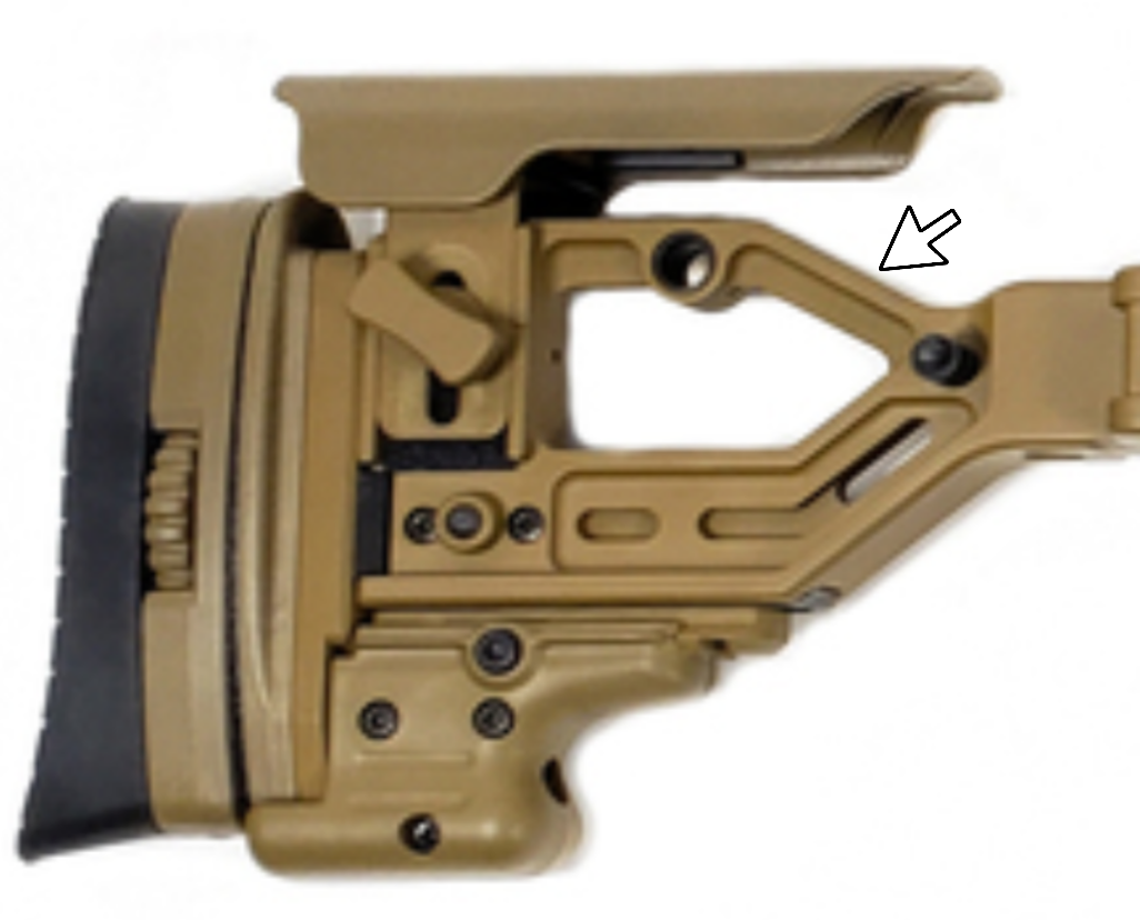

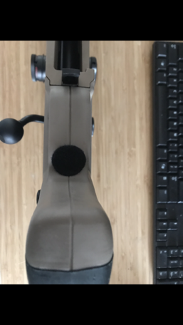

I found that damn hole in the grip panel bottom was the worst thing for my comfort. Couldnt get on it right without my knuckle falling into it.
a piece of stick Velcro helped a LOT.

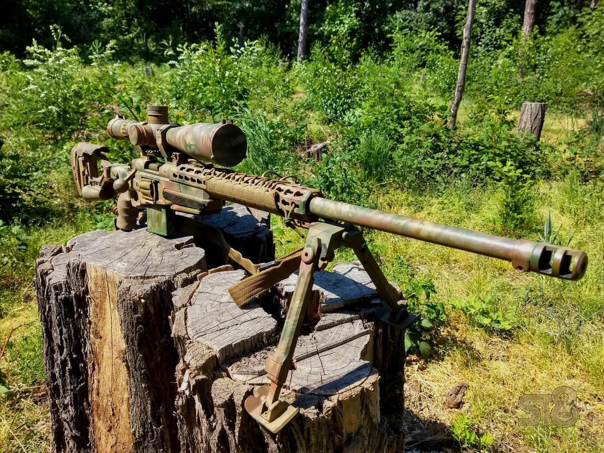

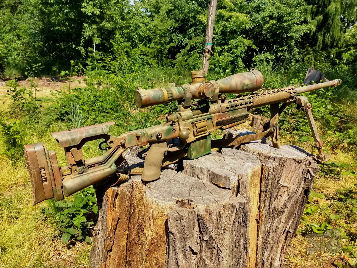

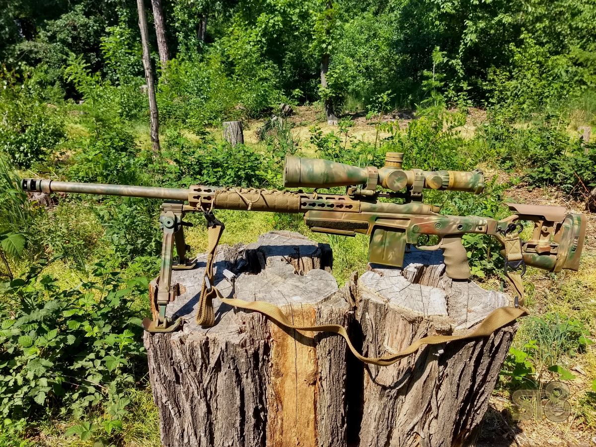

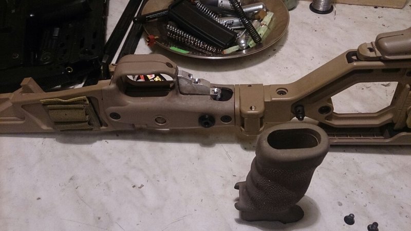

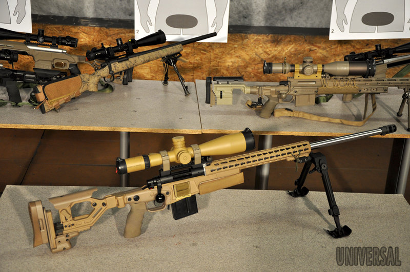

I did posted some pictures in the AI pictures thread... Basically - I was not able to get use to the original grip. Maybe because I have Suregrips on other rifles... But after 6 months of suffering I had to change the grip. Now I am comfortable with it...

Well... I do not care about latest or the most expensive things or about the look of it. I used AX AICS because at the time it was the best chassis which gave me the features I wanted... Quality, folding stock over the bolt handle etc. But during time I found out that not everything is ergonomic on this chassis for me. And the grip was the worst part...
OK - when it does not work for me as I want - it is time to change it. Why should I adapt to the rifle? The rifle should adapt to me ;) So I did made the changes on the chassis. The same with the bag rider and bipod mount. The rifle as it is on the pictures was quite good for my shooting for one great season. It served me sooo well.
But my priorities changed over time and I do not have it anymore. I still have the action but that is all. The only other piece I am still using is the muzzle break on my training 223. The action with new barrel is serving me as hunting / backup match rifle with cheap chassis and cheap scope. My primary rifle for long range and tactical matches is very different but is using the same grip by the way... Because the grip fits me and still is the most ergonomic one for me (y)

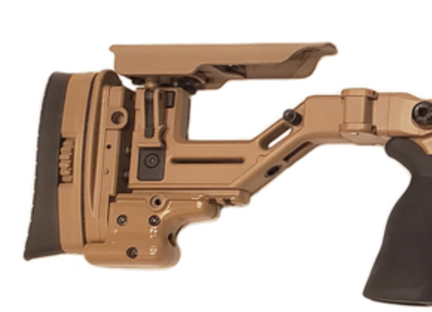

I have developed a Pistol grip conversion for the AI rifles, AT, AX and AXMC.
The conversion does not alter the chassis in any way and allows the fitment of AR flat top pistol grips.
The kit comes with new AI stock sides and a complete new trigger guard.

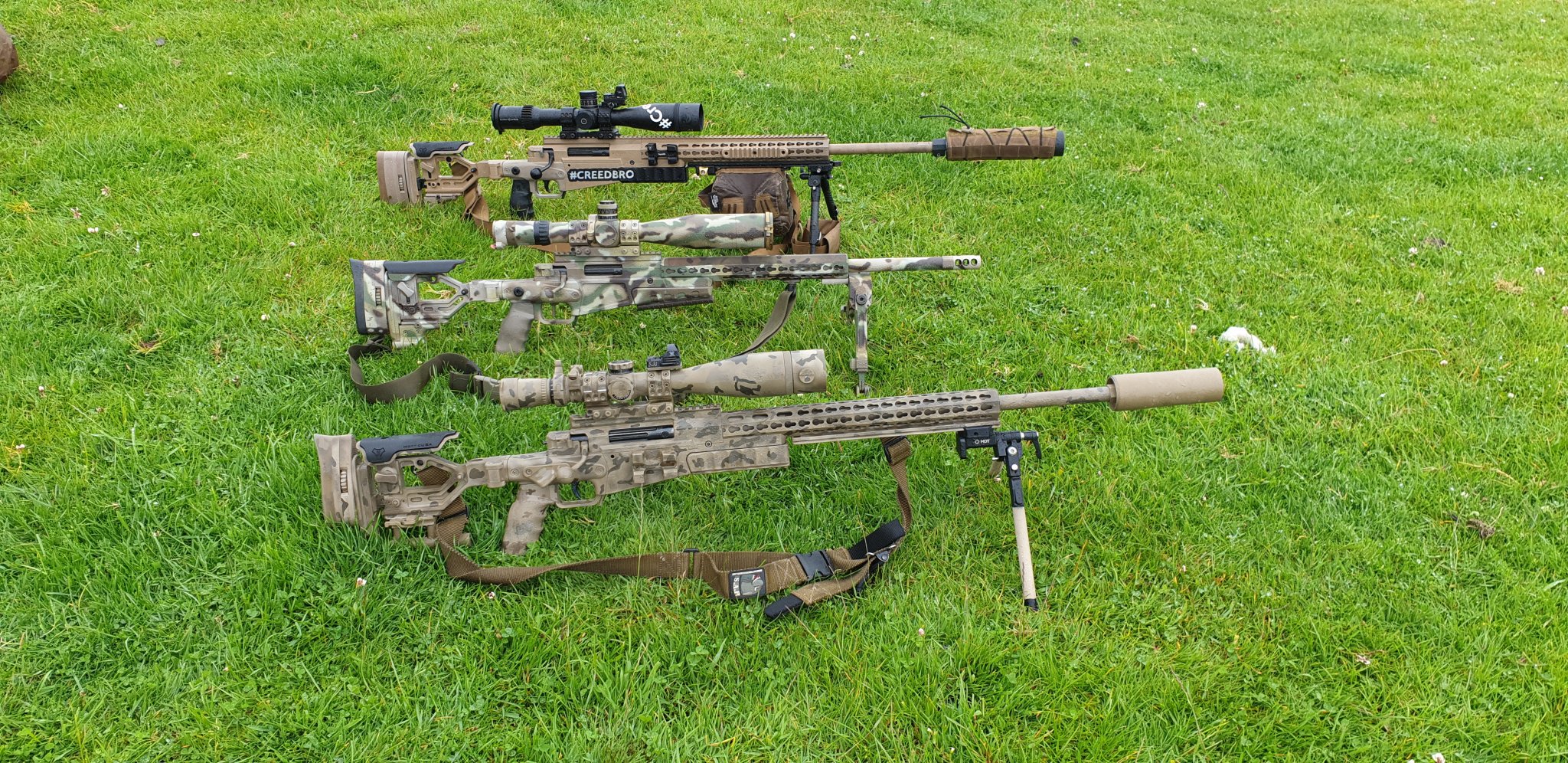

A picture below of the grip conversion on 2 AXMCs and an AX.
For more information look here

The grip is solid, the new trigger guard is manufactured from Aluminum which bolts to the chassis and the pistol grip mounts to this. The replacement stock sides are standard items reworked to allow fitment with the new trigger guard, unlike the originals they do not support the pistol grip. This also allows the rifle to change back to the original pistol grip if required.
