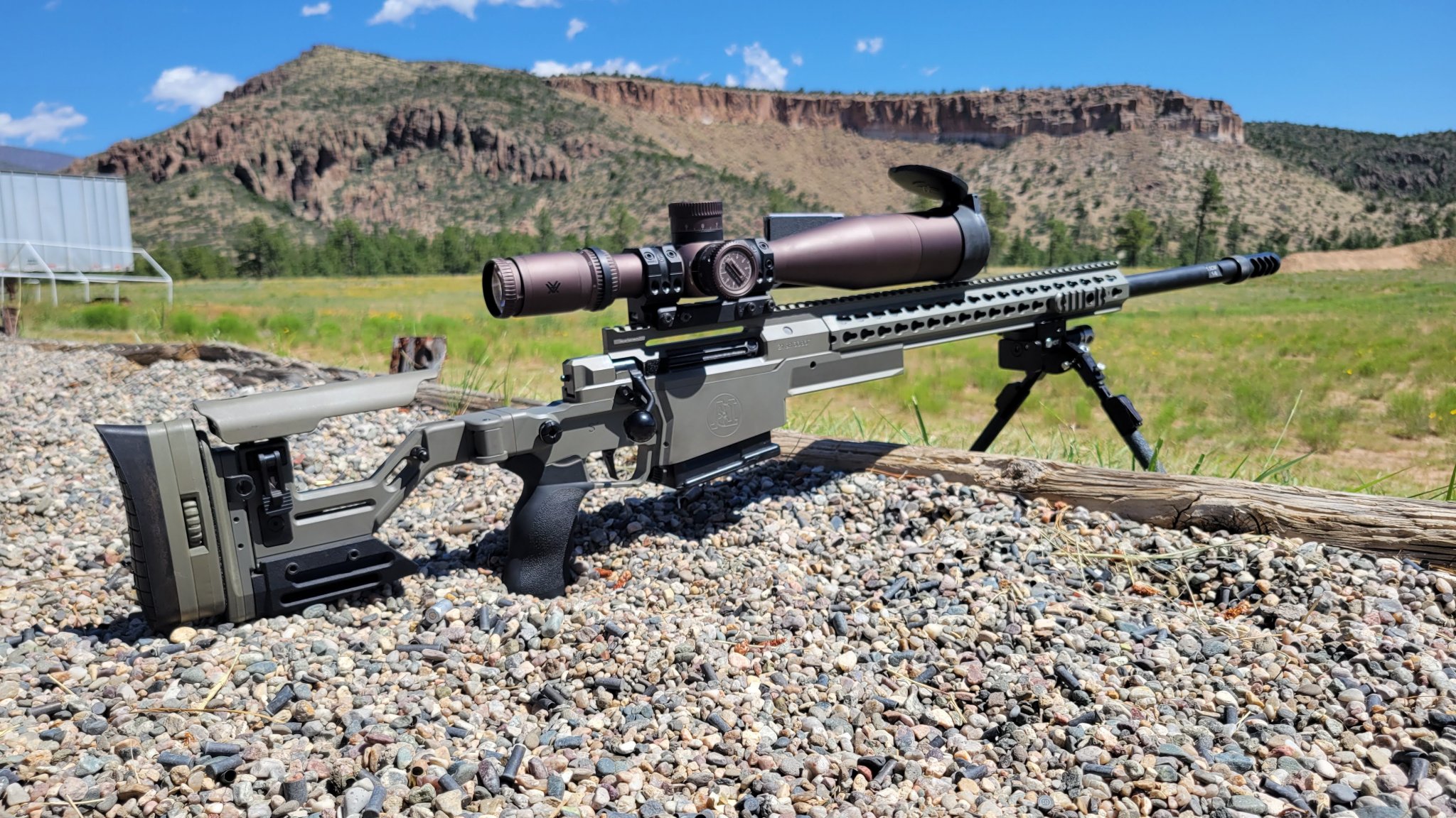

I have a one AX Mark3, and I am located in Canada.
Mark 3 was available for only 2 years(20/21) if my memory serves me correctly. Then AI decided to discontinued it. I had been trying to order another one from my local dealer, but never got any lucks.
Hopefully they will bring it back on 24.

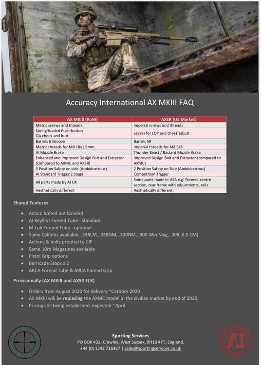

At first glance it looks almost identical to an AXSR, but then you notice the cheek rest and butt pad adjustment mechanism is different between the AXSR and the AX Mk3 (clamp bar on AXSR vs what appears to be pushbutton with a notched riser on the AX Mk3), the stocks are machined and styled a bit differently, etc.
Found this explaining the differences...
I know some AXSR buyers here in the US might appreciate the normal old very reliable AI trigger and 3 position safety that the AX Mk3 received...
That's a good comparison. I prefer the 2 position safety, it's easier to use and has the best 2 out of 3 settings.

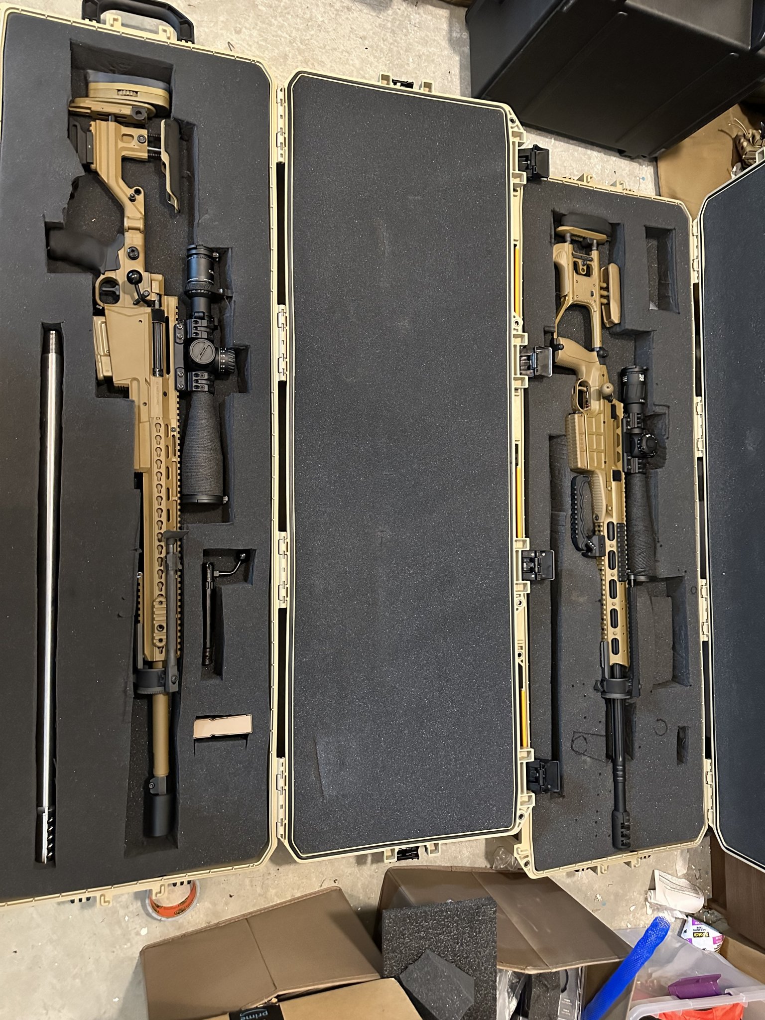

I will probably buy my AXSR this summer or sooner. I have an AT and AXMC now both in left hand. I have the following barrels for each
AT - 308, 6.5 Creedmoor
AXMC - 308, 6.5 Creedmoor, 338 LM
When I get the AXSR, I will add 6.5 PRC to the list. I have always wanted that caliber but since I am LH, I can't get the correct bolt for the AXMC. I have already purchased all of the bolt bodies for the AXSR before they are no longer available.

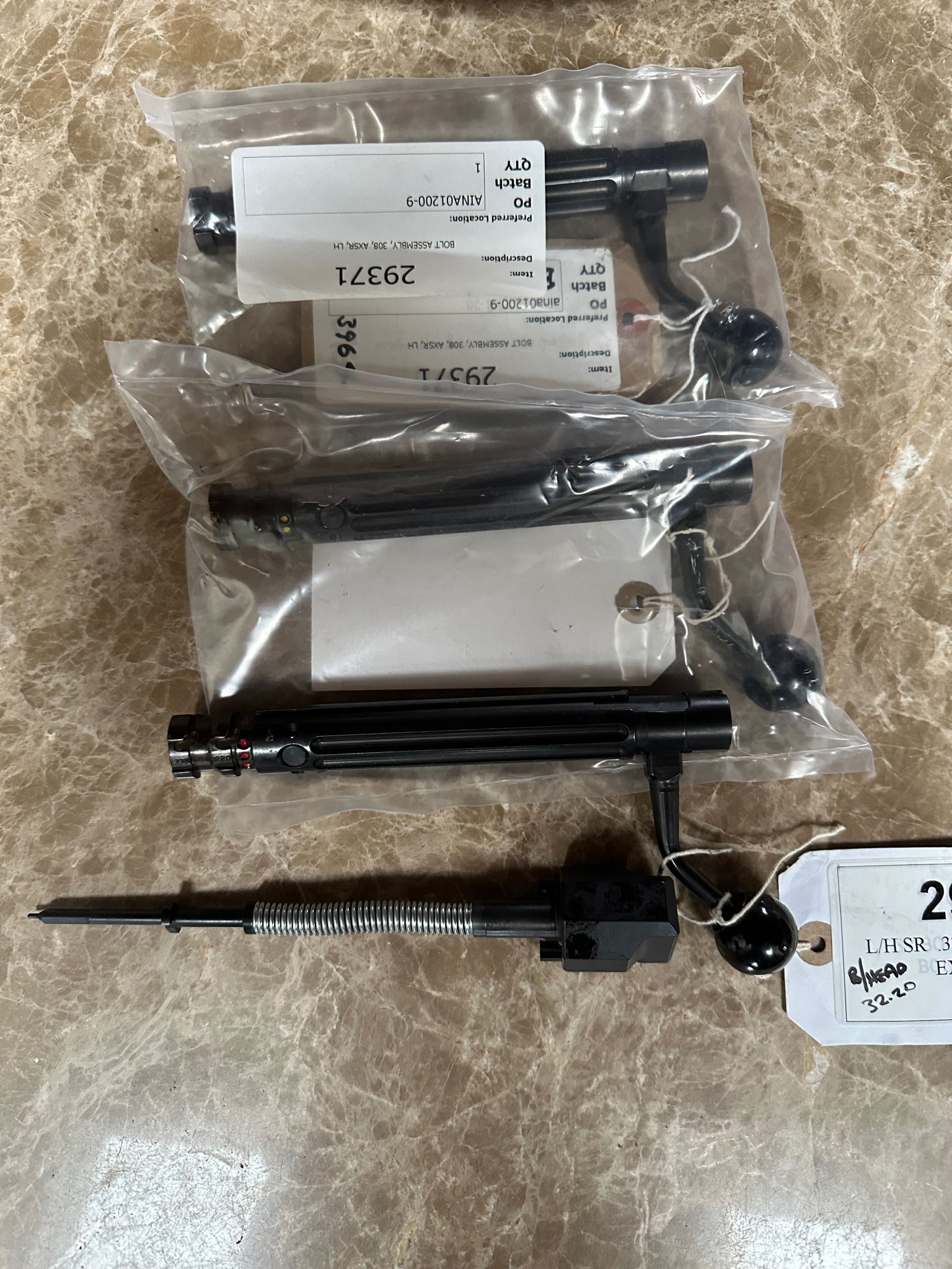

I have an LH 308 bolt and they produced left handed rifles in 300WM
I wrote that to them, bur they asked me if that is a AXMC bolt. I will wait for their answer when it comes to the 300 WM. Sent them a screenshot of a store selling it in LH 300 WM and have it in stock now. But I guess it might be only sold with the rifles, and that they do not make spare ones
Would not surprise me
