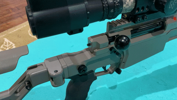

Recently I found my AXSR would not hold the firing pin when I closed the bolt. I fixed similar issue by adjusting the sear engagement for my other rifles before. But I cannot find any instructions/manuals for adjusting the AXSR trigger. Sent an email to Mile High but got no responses. Anyone had experience for adjusting an AXSR trigger?
I may be remembering incorrectly, isn’t it same (or at least similar) to the comp trigger?
Should be the general instructions online.
It's the sear, I've had this happen to me with the short action Comp Trigger. 1/4 turn was all it took, but there was a step-by-step procedure to adjust it.
Like literally and 1/8 to a 1/4 turn prolly is all that is needed. Should be the same as tube comp trigger instructions

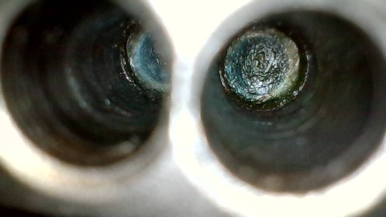

Got the instruction and it turned out to be the two screws underneath. But the hex screws seem to be sealed by some hard material (wax? epoxy?) and my 0.050" hex key cannot poke through. Anyone saw the same thing before??
Call Mile high. If it’s like the older model triggers they can reset it for you without the rifle.
