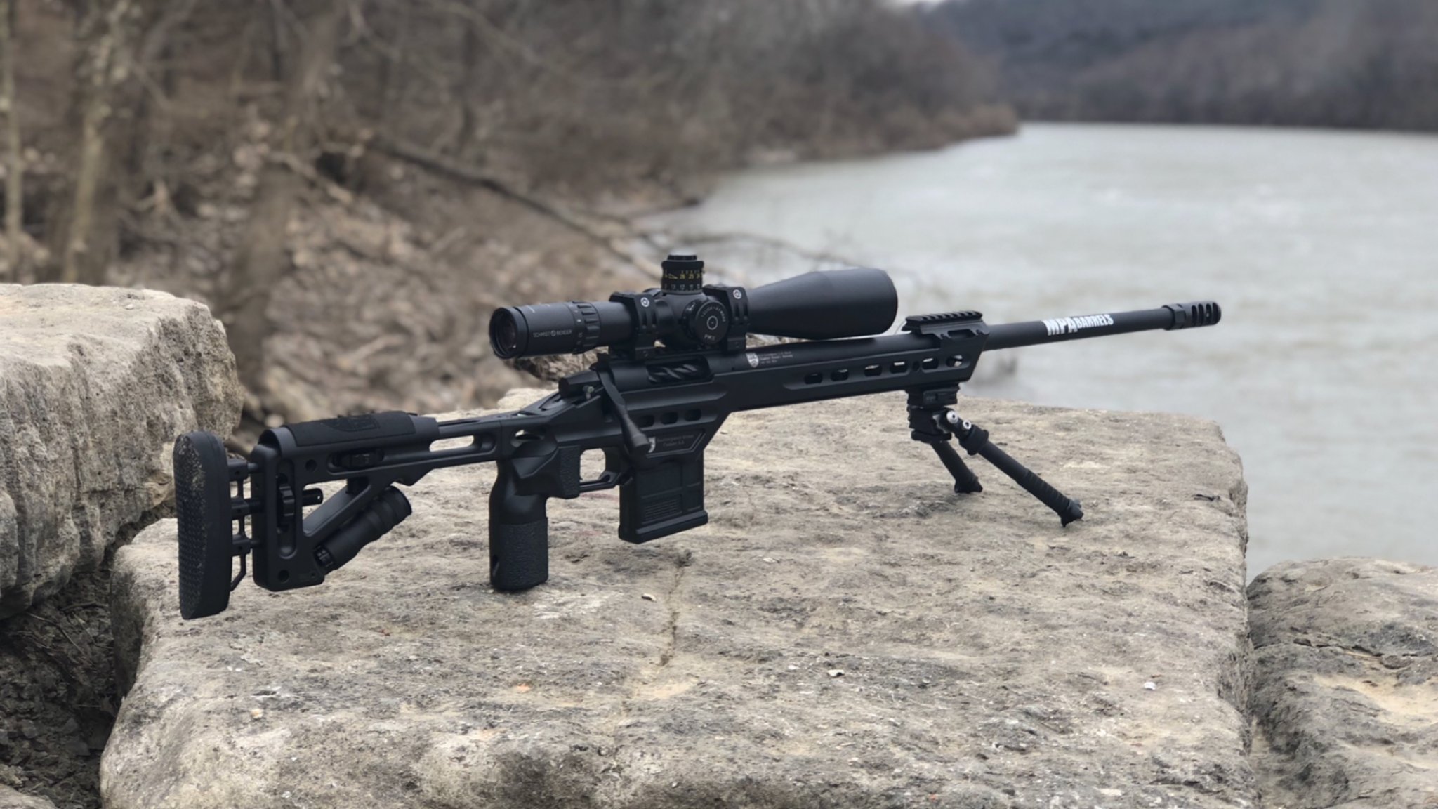

Just got my New AI mag (first one I’ve owned) in the mail today and Im not exactly happy with how it functions in my rifle (MPA 6.5 creedmoor). The amount of force it takes to work the bolt on the first few rounds makes me feel like I’m damaging my rifle. I spent over double the money on the AI compared to the Magpul and the Magpul seems to function much better. Am I the only who had experienced this? Is there anything I can do to make the AI mag feed smoother?

Same experience here. I had to do a lot of fine grit sanding down the feed lips. After an hour of fiddling and sanding they now run excellent. If you can get by with the lesser OAL of the magpul run them and don't look back. The added oal of the accurate mags and ai mags were a must for me as I was running VLD out pretty long.
Sounds like your mag latch is a tad too long. AI mags are the gold standard with a standard .308 based round. If it isn't working, I'd highly doubt it is the mag. Magpul mags are an economy mag. They work...most of the time. But I've seen a whole lot of them have issues in matches, especially when people are working bolts under stress. I very rarely see an issue with AI mags.
It sounds more like the fit between the mag and your gun....these mags are the smoothest and easiest to load and shoot that I've ever experienced ( in an AI) in fact many times I check to see if a round actually loaded.

Same problem here too. I also run an MPA chassis / 6.5CM. The AI mags didn't seem to present the round high enough to chamber smoothly. Forcing the bolt only drove the tip of the bullet into the feed ramp. We sanded and bent the feed lips. Tried the Magpuls...smooth loading. They function great at half the cost.

Once you sanded and bent feed lips did the mag function like they’re intended?
To those that had issues, what actions are you running in the MPA chassis? Just curious as I'm looking at them for my next build. Thanks
I had this same issue when I purchased my MPA chassis. The mag catch was too long. A few thousand's filed off the catch fixed the problem.

You set your rifle up for the mags you want to run. Mags should feed smooth, drop free, and not be able to be pushed high enough to inhibit bolt operation. Generally, this is something your gunsmith will take into account and it is usually wise to continue using the mags they have built your gun to operate with best.
If you want to change things up to a different brand of magazine, you will need to go through this process yourself, or go back to your gunsmith and have him/her do the work.

Hey, I have the same issue with my MPA build, stiller tac 30... Accurate mags, when I go to chamber a round, there is a lot of resistance that seems to be coming from the feed lips, and I kind of end up pushing the rifle off target to chamber a round. So you shaved a few thousandths off the top of the mag catch/release thats inside the chassis and that cured it? Would that make the magazine sit a few thou lower?
When I bench it and single feed by hand, the rounds glide right into battery with ease.

Sounds like the interface between the MPA chassis and AI mags are the common theme. If your Magpul mags run better, run 'em. I run AI mags in AI's, and they're like butter.
I had to open up the feed lips at the front, and sand them a bit. They work really well now.

Sometimes those feed lips can get damaged in shipping. What'll happen is the feed lips deform slightly which usually causes the round to be held lower in the mag; making it harder for your bolt to strip the round clear. When I switched bullet weights in my 6.5CM, the rounds would take a nose dive upon leaving the magazine, causing feeding issues. MPA makes a feed lip adjustment tool to tune your mags to your rifle and round. I adjusted feed lips and they started feeding fine. As others have said, they are the gold standard for DBMs in bolt guns.

It was a the mag not the rifle

I make up several dummy rounds- bullet and brass to length, but no primer or powder.
I coat these rounds with a black sharpie and insert them into the mag.
I cycle the rounds into the chamber, eject and look for scratches in the shell.
I then adjust or sand the feed lips as needed to minimize the drag and scraping.

My issue has cleared itself up, as my mags broke in from use, and are now running nice and smooth.
