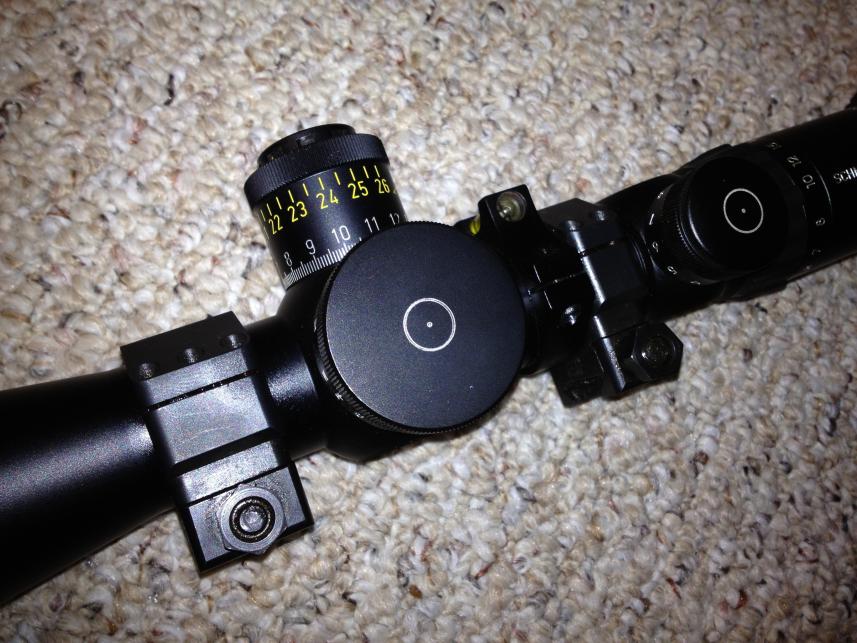

I don't have it in my possession but here is a pic.
Jerry, in my experience, the only AI mount that works without modification is the 45moa. The 28 and 18 moa require a little clearancing to clear the turret housing of the 5-25. This was with older 5-25s, not the newer one you referenced.
Thanks Eric, I didn't see any specs on which base he was referring to.
