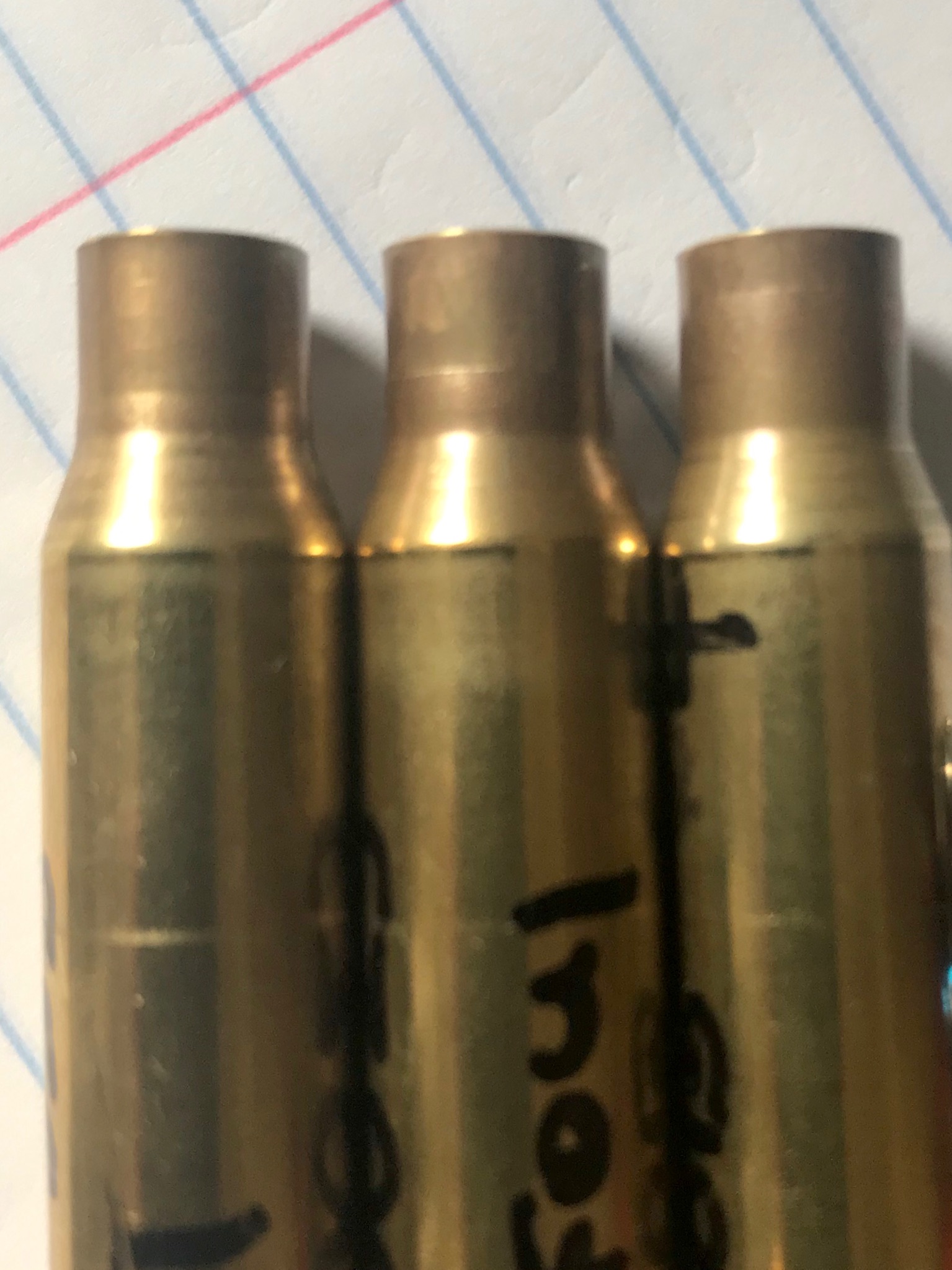

Rookie question... 1x fired Lapua brass (308) BartleiN/TAC stock barrel. Using a Co-ax press and a Redding FL S die its the button removed and a 0.335 bushing... I’m chasing my target 0.0015 should bump. Brass on the right is with the die screwed down and backed of an 1/8th - neck “sees” the full bushing constriction - bump is 0.0035; middle brass is with the die backed out (0.0025 bump); and brass on the right is where I am today (100 pieces prepped)... die is backed out to achieve 0.0015 bump, and a seating pressure of 30... yet the bushing constriction is only 2mm.

Looking at you cases something is not correct. For instance the 2 cases on the right, no bushing die will bump the shoulder with the bushing that high on the neck.
Is the bushing all the way in? There is something wrong with your die adjustment.

The center/right the die is not all the way in… I’ve had to back it out to reduce the bump adjustment. This is creating the problem that the bushing die doesn’t have enough connection with the neck.
Screwed down, the die provides .0035 adjustment… So I can live with .0035, or I can get a different die... For those shooting the OEM barrel from AI it would be curious to see how they’re getting a .002 bump?

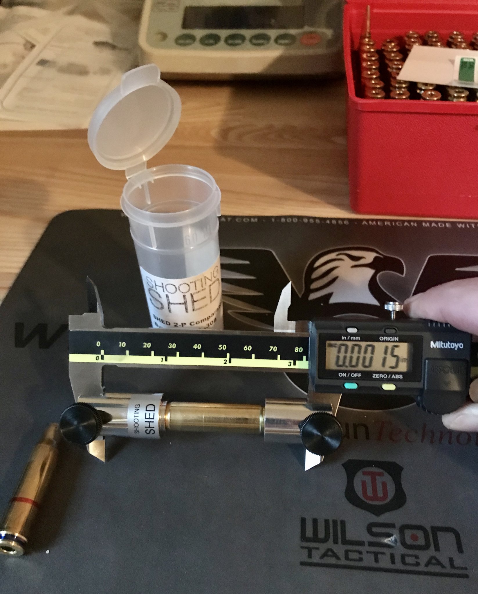

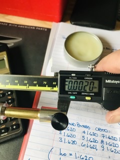

As far as equipment... I’m using the bump gauge from the Shooting Shed and a Mituroyo caliper. Thanks!

They’re never gonna reach all the way to the shoulder anyway but usually they get closer than your pics.

I measured 10 pieces (deprimred) CB to shoulder with the bump gauge = 1.620
Resized in a Redding 77355 308 Win Small Base die... the dimension got “larger” at 1.623 (2 pieces)... confusing... I was expecting to push the shoulders “back” (I.e. 1.618) but the longer dimension after sizing suggests I’ve bumped “out” the shoulders and the gauge is riding higher).
