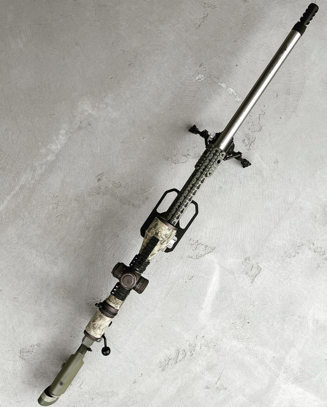

So im thinking about having a 6.5 barrel spun for PRS style matches but im not sure how large of a shank will the AXSA i have will take. Just want to confirm its good for 1.250" under the rail.
The standard barrel is 29.4mm at the action (well my Lothar Walther is), so I imagine you will be fine.
I've had a couple barrels spun up for my AT rifle. I went with a 1.200" shank to better match the original barrel on the rifle. Like the M24 contour.
I think you would be fine but what muzzle attachment/supressor do you rock and what length you thinking?
On this im thinking 26" I have a few short sticks already and im going for speed on this one.
I think you would be good to go then. Only concerns I would have had was diameter of the muzzle attachment fitting to the barrel and having enough clearance to account for barrel whip not touching the end of the hadguard
Finishing a MTU/Heavy Var at 26" too thick for 5/8-24 threads on the 419 breck you think?
For an AX/ AT/ AW/ AWM = 1.250"
For an AXMC/ PSR/ ASR/ AXSR = 1.350"
Yes, I run 1.250" straight on my AX and AW.
And 1.350" straight for the big bro's

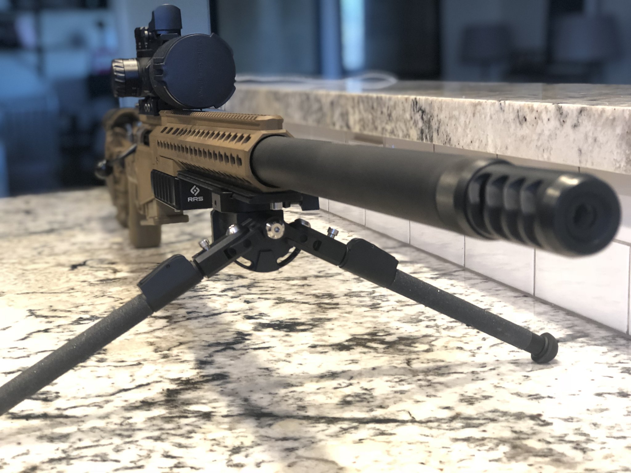

I just place a order for a straight contour barrel today and realized I might be screwed when it comes to a muzzle break fitting flush with the barrel. Any breaks out there that won’t look like shit? It’s 1.250
Use a suppressor you uncivilized barbarian....
@Mr. F has one that fits flush with his
The Sidewinder will probably look pretty good on it. It’s larger than the hellfire so it should go nicely with a thicc sticc

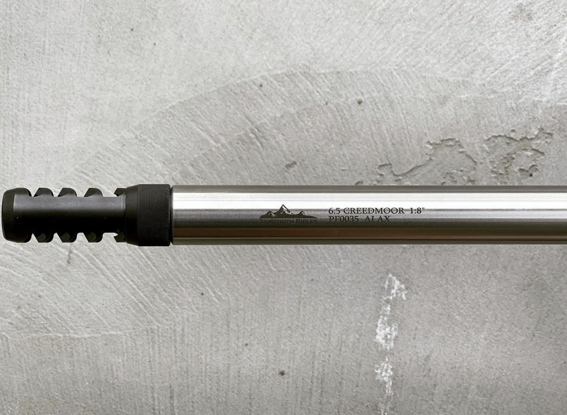

Yea that Area419 break OD IS 1.275” hope I didn’t make a bad decision ordering this fat ass barrel
The area 419 collar and adapter are about 1.25ish.
They’d look fine on a 1.25 truck axle or coffee table glamour shots.
Then snag a hellfire at 1.1”

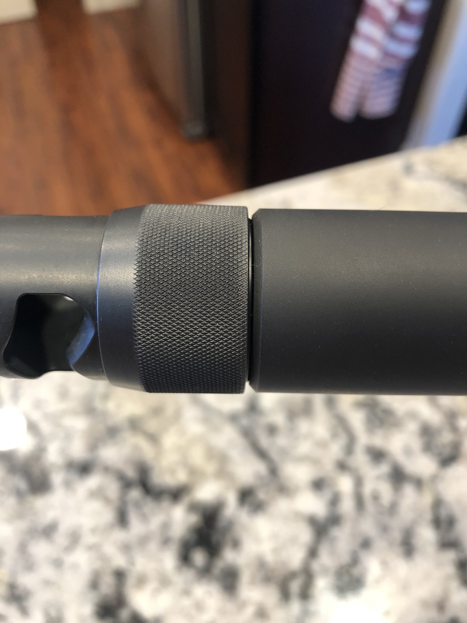

@Huxtable_hurt_me28 Thats a A419 Sidewinder on a straight 1.25
but as @NoLegs24 said ive seen hellfires and other .9” breaks on straight pipes too and honestly they look even better imo idk 😂😂

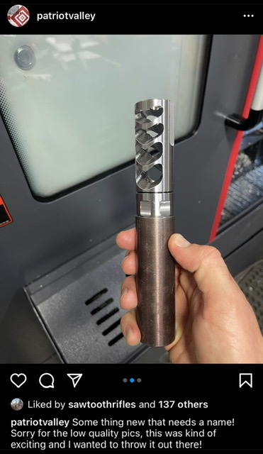

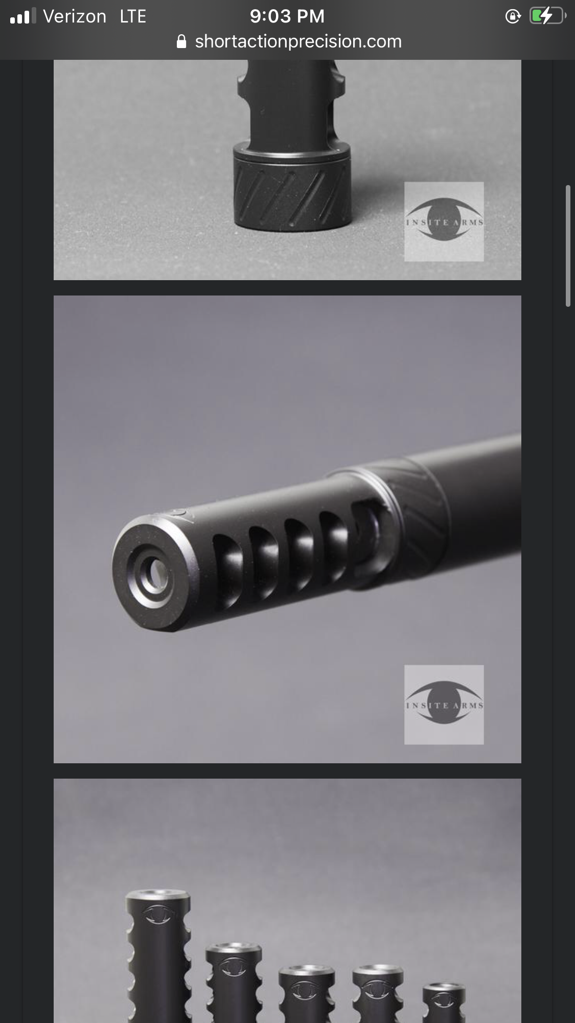

OP... Looks like PVA made this just for you. 1.25 OD brake about to be released.
Reactions: acudaowner

Terminator T4 Plus is 1.250
