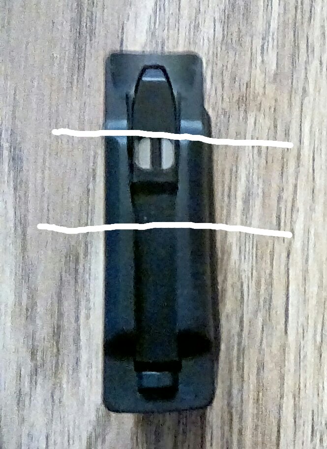

J jtv3062 Sergeant Full Member Minuteman Dec 28, 2004 291 9 53 prk Feb 27, 2018 #4 Feb 27, 2018 #4 I took a blade and shaved some of the plastic away from the feed lips from between the 2 white lines in the picture Attachments IMG_20180227_165212_hdr_kindlephoto-75704893.jpg 141.4 KB · Views: 64

F Fatjake Private Full Member Minuteman Jun 14, 2017 21 1 Missouri Feb 28, 2018 #9 Feb 28, 2018 #9 After reading the thread that was linkded on the post I was able to make the ruger magazine run flawless. Thanks guys
