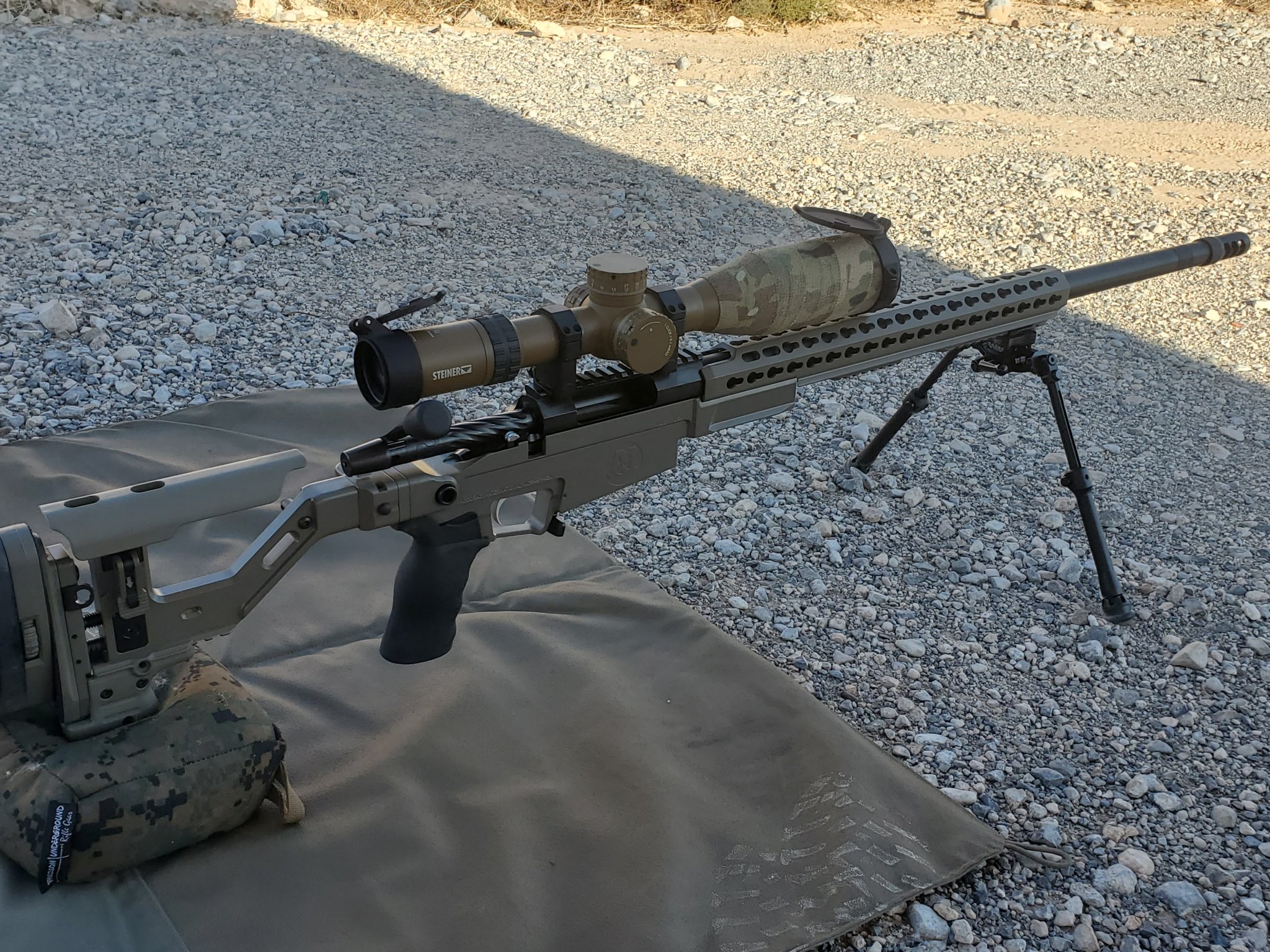

It's a well made chassis, the only other chassis I've had was the AX. This addresses all of the shortcomings that one had. I also have a couple McMillans.
It's got a full length rrs rail on the tubular forend, and another rrs rail just in front of the mag well. These sections of the chassis are pretty narrow, but you can buy wide plates from places like gray ops these days to steady your rifle better.
I can't say if the action sits any deeper than normal. It doesn't look like it.
The mag well has a built in stop to prevent over insertion of magazines. I remember the AX not having this feature.
The grip is comfortable, and the distance from the grip to trigger has been kept quite short. If you have small hands you will appreciate this.
The folding stock is nice, but I couldn't get it to close on a BAT TR bolt knob. I flipped the folding mechanism so now it folds on the left side of the rifle.
The quick adjustments for cheek height, etc, are also much improved over the AX. You no longer need an Allen key to secure your adjustments anymore. It's up you whether it's worth it or not.
I havent tried their comp rifle. The main advantage I see is being able to add weights to balance your rifle. Mine does balance nicely with a 26" MTU though. So I guess in my case, it wouldn't make a huge difference.

The cheek piece is pretty wide. I had to move mine all the way over to the right side to get more comfortable.
I could hear a ringing noise when when I shot with the AX chassis. I don't hear any ringing with this one, so maybe AI has done something to stop that from happening.
