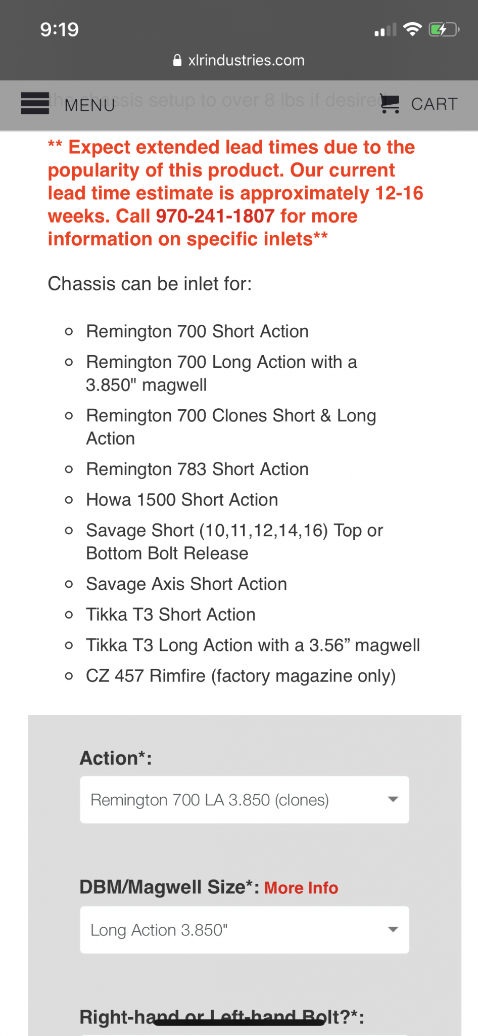

I ordered a Bergara LRP 2.0 in 300 win mag and it has an XLR Element 3.0 chassis. Comes with a 5 round aics mag but I am wanting a 10 round for it.
The mag I have found is AICS part # 4368. On XLR website it says the Element 3.0 chassis for Rem700 LA is inlet for a 3.850” magwell. Will the AICS # 4368 fit?
If not is there a 10 round mag that will?
The 3.850 is CIP length.
Most people run the Accurate or MDT mags which are 5 rounders and available in CIP length. The 10 round mags are massively long
I cant speak to the COAL available with these 10 rounders but theres a reason most people run 5s. And that's not just cost
Does a 10 round 300 win mag CIP mag exist? I’m having trouble finding any online. I see AI makes 338LM 10 round CIP mags, but not 300wm. If you know of any for 300wm could you post a link? Thanks
not sure if you can bend feed lips. i know some 300PRC guys shoot 338LM mags
