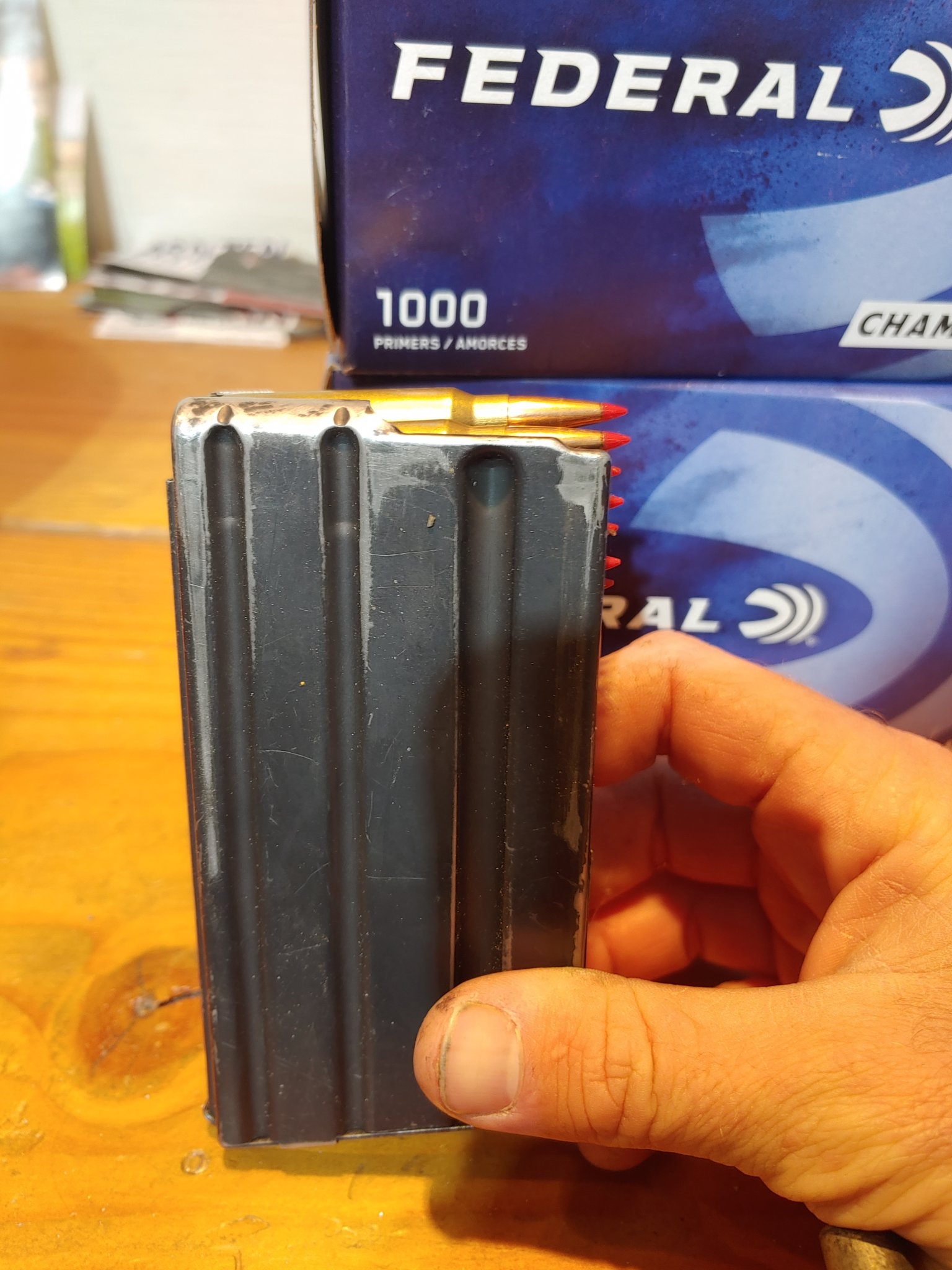

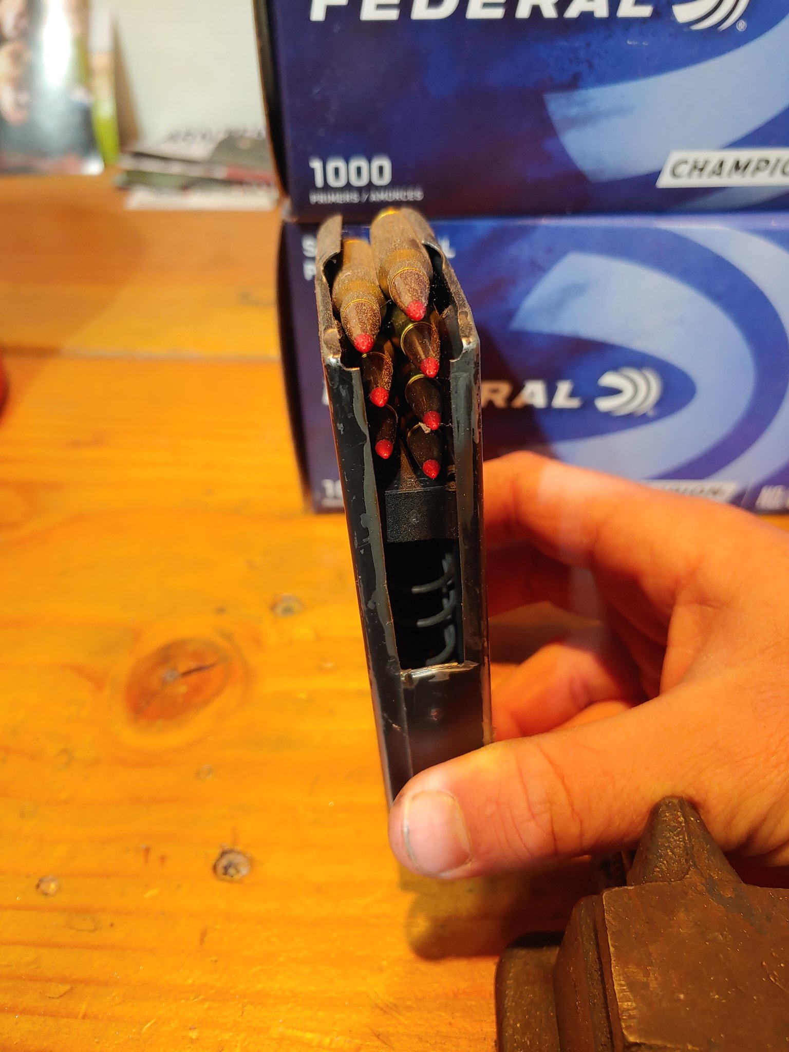

    Tell me more about cutting mags.
    Pretty much exactly what it sounds like.
    This combined with a relief cut in the magwell will get you to 2.41" ish. Those are 75ELD's at about 2900, a pretty big step up in performance from average mag length loads, but not big enough to re work the entire AR platform for.
    View attachment 7755231View attachment 7755232This combined with a relief cut in the magwell will get you to 2.41" ish. Those are 75ELD's at about 2900, a pretty big step up in performance from average mag length loads, but not big enough to re work the entire AR platform for.
    Holy shitballs, what’s all over that mag and rounds?
    I tried a cut mag in my 308 and the cartridges don’t feed for shit. Maybe I need to do more deburring, but a mag that fed fine before the cut (at 2.80 OAL) doesn’t feed at 2.88. Maybe I should do more investigation. There is a REAL difference in group size from 2.80 to 2.88 with this load…

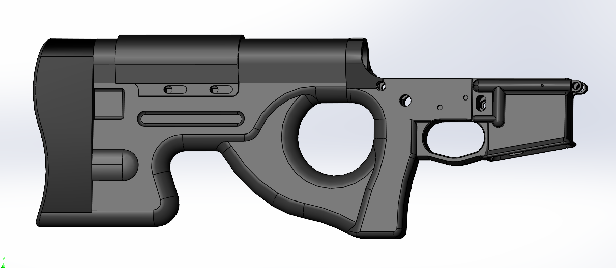

    I thought you might be talking about the stock portion which I played around with on the design side for a day. I thought about putting in another day on it and 3d printing it to play with but it's way down the priority list.
    Reactions: Snuby642
    That's innovation can you scrape up enough room for an aics mag without changing geometry for upper fit ?
