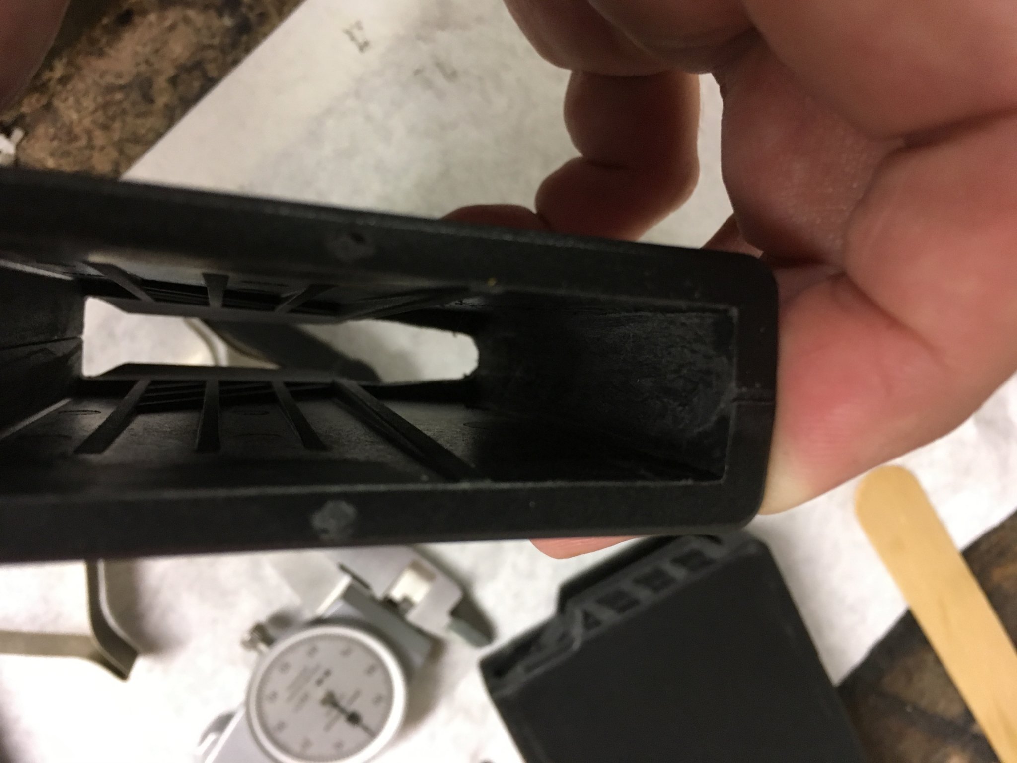

The accurate mags can be opened up as well, with a rat tailed file to get a longer COAL (works really well for the 75gr ELDM's). Just notch the front to allow the bullet tip to pass up through the plastic insert.

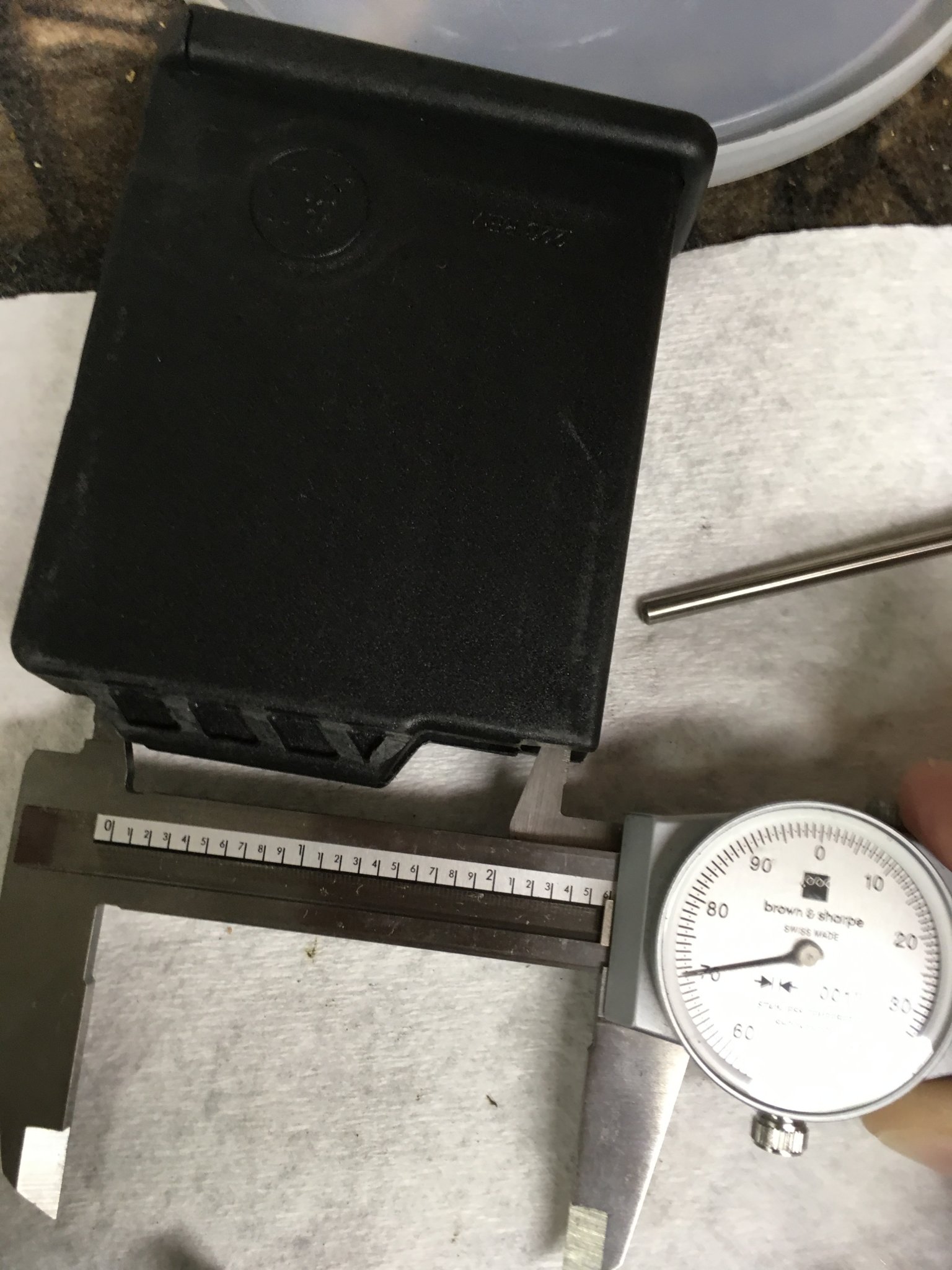

Sounds easy enough.. Do you know if the AICS Polymer mags can be modified if needed?
The measurement is of an un-modified aics magazine was. I went into a few with a pencil die grinder for clearance.
You’re welcome. The plastic cuts Pretty clean compared to a pmag. A lot of folks champher the feedlips for Tikkas.
